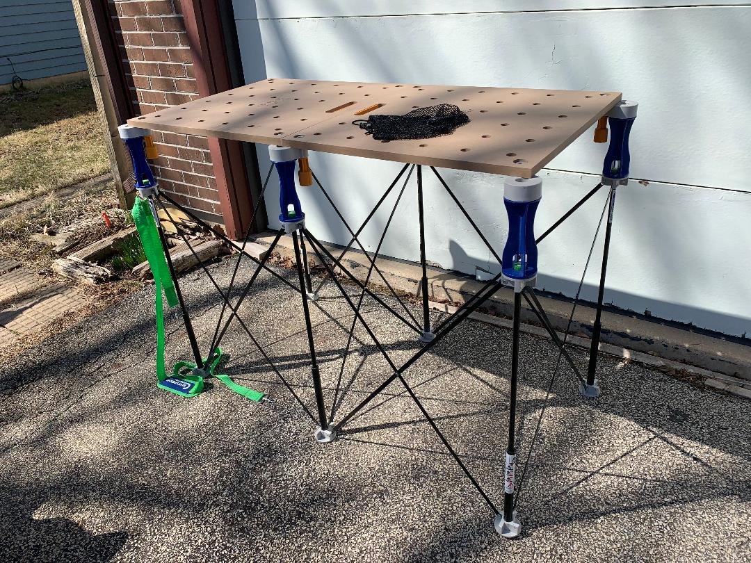

Got here a few days before expected! It is out of the box and ready to have me do some testing of the hole locations and to see how bad the hinge effects things. May have to wait for a few days as I have a stack of other things lined up to do before I can get to that.

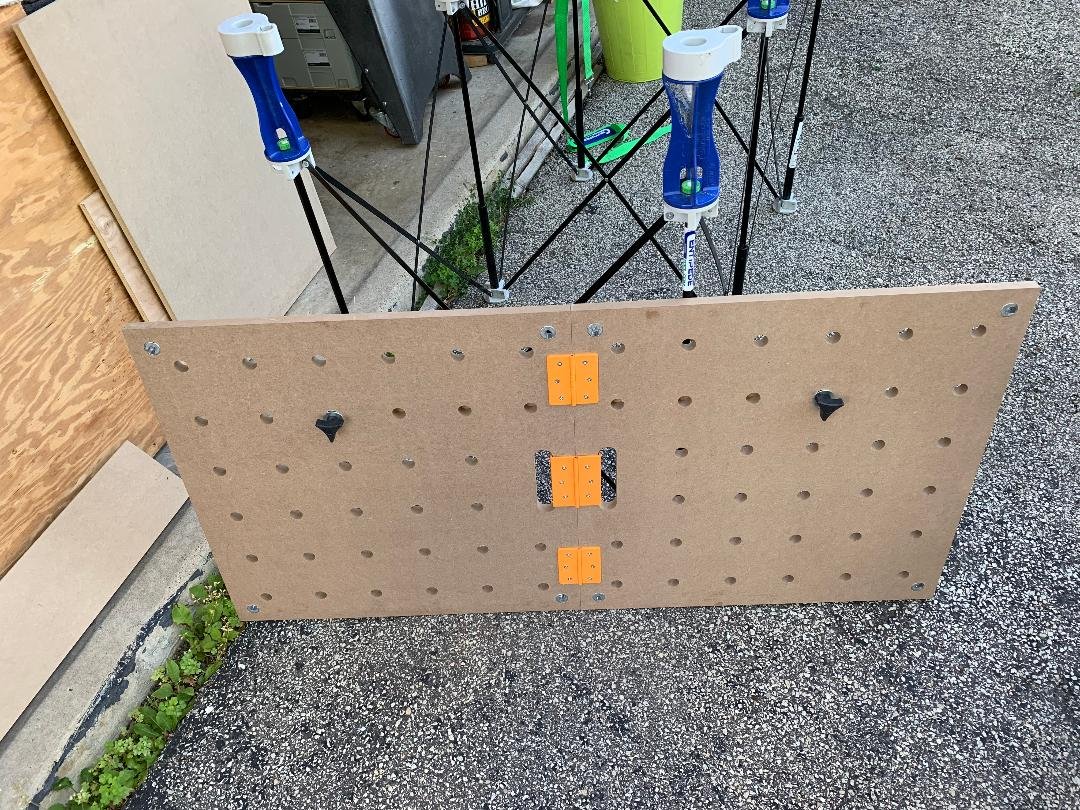

Had a few minutes to left today so started the preliminary testing of the top. The first think I noticed was that the 96mm pattern is not carried between tops. It is more like 150mm hole to hole across the hinge. It is pretty easy to see. This might or might not be an issue depending on how you might have hoped to use this.
I checked all the holes to make sure the dogs went in and felt reasonable, and they did.

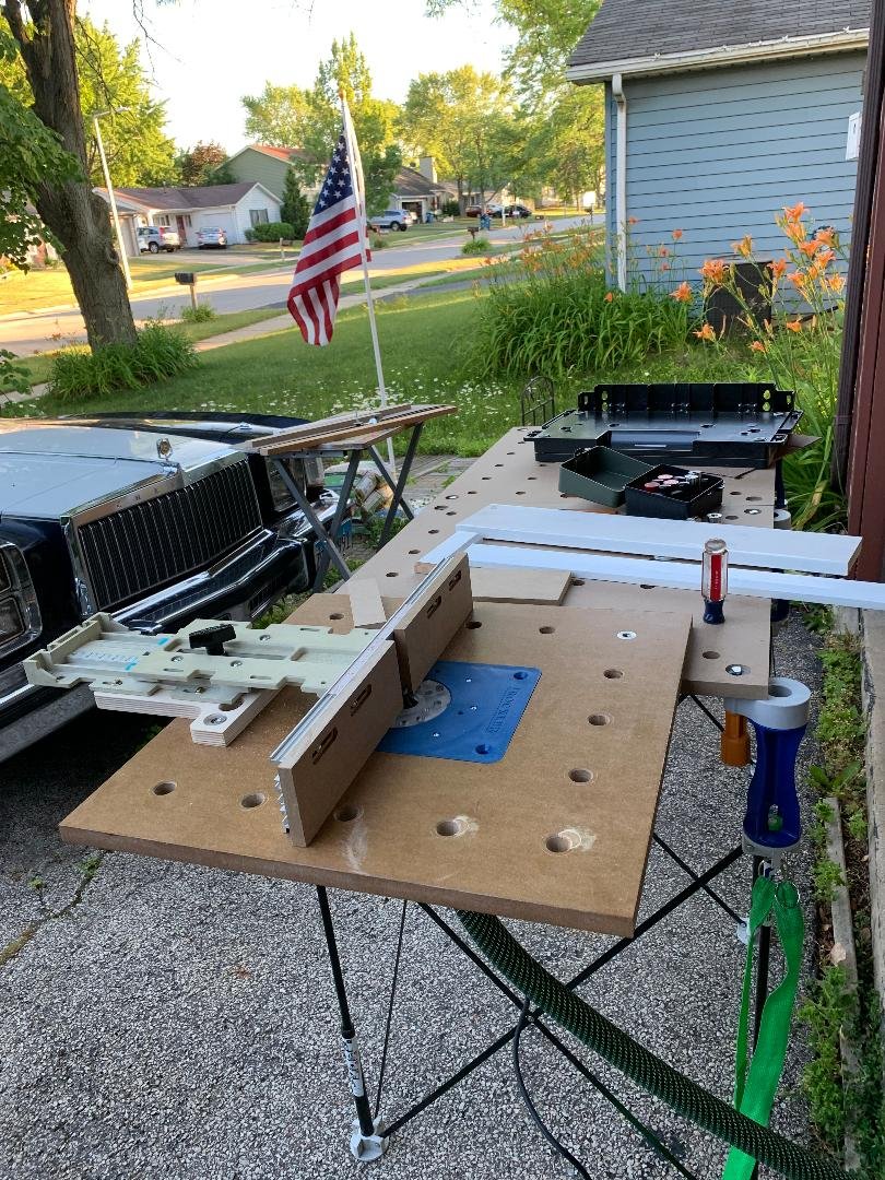

Used the table for the first time today. And managed to put my own personal touch to it. Was thinking I was routing 3/4" material but it was 1/2".... oh well now it broken in and it only maybe an inch long scar proves ownership and use.
Here is a shot of it set up:

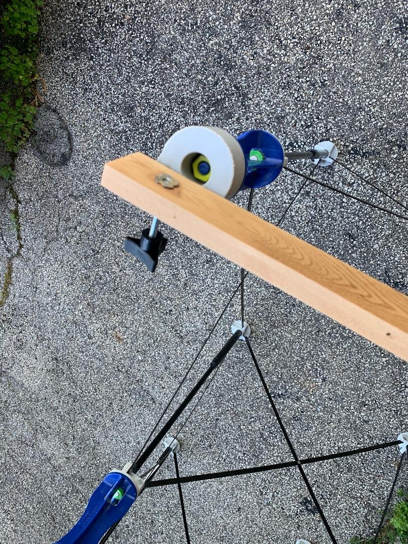

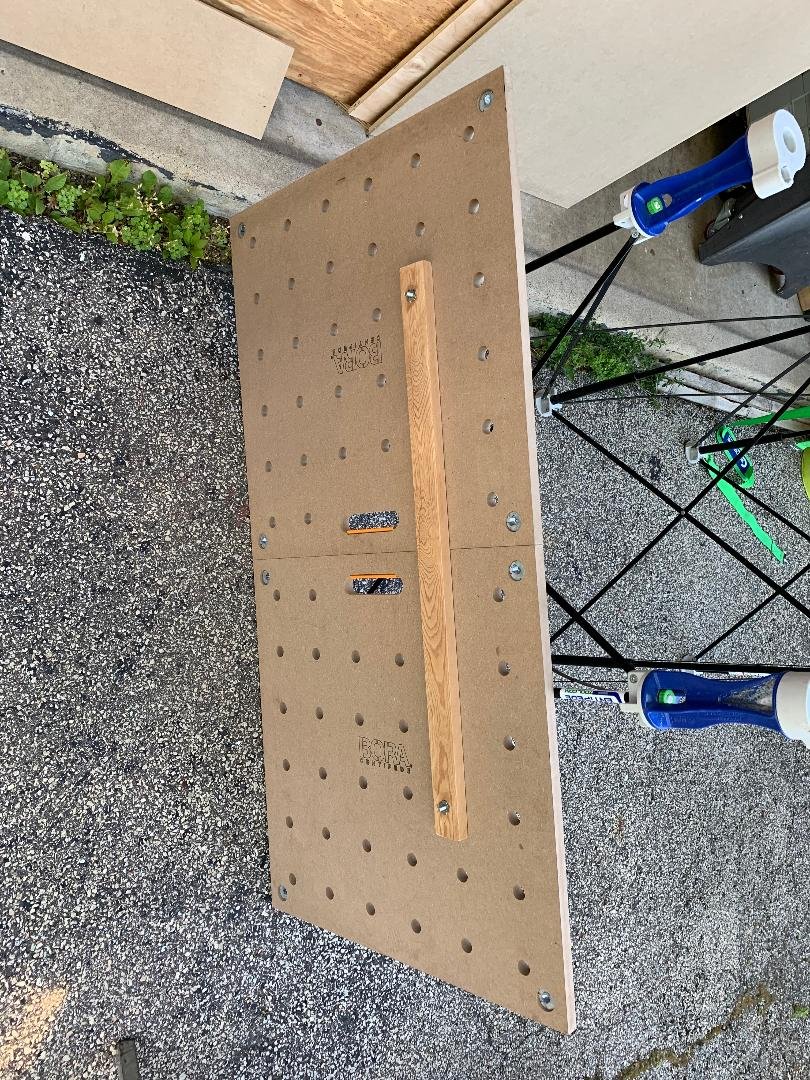

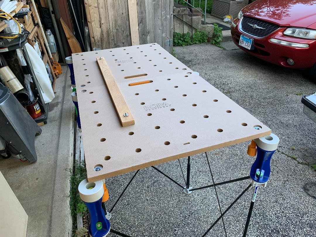

I've been having a small issue with this new top and get it in to place. Some days are better then others and some of this is just old age related, my right wrist sometimes fails to perform like it use to. I've managed but I wanted to make it easier for those not so good days and hey for all the days I want to use it.
I wanted to set up to do some work today and thought that a simple solution was to mount a straight board to the top so the hinge wasn't fighting me as I lifted and adjusted the top. Scrap wood a couple of holes, a threaded insert and a couple threaded knobs should do the trick. This of course is not the only way this could be done but rather a way.
I think the pictures will speak for themselves:
This made my experience so much better, if you happen to find yourself getting one of these tops spend the couple of minutes it takes to make this!
And yes plenty of time to get the router mounted and do the work that needed to be done. And taking the top back off was also a good experience, I might even use this set up more since my tweak.
