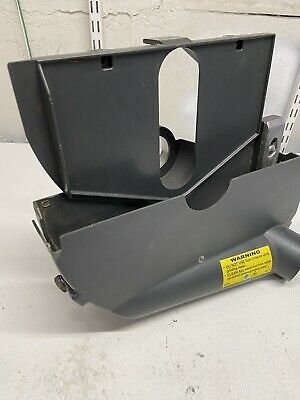

Opinions vary on this, but let me try to give you some things to consider to help you make your decision. In many ways, a Shopsmith 510 tablesaw is better than the DeWalt DWE7485. However, keep in mind that bevel cuts on the 510 are a PIA because the table tilts, NOT the saw arbor. In my opinion, the DeWalt DWE7485 is superior to the 510 in this regard. IF it is a 510 and there is no lower blade guard then that is missing and would need to be replaced. I would NEVER use any Shopsmith in tablesaw mode without a lower saw guard. The on-off switch is just too close to the blade that reaching under the table risks coming into contact with the blade. There should be a lower saw guard with a 510. Honestly, you would probably enjoy the drill press function on the 510 way more than you will enjoy using that WEN table top drill press. The 510 drill press is much better. You mention having a deep 1 car garage. I have a standard size 1 car garage and it is still tight in it even using my Shopsmith 520. IF you have lots of space, then I recommend individual tools because you can get as much quality/features as you can afford for each, not to mention not having to break down a station to do another function (as a Shopsmith requires). However, if you are tight on space, like I am, then a Shopsmith system is a great option. Speaking of small spaces, there are some good ideas in the video below.

Below is a pic that I found online of what the lower saw guard should look like for a 510. It is part number 515290 (Lower Saw Guard). A lot of people may run a Shopsmith without it, but they are risking their fingers (IMHO). Yeah, I would say that a Shopsmith and all of the attachments are at least as good of quality/function as most mid-tier woodworking tools and certainly worth more than the low-tier woodworking tools. However, if you are spending at mid-tier or above, you might prefer standalone tools, if you have space. The reason is newer tools have more bells and whistles on them and often greater capacity than Shopsmith ones because Shopsmith has kept many of the tools/accessories the same for decades. A good example of this is the Shopsmith jointer is only 4", which is perfect for small projects. If you want to build furniture, then that 4" jointer is inadequate. Shopsmith can't make it larger than 4" or it would be too large to lift onto a Mark V. Bottomline is that getting a used Shopsmith is a VERY good value.
