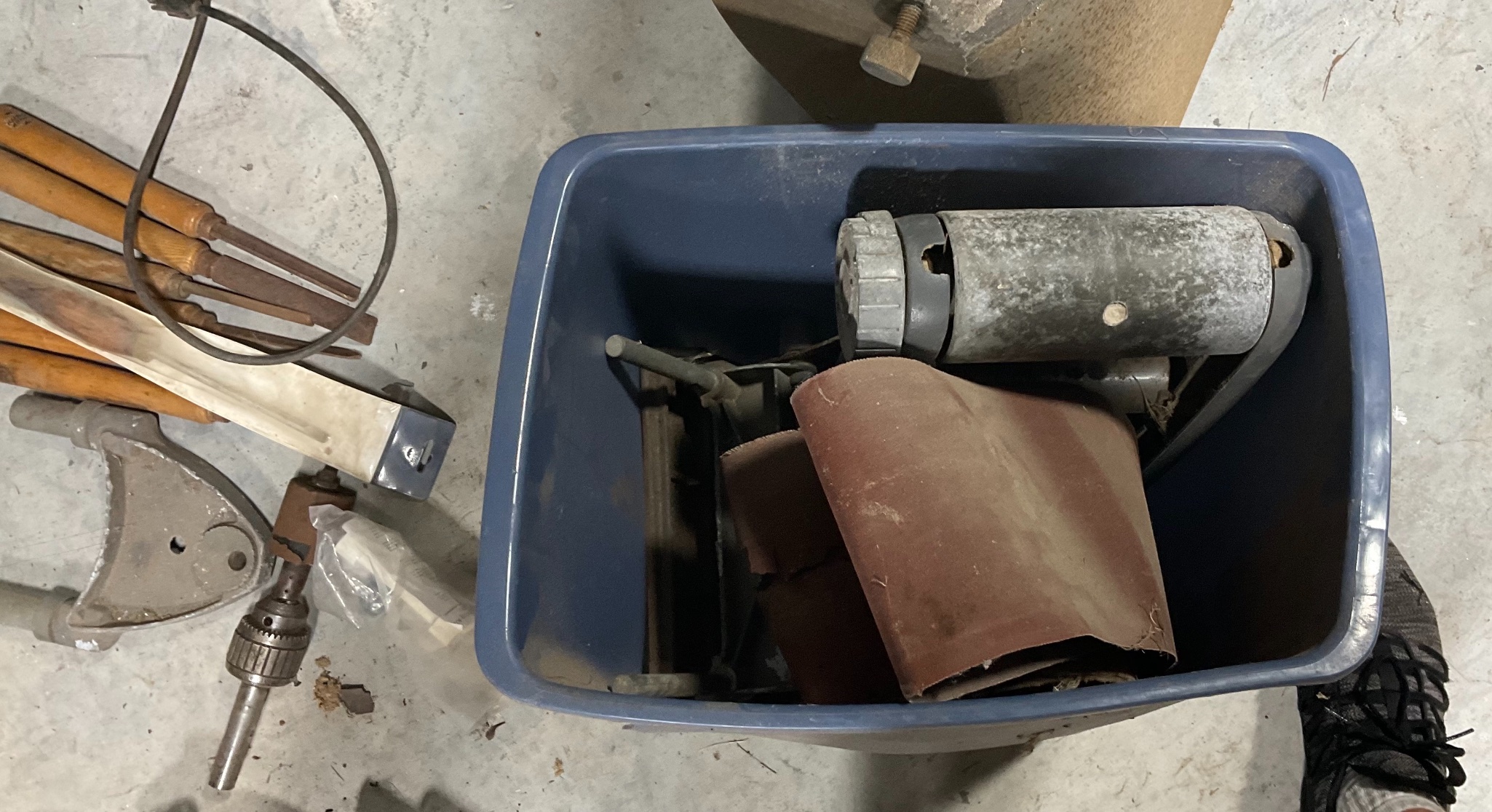

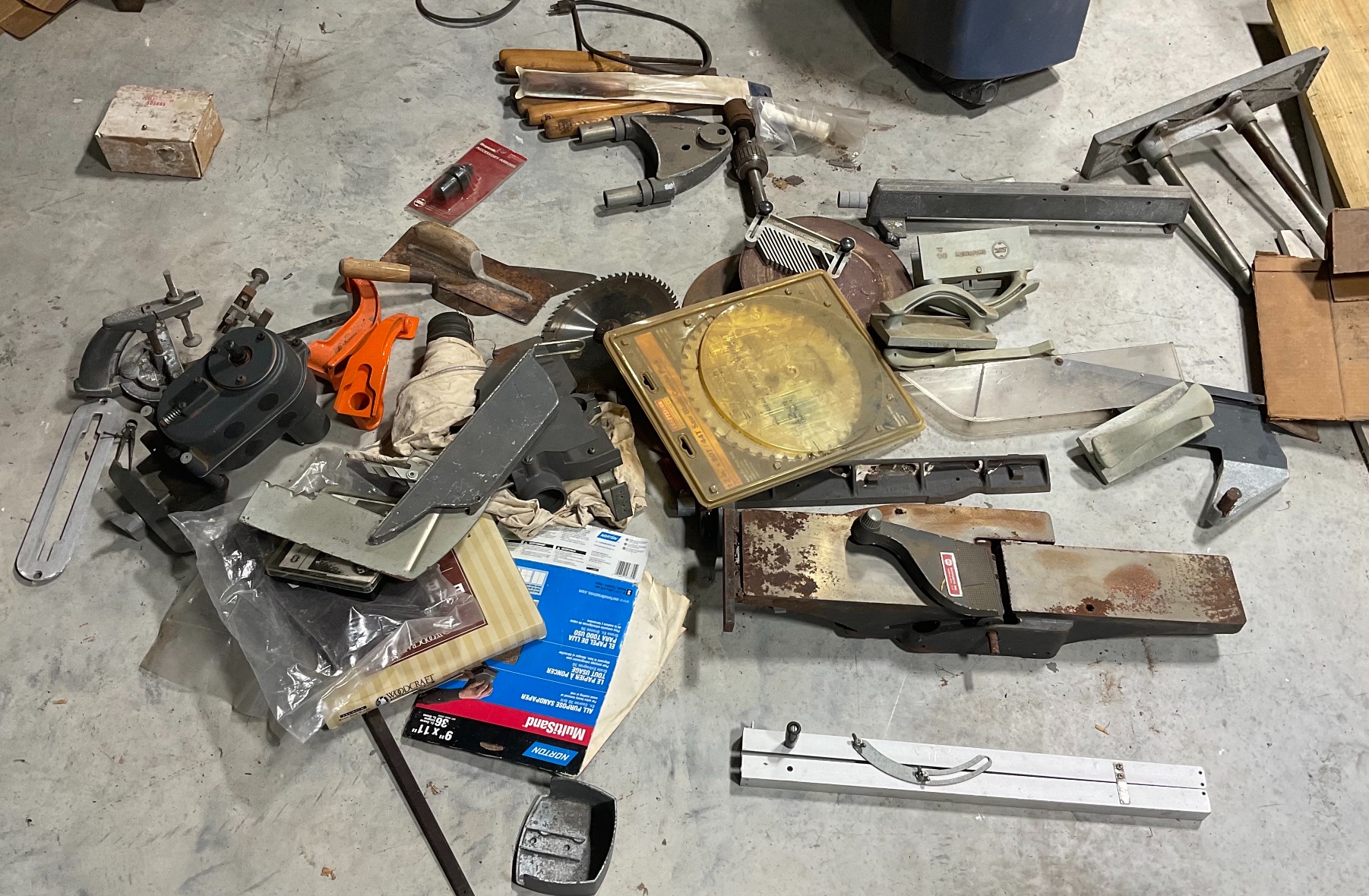

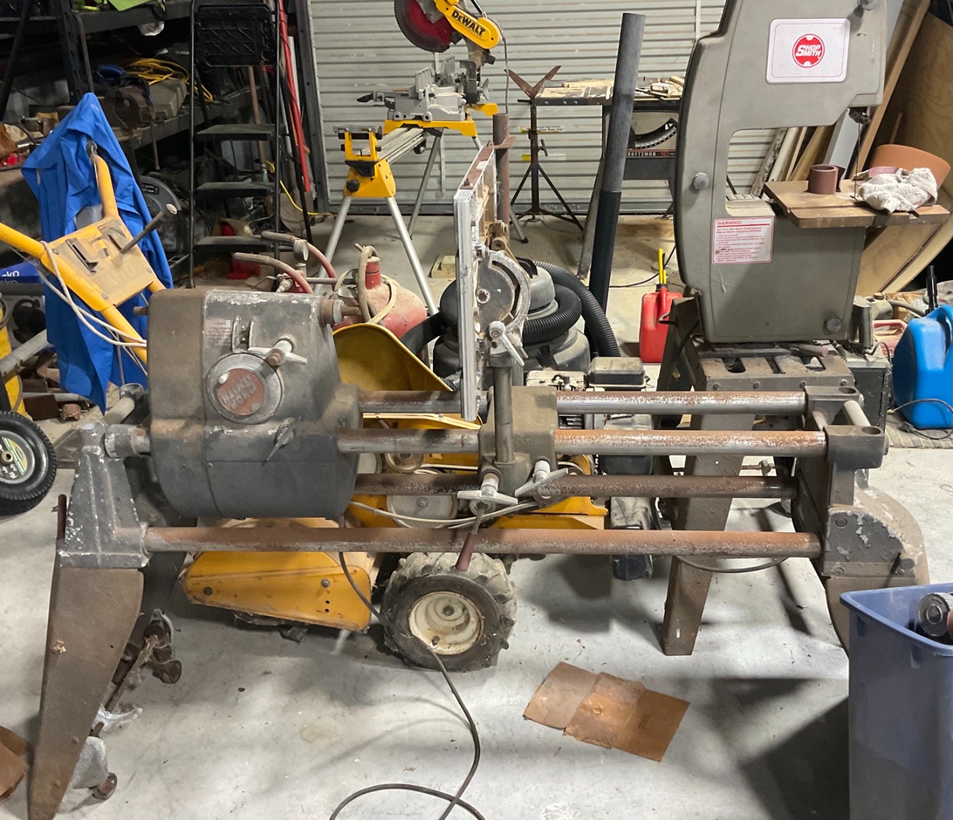

That’s it for now I guess, I’ll post a few pics of mine in case you’d like to see.

A couple things to note - You have a Mark 5 or V with the original table system AKA Model 500. Mark 5 and Mark V is whether it was made before or after early 1980. The difference between the Mark V Models is the Table System and it related parts. Knowing the age of your Shopsmith can also be helpful. The Serial Number can help identify that. Now lets answer your numbered questions.

It look like you have some work ahead but you will end up with some nice tools to use. The Bandsaw on its own power stand is a nice addition and will be ready to use anytime after some cleaning and maintenance. Since it has it's own stand you can use it without having to mount it on the Mark V. There is an online PDF manual available for the Bandsaw at the link below. It is for the newer one with the aluminum table but maintenance and use are primarily the same other than differences in the table.

The bandsaw is a nice addition I agree, but the rubber on the wheels is shot so I’ll have to get that replaced before it’s usable, but it shouldn’t be too bad I think.
