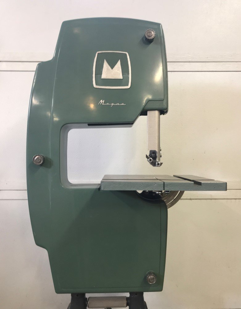

What is the bandsaw case made of? Is it fiberglass or plastic or…? How well does it hold paint? Is there already some discussion on this forum about that topic?

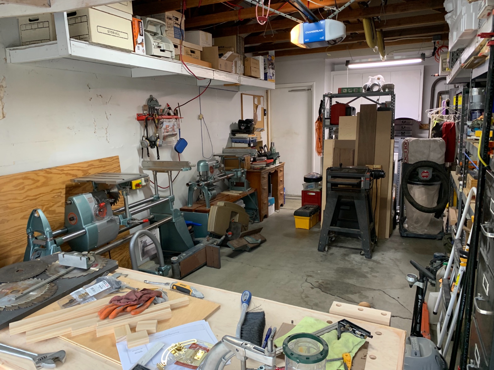

Although I got the “new” Mark 5 on Saturday, I still haven’t turned it on yet. I’ve been focused on fitting it into my garage, and still want to go through an initial checkup and maintenance process so I can both learn about it and make sure it’s ready for cutting. I don’t think Mike’s really used it in a while and I want to get a baseline for my ongoing maintenance cycle.
“New” Mark 5 shoehorned in!!! Everything will fit.

The Dust Collection was a later addition to the Bandsaw (around the early 90's) but can be added. The Cover is plastic so should be fine using paints made for use on plastic parts. When I restored my 1956 Bandsaw I used some plastic polish on the cover and it looks great now. I did repaint the silver logo and letters.
