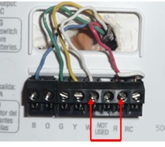

This is a simple Honeywell T-stat and has no fuse, so far as I know. I'm referring to the 3-amp fuse on the circuit board (control board) on the HVAC. All connections are proper - double-tripple checked. Shown in the photo. You stated, "If the wiring is old and the insulation is starting to break apart, there could be a short somewhere along the length of the cable that is causing this." I think that means the wiring from the thermostat to the control board. If it is defective why would the fuse not blow when W (heat) is directly connected to R (power)? Thanks for taking the time to think about this and reply.

So, you have a heat pump right? I say this because I see that the "B" terminal is connected on the t-stat. IF the 3A fuse on the heat pump control board is blowing, then it is likely a short in/around the relay for the heat pump. I would think it has to be this, or possibly a wiring error/shorted wiring in the walls (t-stat wire between t-stat and heat pump unit). So, if you bypass the t-stat completely and just jumper to turn the heat on (with fan) does it stay on and NOT blow the 3A fuse? That is the part that is kind of confusing to me is that you got it to work where it didn't blow the fuse, I think, but then when connected to the t-stat the fuse blow? Is that correct?

Got it fixed. Thanks. I installed the previous t-stat according to written directions. It stopped working on cool this summer. I pulled it, all the wires were connected so I just reconnected them to the new t-stat terminals. Cool worked again. I think the previous blue wire connection was to a null terminal.
