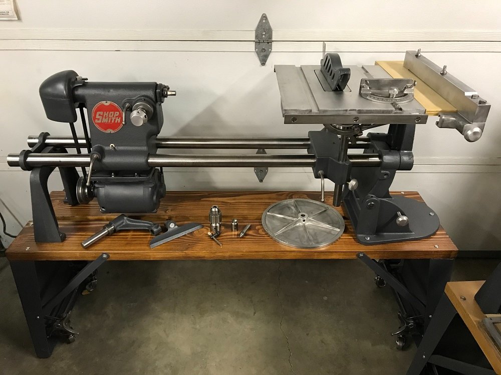

John Burger did a custom size top on Shopsmith/Magna Metal Bench Ends for one of his Model 10ER restorations. It is at the link below and is his 3rd post on that page.
viewtopic.php?f=7&t=23647&start=10
As he described it the boards hang over the edges of the top a bit but the bench ends are positioned at their normal spacing. His bench came out beautifully.
Below is the 10E I talked about in my previous post. The bench has a stained finish. The wood Extension Table has a natural finish to protect the replicated table. The original Wood Extension Table was in bad shape as most of the ones that came with 10E's I have bought to restore have been.

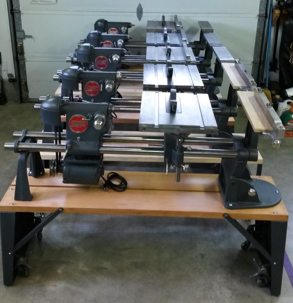

The picture below shows Model 10E S/N 4708 in the foreground with a non stained finish showing the boards original color. You can also see a corner of the bench for it in the lower right corner of the picture above. The three Model 10's behind it do not have a finish on the wood and the Model 10ER in the back has the same finish as the front one although its bench cannot be seen very well in the picture.
_ .
Sorry about "showing off" the picture above but the ones I took the day I had five Model 10's lined up are some of my favorite pictures. It is the only time I have had that many restored Model 10's at one time. The three in the middle were sold soon after that. I still have the one in the back of the picture as it was my first restoration. The file name is the serial numbers of those Model 10's.
_ .
_ .
