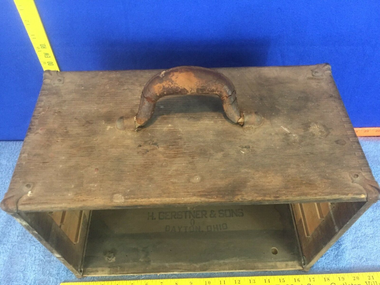

This will be taking a while... Making 6 new drawers for a derelict Gerstner case I bought!
As Carol Burnett would have said, the old case was Completely Hollow:

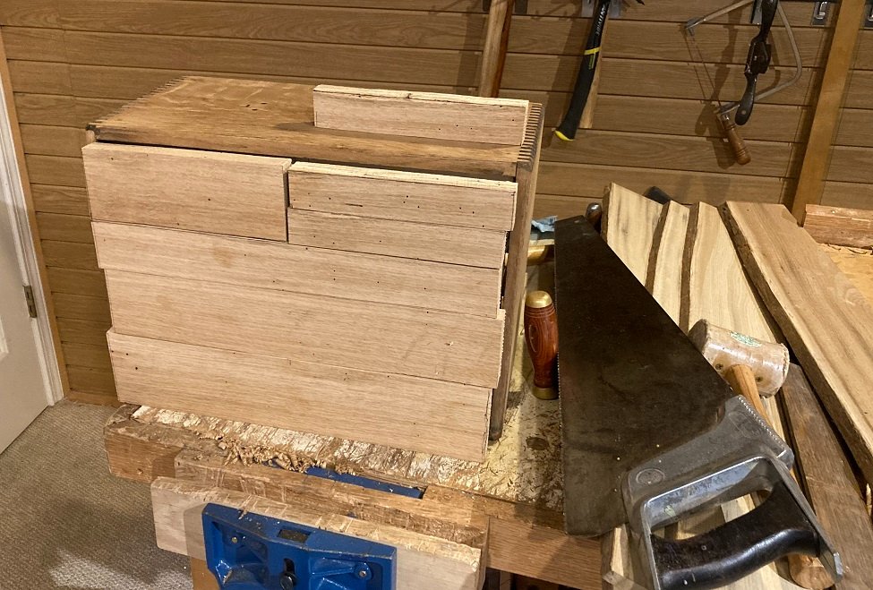

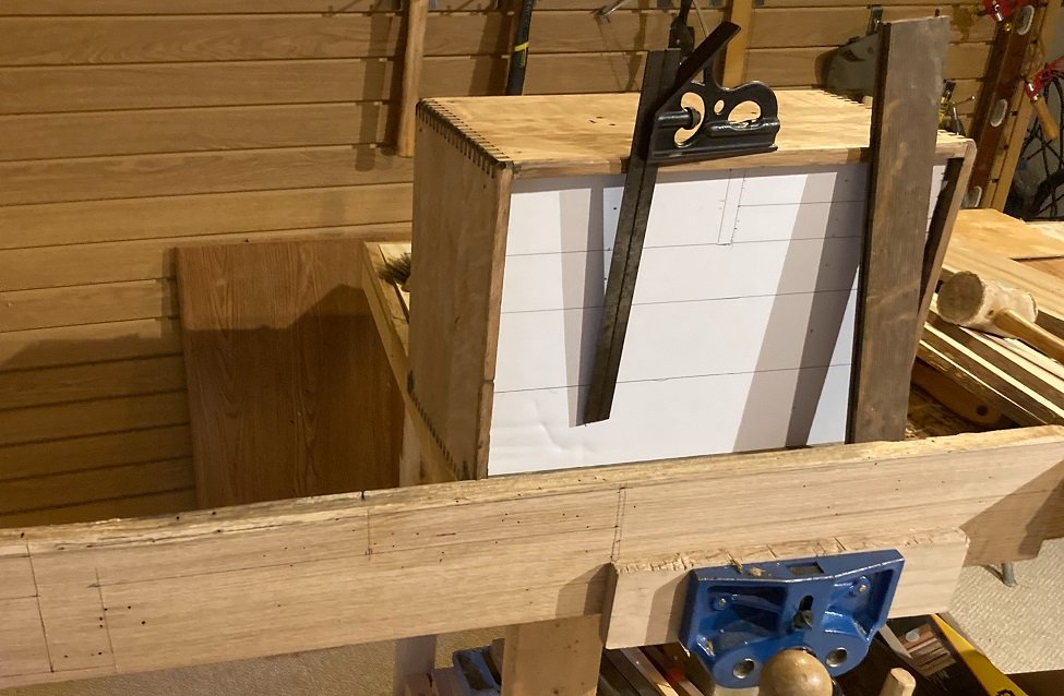

I used a piece of poster-board to draw out basic rough dimensions for the drawer fronts:
I found some prettier pieces of Red Oak to arrange thus:

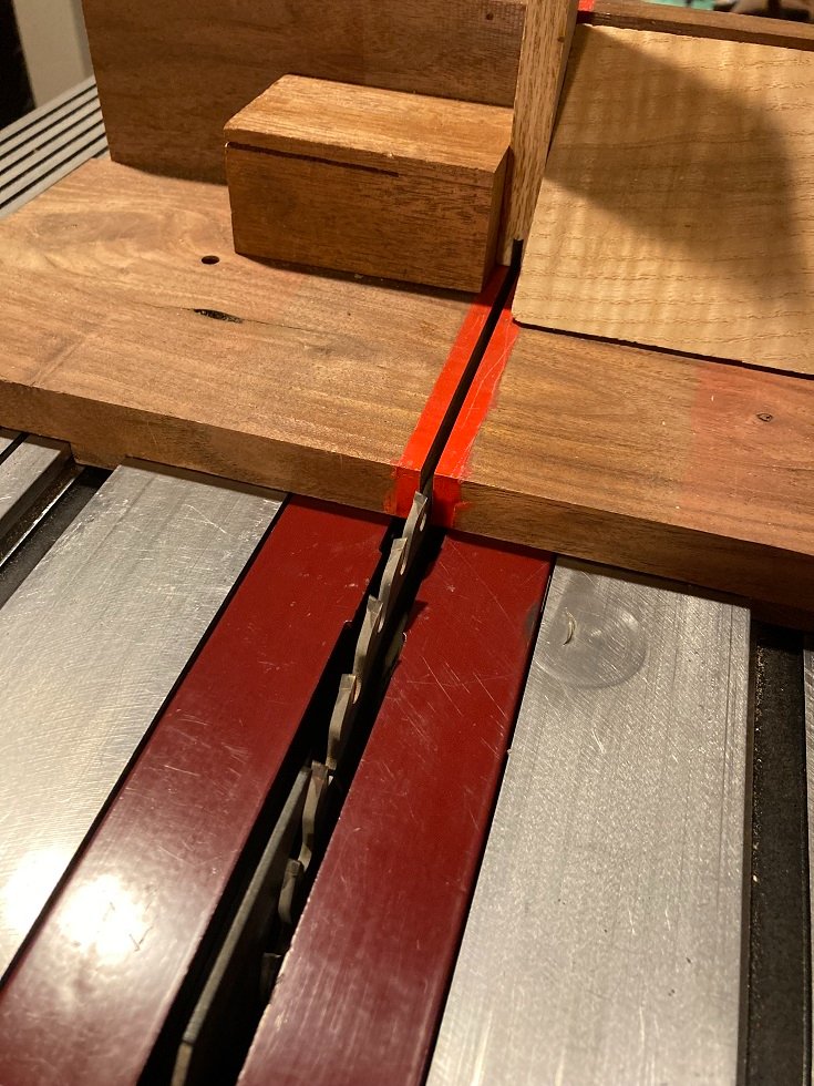

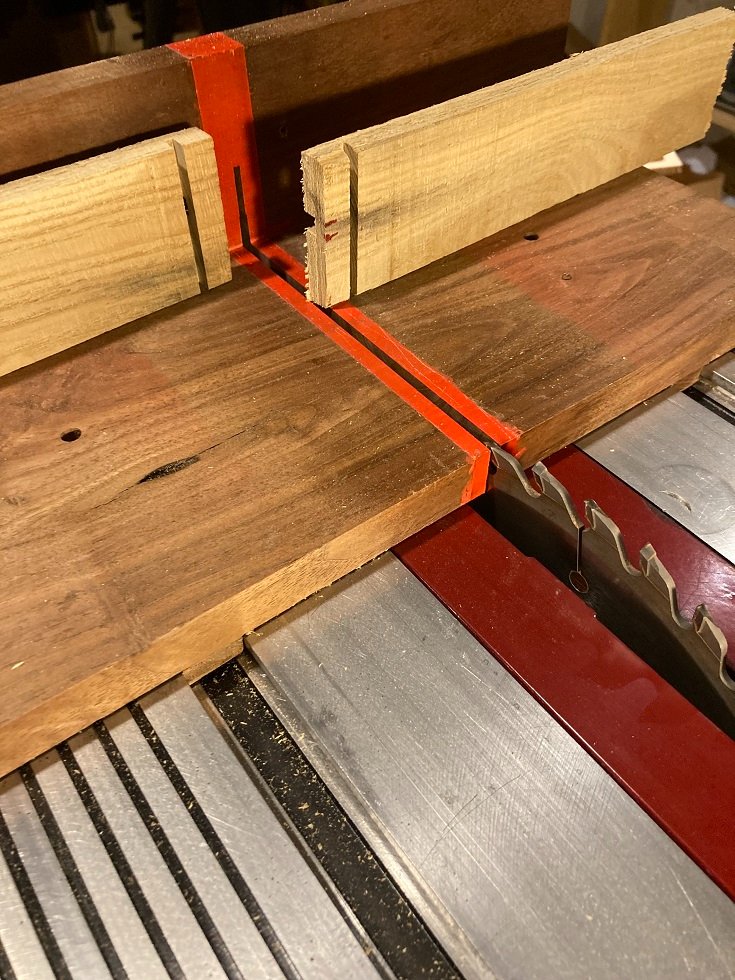

Now I am making parts of the locking rabbets for the drawer fronts. This sled is one I used to use for making Pen Blanks:
Similarly, cutting some slots for the sides of the drawers, rough for now:

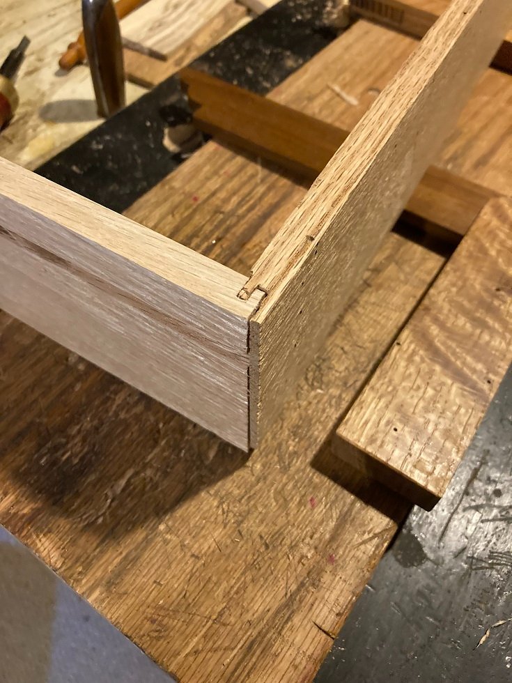

And, I just have to do this kind of fine-tuning and carcass-fitting for 24 corners coming up....

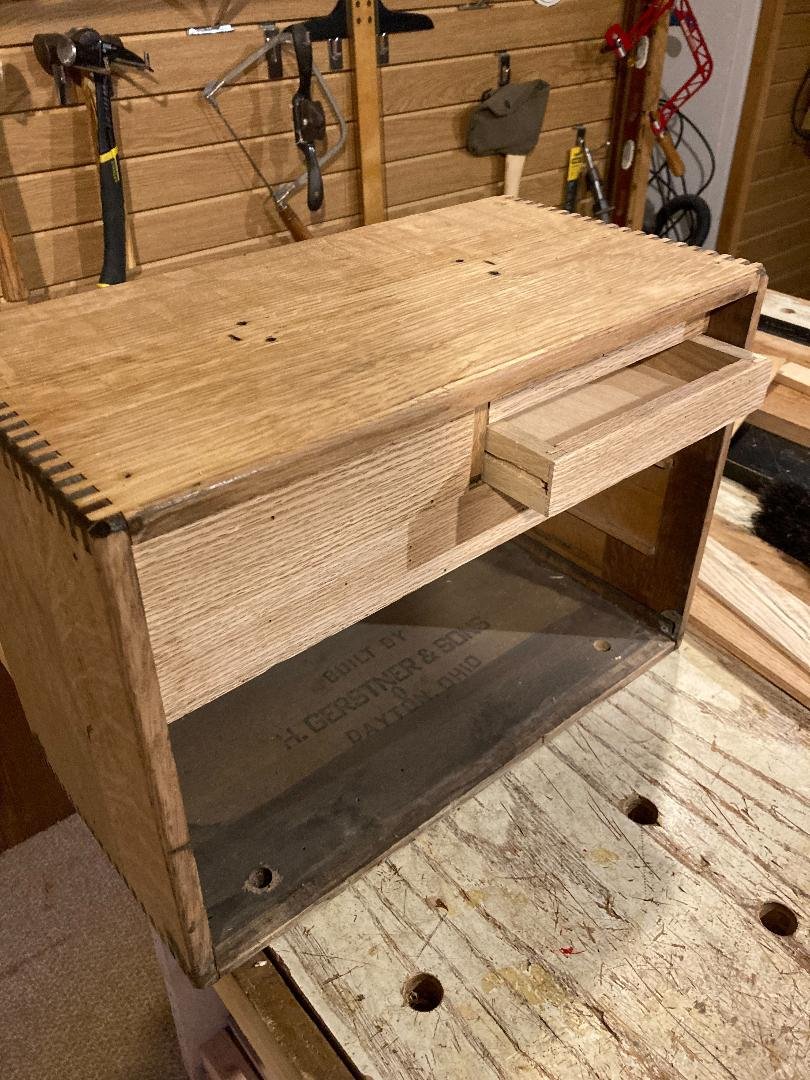

Well, it's a slow journey, but 4 drawers are glued-up now, trimmed very finely to fit. All drawer-fronts and all drawer-backs have been extracted from one oak board that has seen the SS Bandsaw a number of times!
Chris

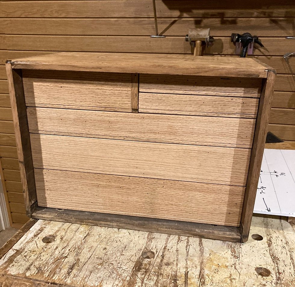

And now there are six drawers !
6 Drawers Fitted.jpg (255.75 KiB) Viewed 2289 times

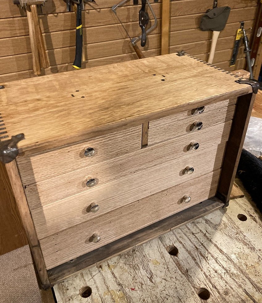

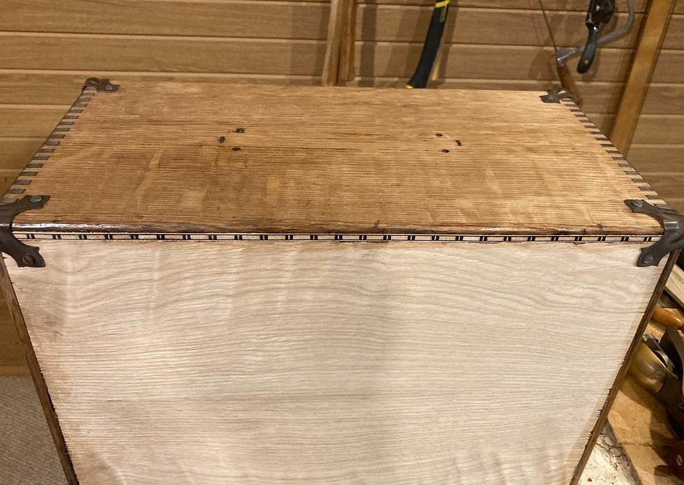

Almost all structural work is done now. I had to re-laminate some veneer for the back, and I got some knobs in for the drawers:
Marquetry Let In.jpg (145.13 KiB) Viewed 2104 times
Knobs Added.jpg (238.88 KiB) Viewed 2104 times
