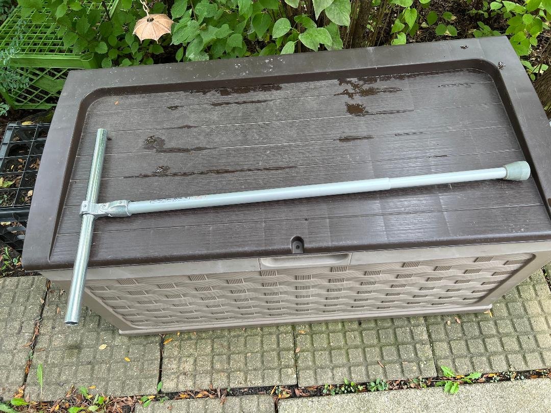

Did some testing. This is my test subject which I called pogo:
The other part is not shown but it is a bathroom scale, digital in my case. This is something others can try at home. Just make sure you are on a solid floor, not carpet. By putting the end of pogo on the scale and adding your weight to the cross bar you simply watch/feel for slip and stop at that point. Do several test and see what you see.
I saw 82.x to as high as 87.x but most reading were about 85.x pounds. This seems pretty reasonable but it would be nice to see what other find.

reible wrote: Fri Oct 15, 2021 3:17 pm I saw 82.x to as high as 87.x but most reading were about 85.x pounds. This seems pretty reasonable but it would be nice to see what other find.
Thanks Ed. Appreciate your insights and experiment. Just so I am clear, are you saying that at around 85.x lbs is where these legs started to slip? Is that correct? I don't know what number this should be (for a good design), but 80-100 lbs kind of seems reasonable to me given the design of the telescoping leg. IF one wants to put more weight onto extension tables, perhaps we just need to double the number of legs used...just a thought.

Re: Looking for Ideas for Storing Shopsmith Tables?
Yes the 85 point seems to be where things start going south. Now that is missing is would this be common or just with the two I tested?? I do have two more but difficult to get to right now.
