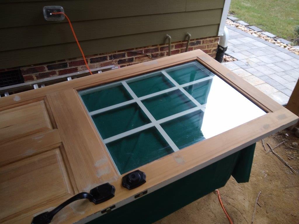

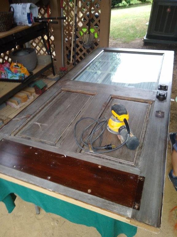

Taking off kickplate revealed how "weathered" it actually was haha. Had no idea it was such a dark stain .
Sanding it back took awhile ...and multiple stainings to get it relatively even and touched up here and there with a stainable filler.

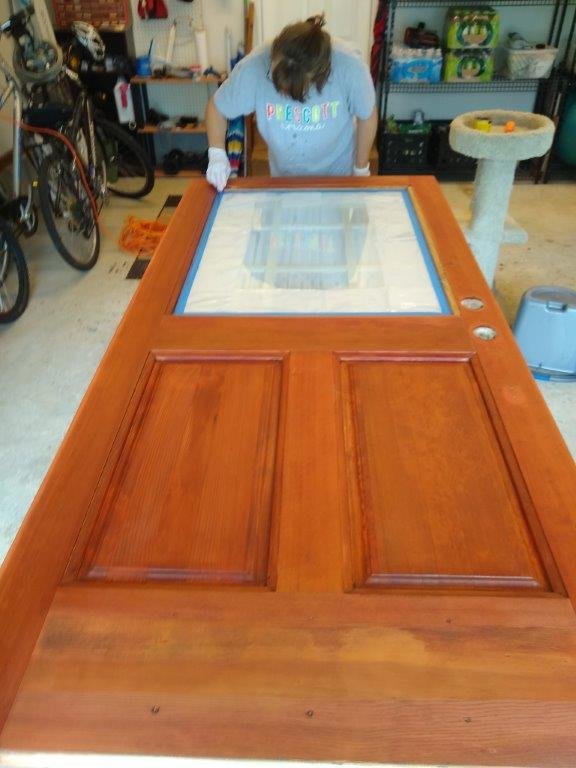

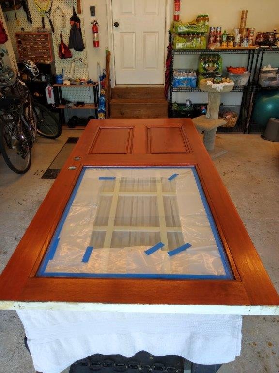

As part of the process, the lady wanted to try 5 different stain colors. We put them on, and let the house vote for their first and second favorites and determined a winner. I went off and bought a couple more small cans of the winner. Well...as I recall the winner had a more yellowish hue to it then what was goin down. Someone had mixed up the cans and the ordering during the voting ! The final stain was "Sedona Red" followed by multiple coats of the Spar Polyurethane.
Anyways-unlike national politics, we decided to hang the door and give it a try-even though it wasn't our first choice. Lo and behold- it don't look bad.

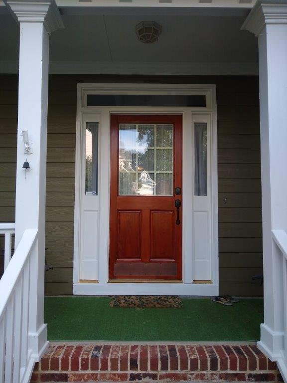

and finally back in place -

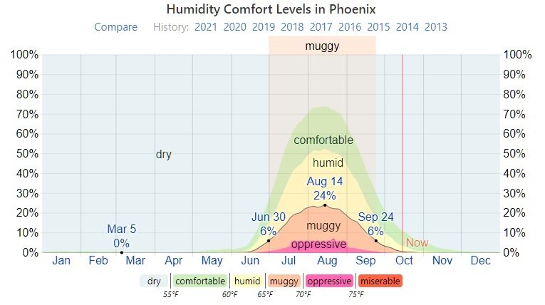

Yeah, that is my concern as well. IF the lumber was super dry to begin with I think it would be okay if I can get it straight enough. Of course, I can start with thicker stock and mill it down to try to get it as straight as possible. I just know doors have to be very straight and dry to start with or you'll have problems. I can tolerate some wood movement on furniture and other projects that I build, but doors are more demanding. I have no experience building a house door, but I have built shed doors with Dad in the distant past. This area is drier than other parts of the country, but the humidity does fluctuate throughout the year (see below). Our humidity peaks during the summer monsoon season, but daily humidity can very high when it rains. So, we can have quite large swings in humidity at times. To compound to this is that the humidity inside my house stays a more constant 45-50% humidity all year round, so there is uneven humidity on one side of the door relative to the other side to contend with.

That chart could represent a typical day in June around here.
