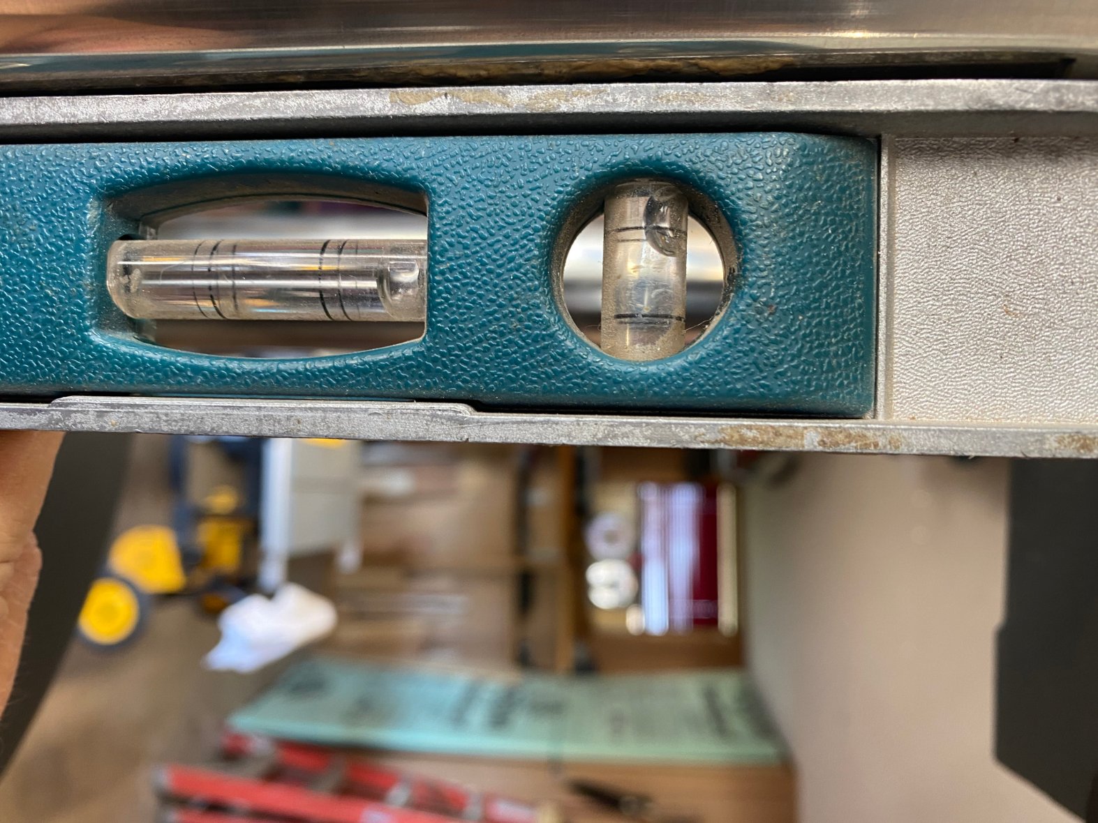

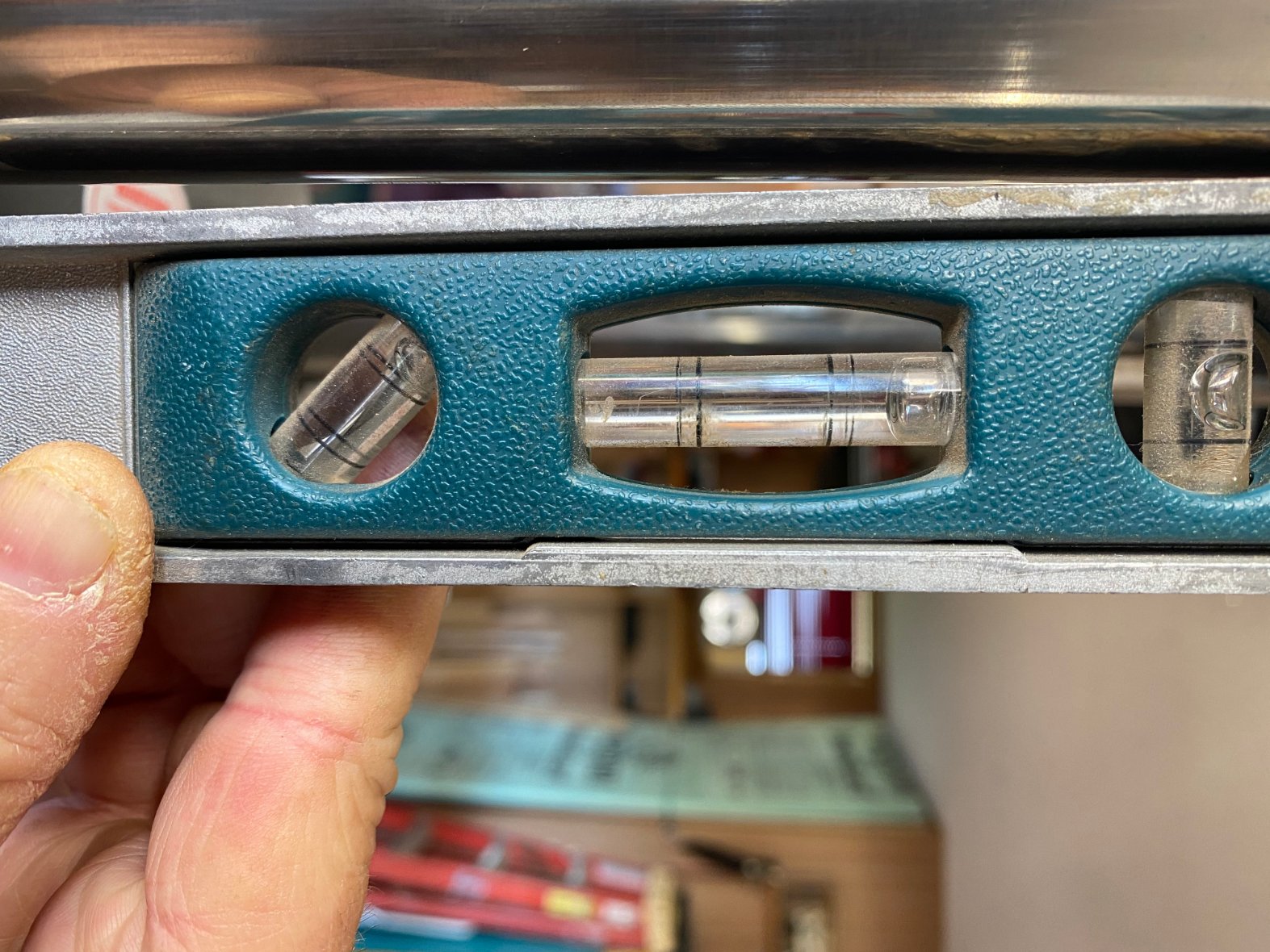

i have been going slow with the new "used mk 7" haven't had alot of free time. i started off checking alignment and discovered that several of the leg bolts, lift assist bolts and caster bolts were not real tight, so i backed off went to step one off install and setup, everything is falling into place BUT when i have her in the vertical position the way tubes are not a true 90 deg. i put a level on in and in vertical im about 3/4 a bubble. the detent screw is off a bit but i think if i remember that is correct but im not sure on the way tubes ?
so in a nutshell when you all have yours in the upright position are the way tubes true level ??
the pics are 90 degrees out, they should should the level up and down 90 to the left. im watching the bubble on the right, hope this makes sense
also i checked the same thing with the table lifted on the other end with the same result

No worries. Sorry I didn't post more detail earlier, but I felt like enough had been said on that other thread recently. It was quite eye opening and informative. Which way is your machine off? I couldn't quite tell from the pics. Keep in mind that the bench and waytubes have to be fully seated in the bases as well. If not, they can cause some offset as well and risk coming out. Can you post a pic more zoomed out so that we can see if your machine, when vertical, is under (say 89°) or over-rotated ( say 91°)?tkjones63 wrote: Sun Oct 31, 2021 4:06 pm

It "should" be slightly shy of 90°.

the tubes in the upright are just shy of 90 about 1/2 a bubble and the same on the other end in the upright, but in the horizontal she is dead true, and the table to quill is true, every other item i have checked so far has been close as possible.
