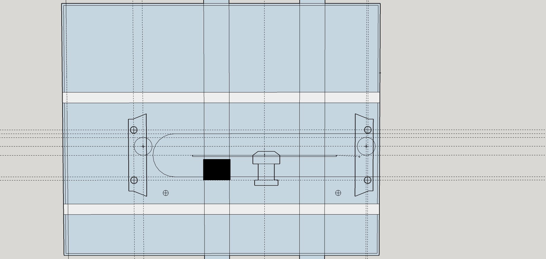

What really effects Main Table Alignment to the Blade:
Shopsmith Main Table (Bottom View)<br />What effects Alignment to Blade?
Main Tab;le Bottom Vierw.jpg (137.39 KiB) Viewed 1012 times
Loosen the four trunnion bolts, push the trunnions hard against the bolts ( in any direction ), secure the bolts, and check alignments.

I am seeking a trunnion that has not been drilled to 1/2" so that I can assemble and test this scenario but I don't expect a lot of change.
If only one trunnion bolt is 3/8", yes, That trunnion bolt becomes a pivot point and everything rotates around ot but the rotation is still limited to about .2 degree.
If either trunnion has two 3/8" holes, the amount of rotation is significantly limited. This was the contention when the recommendation to drill the trunnions first arose.
This sketch, however, was prepared by measuring each of the items in the assembly and transferring those measurements to the drawing. I did each part independently and then assembled the final drawing one piece at a time. The final is a collection of five different drawing superimposed and positioned according to my measurements. My model was my 520 fully assembled and critically aligned.
I believe that a 510/520 full table assembly could be aligned and mounted with no need for further tweaking. The Shopsmith is an assembled of well designed individual parts that when assembled properly produces a fine home multi-function tool.
I left dimensions off of this sketch on purpose. The intention is to highlight the fact that all of the parts that contribute to alignment are assembled either parallel to or perpendicular to other parts. If you would measure everything in the sketch, you would find that 1/16" increments prevail throughout. There are no extreme precision items involved.
