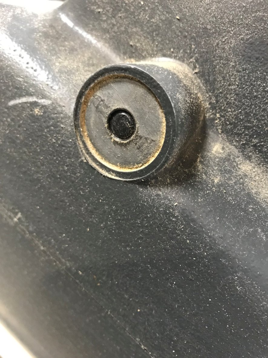

JPG might have meant a pic of the rear wedge lock taken from the outside of the headstock. It's easy to see if it is going to the unlocked position there.

I'll get the pic from the outside of the headstock for the lock wedge. Hang on a sec.

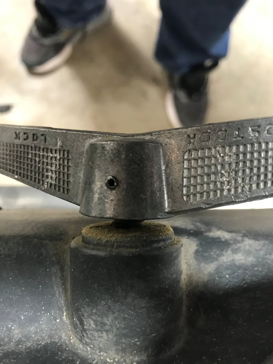

Ya know looking at this you can see marks on the lock lever where someone put some channel locks or something to really tighten that down.
The wedge on my other SS isn't sucked in near as far at this one is.

The rear lock isn't in the unlocked position in that pic. The wedge part would be proud of the casting, like your front one is. IIWM I'd try cleaning it around the edges with a pick or scribe and compressed air, then pop it in the center with hand or mallet again while unlocked. If that doesn't work, maybe soak with penetrating oil and try again.(?) I've never had one that didn't release when I popped it with my palm, this is new territory for me. So if someone else has a better idea listen to them.
Channel locks weren't the best approach. Possible that the wedge locks weren't preset right when installed(?) and weren't locking right.

Okay so tap it on the lever (front) side to push the back wedge out so it's proud like the lever side?

KCollins wrote: Mon Dec 13, 2021 12:22 pm Okay so tap it on the lever (front) side to push the back wedge out so it's proud like the lever side?
Yes, with the headstock lock as loose as possible. It likely will loosen more if/when the rear wedge-lock breaks free.
