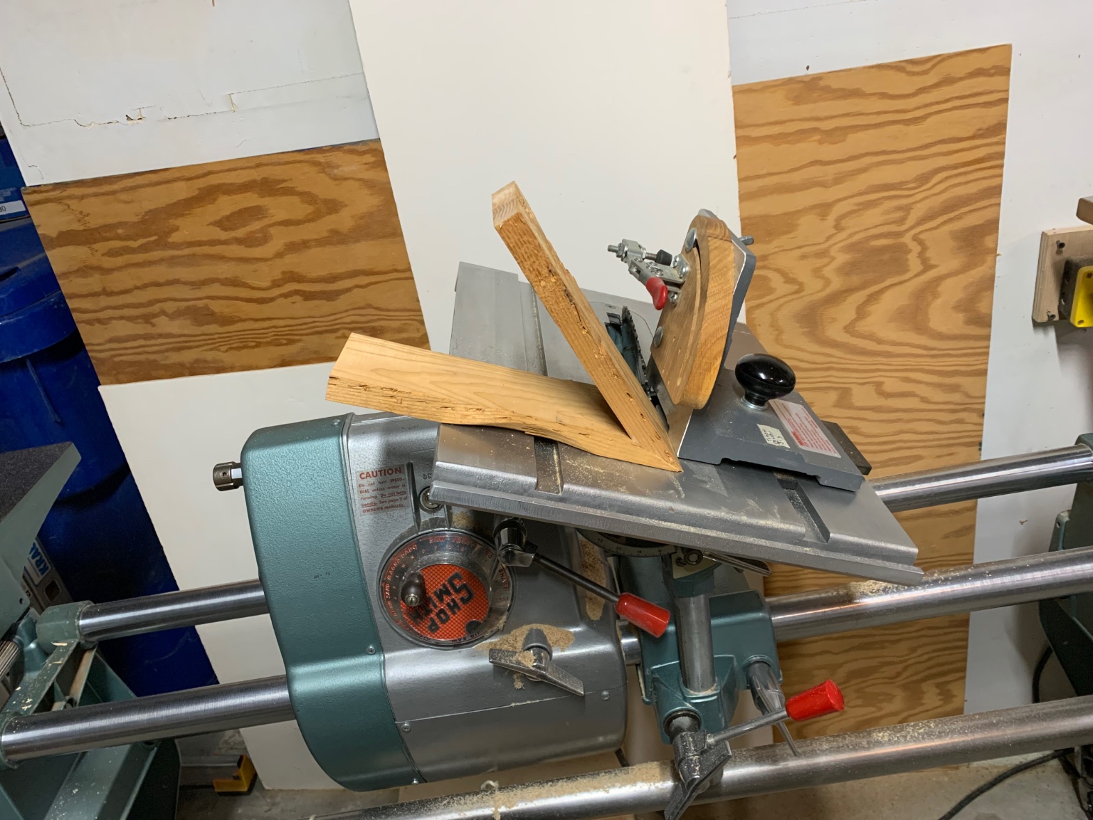

Thank you all for the suggestions and geometry discussion, it has been helpful to this new woodworker. When I offered to make this “simple” display case I had no idea that it was not so simple. But your discussions brought me back 45 years to my 10th grade geometry class, which I loved.
This evening I cut a few ~10” lengths of rough 1 x 4 pine stock that I’ve had for years, so I could test the Tenon Master and table angles. My tenon master seems to be very solid and true. First I put in the dado insert in the table so I could get the blade close to the tenon master, which will all over me to get the knife edge that’s needed for this joint. I put the table at 22-1/2 degrees, and then made a few cuts to get the blade depth right. The photo below is what I ended up with. Although it may not look it in that photo, the the joint is tight, well aligned, and the outside angle is 45 degrees. I will now do the same test with some freshly milled maple scrap pieces I have, to make sure it’s close to perfect. Then the next step is to work on the prototype. If the angles need some work I plan on doing the adjustment with the conical disk sander. Any more suggestions are welcome; mind still open, and still learning.

Tricky part is getting the angles AND the lengths correct.
