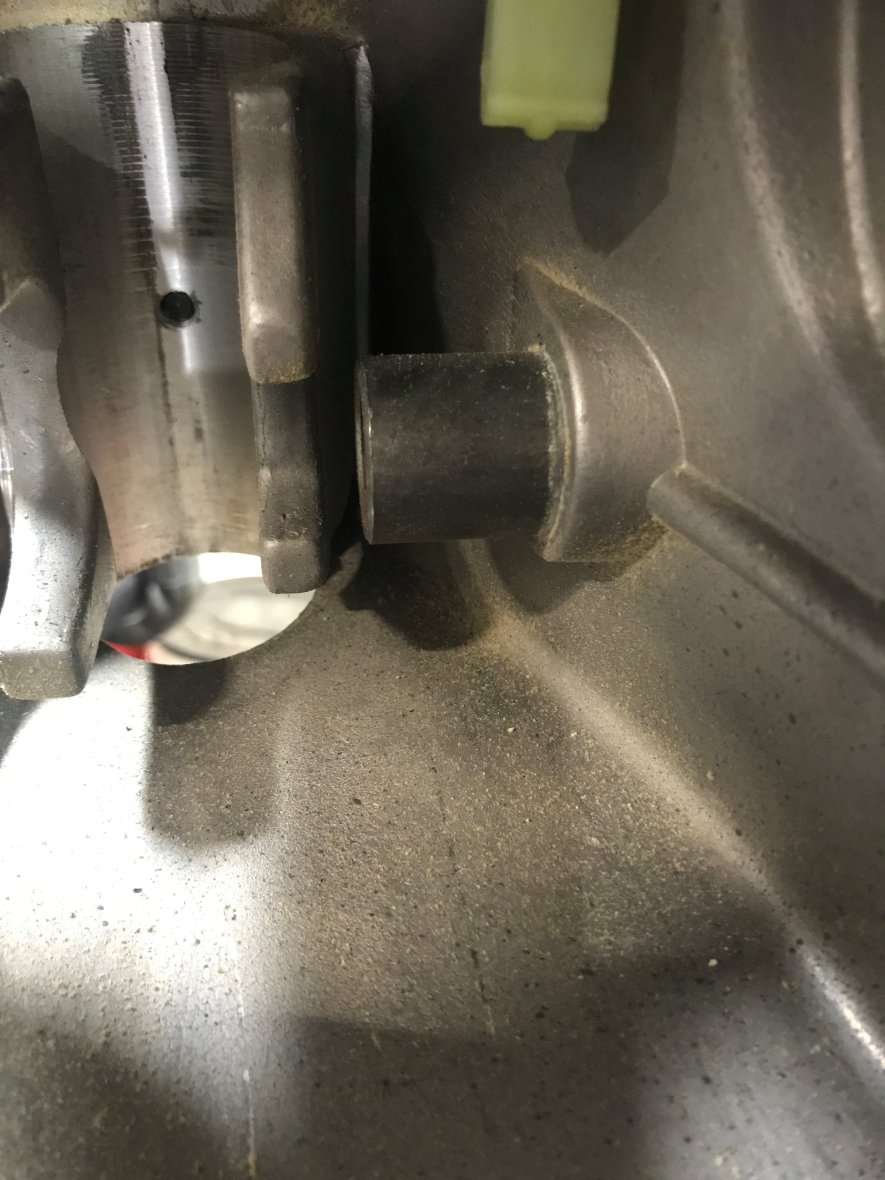

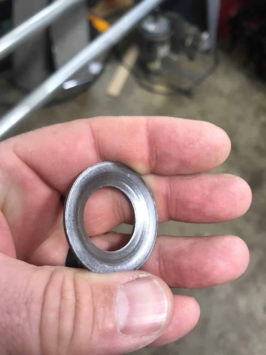

Okay... Motor is off. The reason the motor is off is because I was trying to short cut everything and make it a quick fix.... When am I going to learn. Long story short I twisted and tugged on the quill shaft a little and it started to slide out. So capitalizing on my momentum I kept going. Right up until I heard something go clink and tumble down into the motor pan. I thought to myself. That sounded important. LOL... So I in order to get my hands on whatever fell I had to take the motor off. After doing so I can see how this makes things much easier. Should have done that in the first place. Why didn't you tell me to do that David??? Okay... I am going to guess this is the coveted "domed washer" everyone that is in the know speaks of.
The washer looks pristine.
And is this bushing supposed move? Because it isn't budging. I can persuade it with a deadblow if you think that would help.
Let me know your thoughts guys.

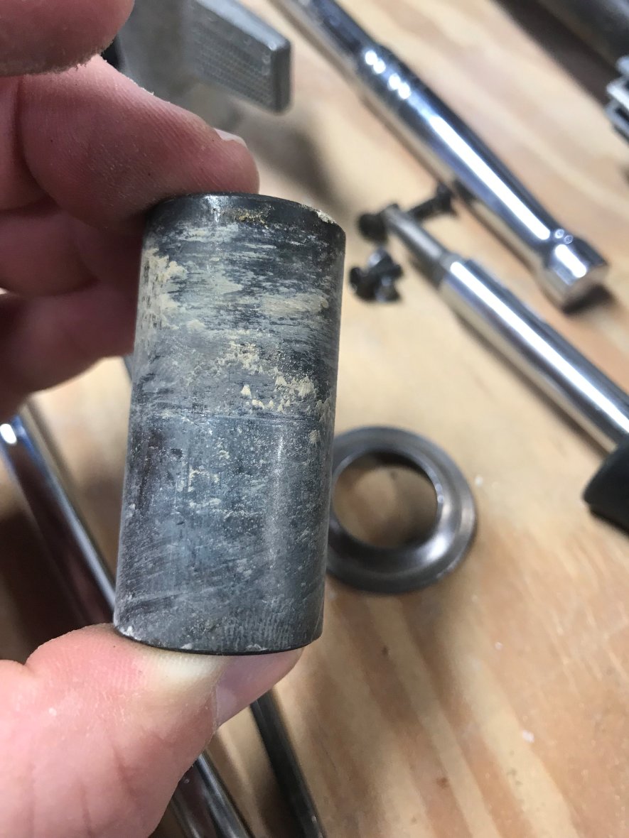

Got that bushing out. That thing was in there. Is this supposed to turn when you extend the quill?

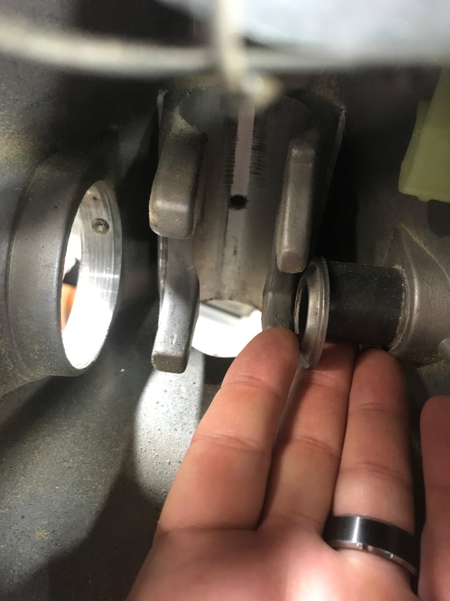

And then is this the location and direction the domed washer needs to be?

Yes, it should turn when you extend the quill. That's probably the problem with difficulty extending your quill. It also needs to slide in and out freely as you loosen or tighten the lock. WTH is that stuff on the outside of it? And what kind of condition is the bore that it goes into in?

Note - The domed washer goes in opposite the way you are holding it in the last pic. Domed side should be toward the sleeve.

That "bushing" has an internal key groove that a woodruff key on the quill feed shaft rides in. The "bushing" slides in/out and when it presses against the domed washer which locks the quill position. The key causes the "bushing" to rotate with the quill feed shaft. A wave washer presses against the outer end of the "bushing" when the quill lock wingnut is tightened. The wave washer allows semi tightening of the quill position.

DLB wrote: Wed Dec 15, 2021 8:51 pm Yes, it should turn when you extend the quill. That's probably the problem with difficulty extending your quill. It also needs to slide in and out freely as you loosen or tighten the lock. WTH is that stuff on the outside of it? And what kind of condition is the bore that it goes into in?
- David
That stuff isn't coming off either. The sawdust I'm encountering is a fine powder. Almost like MDF only it's too light for that. I think it's pine and with pine comes sappy resin that gums everything up. It's everywhere. It's almost impossible to turn the table crank on the carriage too. I'm not sure what to hit that bushing or sleeve with to get that gook off. But it is going to have to come off. I thought about a wire brush but that would scratch the hell out of it. So I'm leaning toward a Brillow pad and some Goo Off.

DLB wrote: Wed Dec 15, 2021 9:46 pm Note - The domed washer goes in opposite the way you are holding it in the last pic. Domed side should be toward the sleeve.
You'll have this thing purring like a kitten when that truck rolls up. ;)
- David
Awesome David that is why I posted that pic to make sure it goes back in the way it fell out. LOL...
