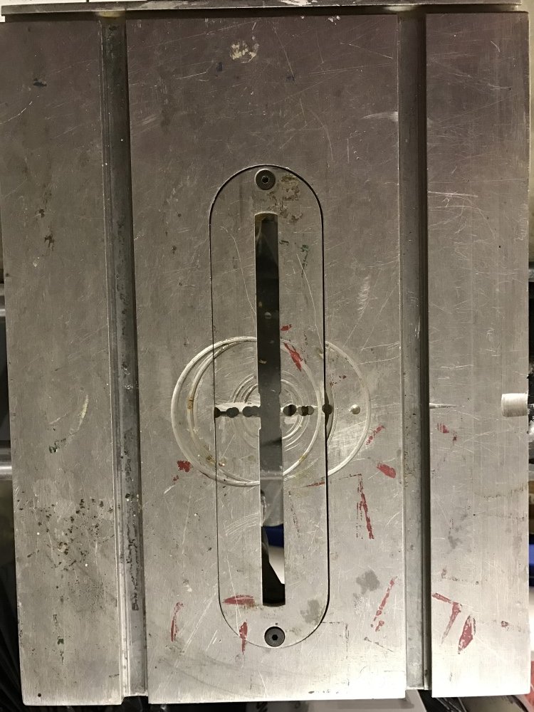

You have received several opinions already. David mentioned table flex and you can add additional support with the 27" Connector Tubes and Telescoping Legs. I have used my Shopsmith's to drill metal. I use scrap wood to protect the table when doing so. I have also made several wood table inserts that can be used for drilling or other uses. Below is a picture of a Mark V 500 table that the owner didn't use anything to protect it. No matter what material you are drilling through do protect the table.
