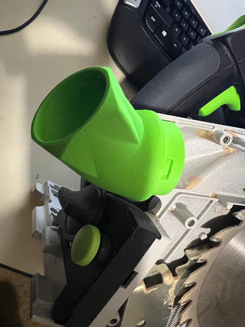

I designed, printed, and started selling the No Hose Snag adapters because I was irritated at the stock dust adapter rotating down and causing my hose to snag. I started doing the Sedge wrap the hose around your arm trick. Then thought this is stupid, why should I have to remember to wrap my arm around each time. A few prototypes later I had a solution.

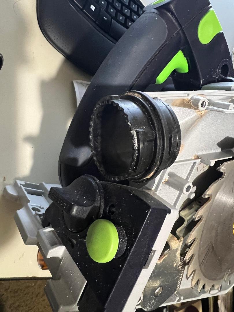

I've just been working on my TS55 this morning. I had cut some PVC and the saw had this fine gritty PVC swarf sticking to places. Vacuum took care of that. Then pulled the saw blade cover for pictures and then cleaned inside after taking the blade off and digging out a few areas that seem to collect dust inside.
Next I put on the new hose connection. We will get in to a little history and of course we have pictures to share.

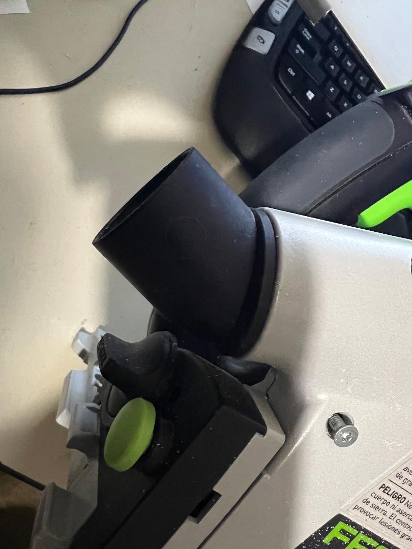

When I first got the saw it had the swivel hose connector and it would turn how ever it wanted. I really didn't like it. Here is a picture of it:

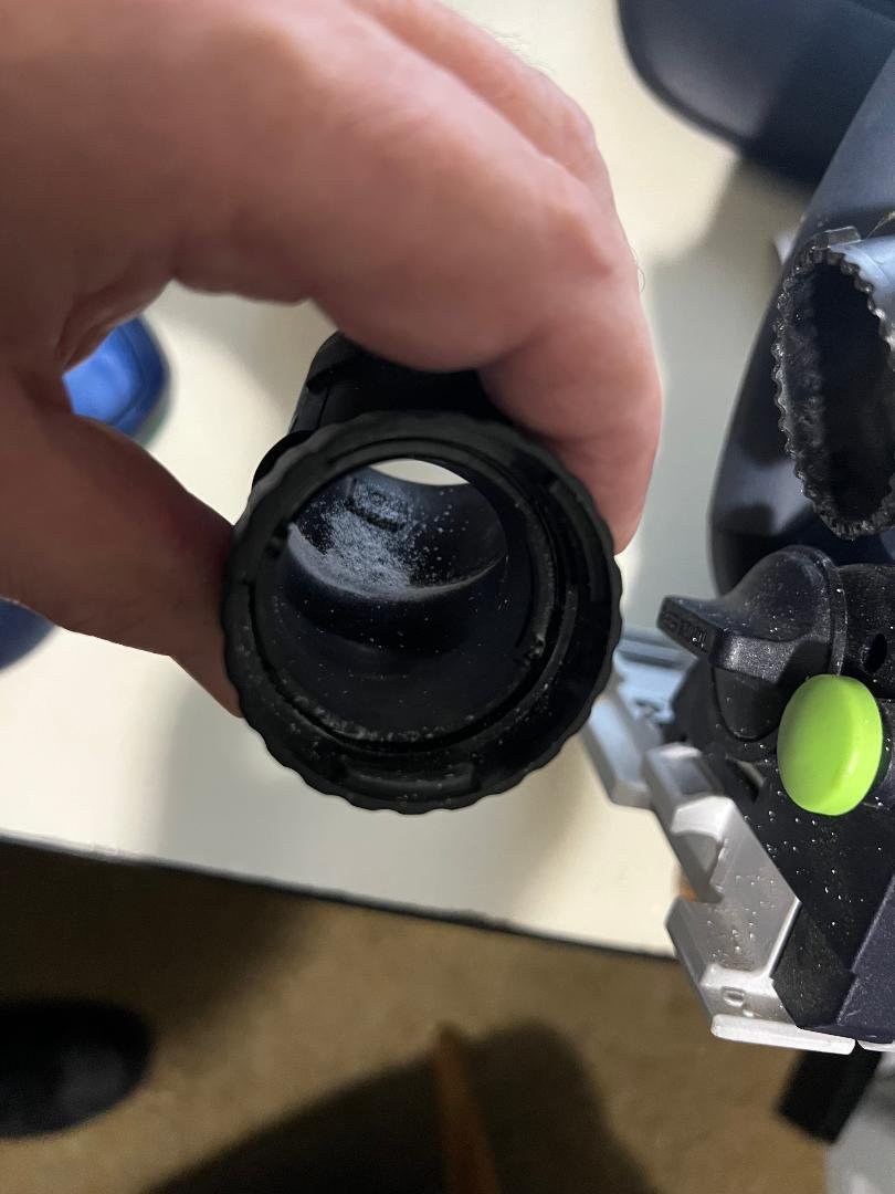

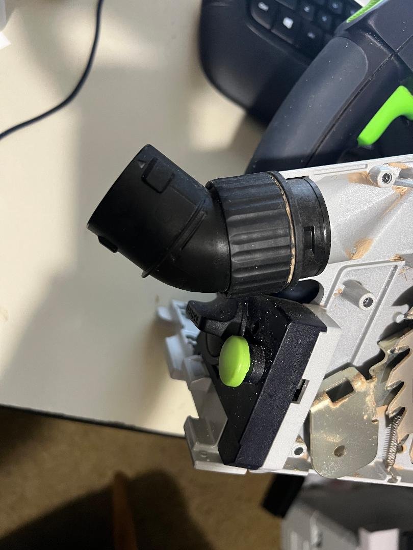

Then I read somewhere that they had a new and improved version that you could add to your saw. It had a fixed in place part and a swivel with detentes that connected to it. It was no where near strong enough to keep the hose from again doing as it liked.
I think this may come standard on some of the saws..........
The other issue was that you had to take the two parts apart to get it to fit in the case. I think you could buy a new liner that adjusted for that but I never did.

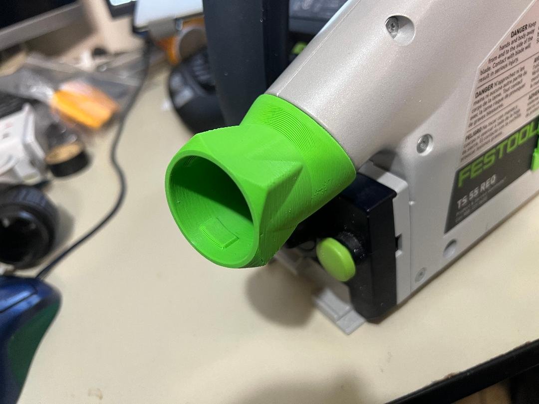

This is the new one that I hope will solve all these issues.
You can see the tab locations that hold it from turning. Once the cover is back on it is not going anywhere.

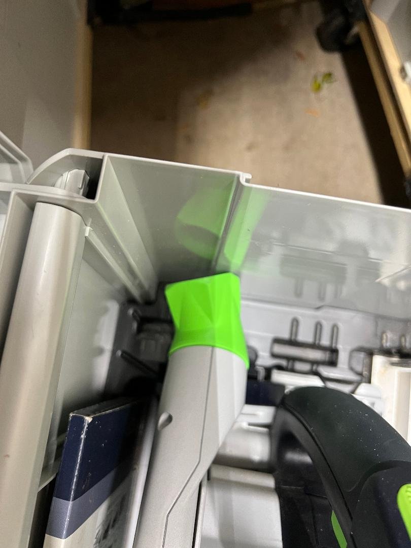

So far so good. Now to see if it will fit back in the systainer.
Yep, now when it warms a bit more and I can get back to doing some cutting we will give it the big test of actual use. I think it will do fine at that.
