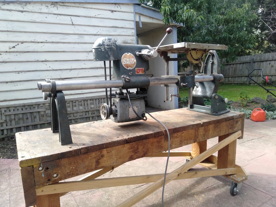

I have a 10E with a serial number of 2544. It was bought by my dad in Australia sometime befre I was born. Is there anyway of findoing out when it was built?

There were Shopsmith Model 10E's made in Australia. They actually had Model 10ER parts and began being made there several years after the introduction of the Shopsmith Model 10E in 1947. The first "tell" is the extra plate on the headstock for the company that made/sold them in Australia. The second is of course having a Model 10E that compares to a Model 10ER. Another difference is the starting serial numbers for the Australian made Shopsmith's being lower than the 1001 starting serial number of the first Model 10E in the US. Some Model 10E's made in Australia have an "A" prefix for the serial number.
A 10E with serial number 2544 could have been made in the US or Australia but they would be different as already explained. A picture of it would tell which it is. If made in Australia it would be from the early 1950's just like most of the Model 10ER's which ended production in the US before the Mark 5 came out in March of 1954.
I do not know if entire tools were made in the US and then shipped to Australia but there was a company licensed to make and sell them there. There are Shopsmith tools around the world and have gotten there by many means. A Shopsmith Scroll Saw I once owned went to Australia.
Below is a picture of Shopsmith Model 10E S/N 899 from Australia also without the A prefix. It has the Model 10ER parts but is referred to as a 10E in Australia. There is the additional plate on the headstock.
