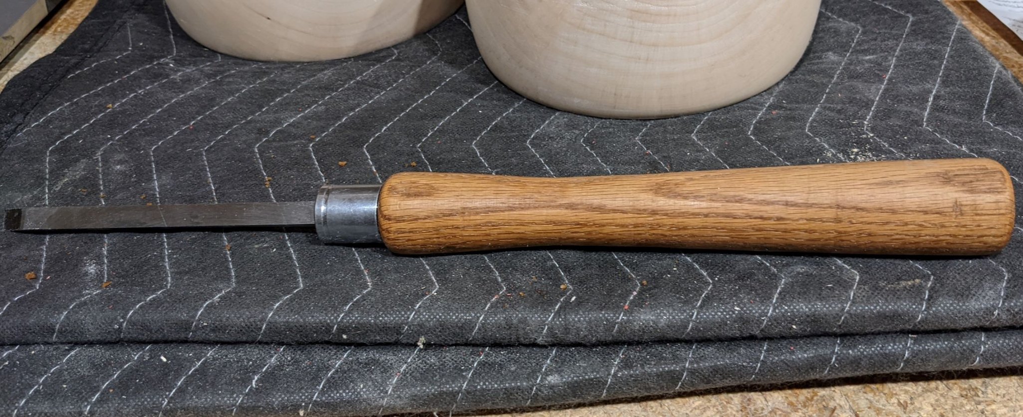

Just last month I purchased a 3/8 (10 mm) Beading and Parting tool from Robert Sorby, through Amazon. The HSS tool came without a handle, so I turned one of oak, and used an inexpensive 11/16 socket from an old set as the ferrule. Stuck it all together with epoxy and it works great. I believe it is possible to buy pretty much any tool that Robert Sorby offers without a handle, although this is the only one I have done that way so far.
B & P Tool .jpg (379.72 KiB) Viewed 2383 times
