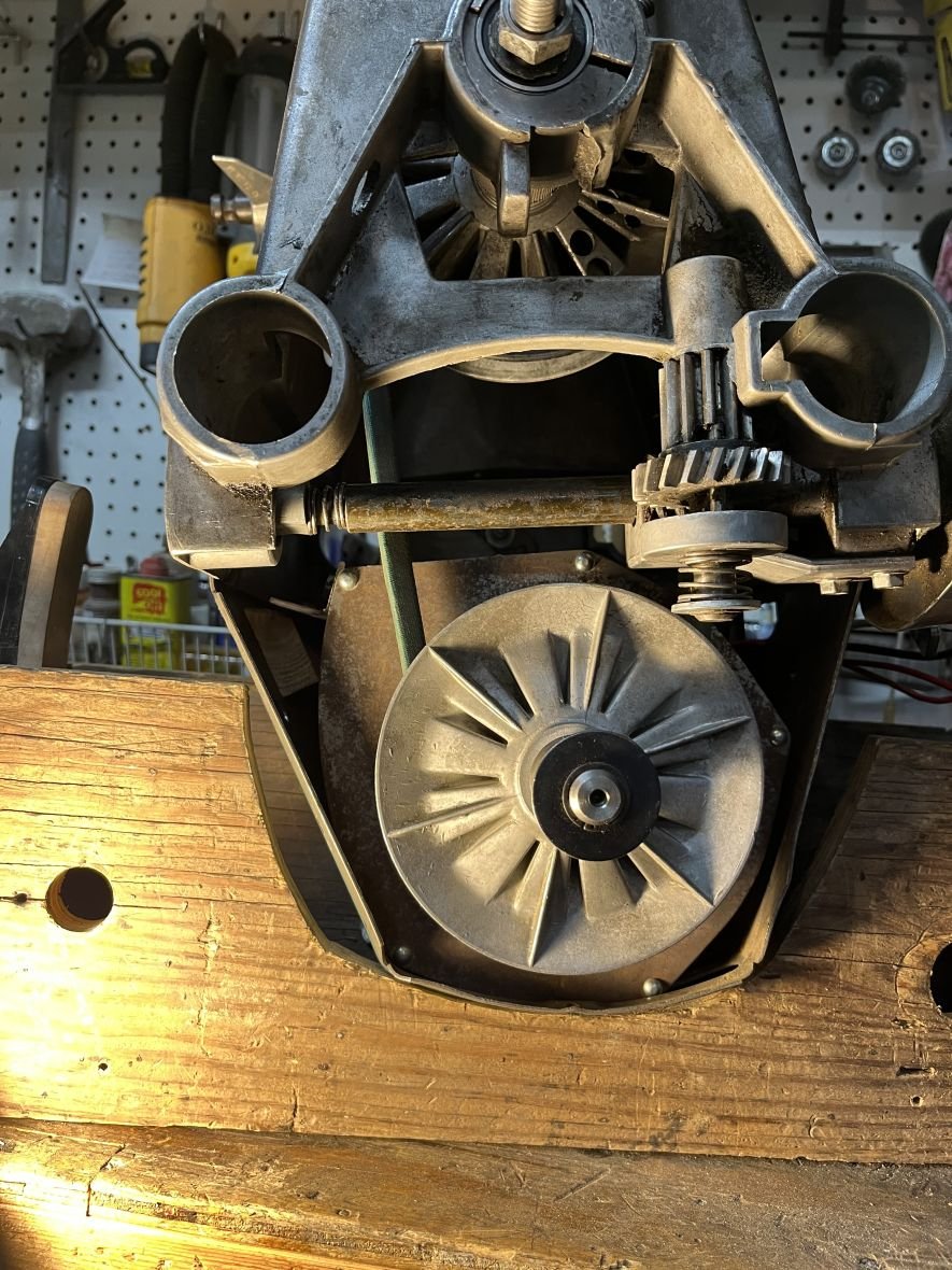

Well, things are not going swimmingly with the rebuild of Pollux. I got the inner race off my intermediate shaft, and the shaft is a mess. Where the two bearings ride, the shaft is ground down about 50-70 thousands in the grooves where the bearings should ride. These bearings have been grinding into the shaft for a long time. The C clip was also missing so one more thing to resolve.
All is not lost however. I have a hard chrome shop in town, and I will get the shaft to them to build back up and grind back to standard 5/8". I had them do one of my aircraft gear strut legs and it came out perfect. I know it can be done, just have to get on the ball and take it down there.
Unless, someone has a spare intermediate shaft for a Mark VII. Hmmmmmm I have no idea if it's the same shaft for a Mark V, but if so, maybe I can find one here online. Hmmmmmm

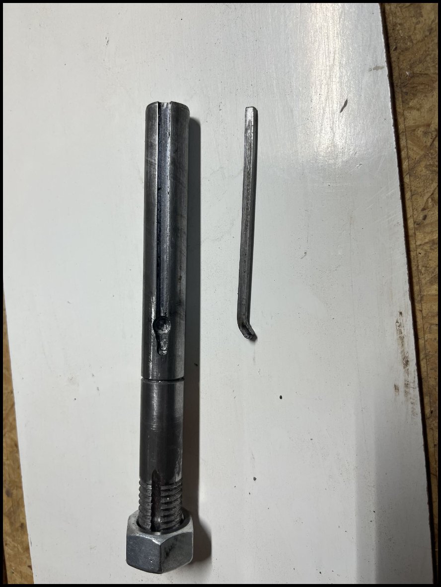

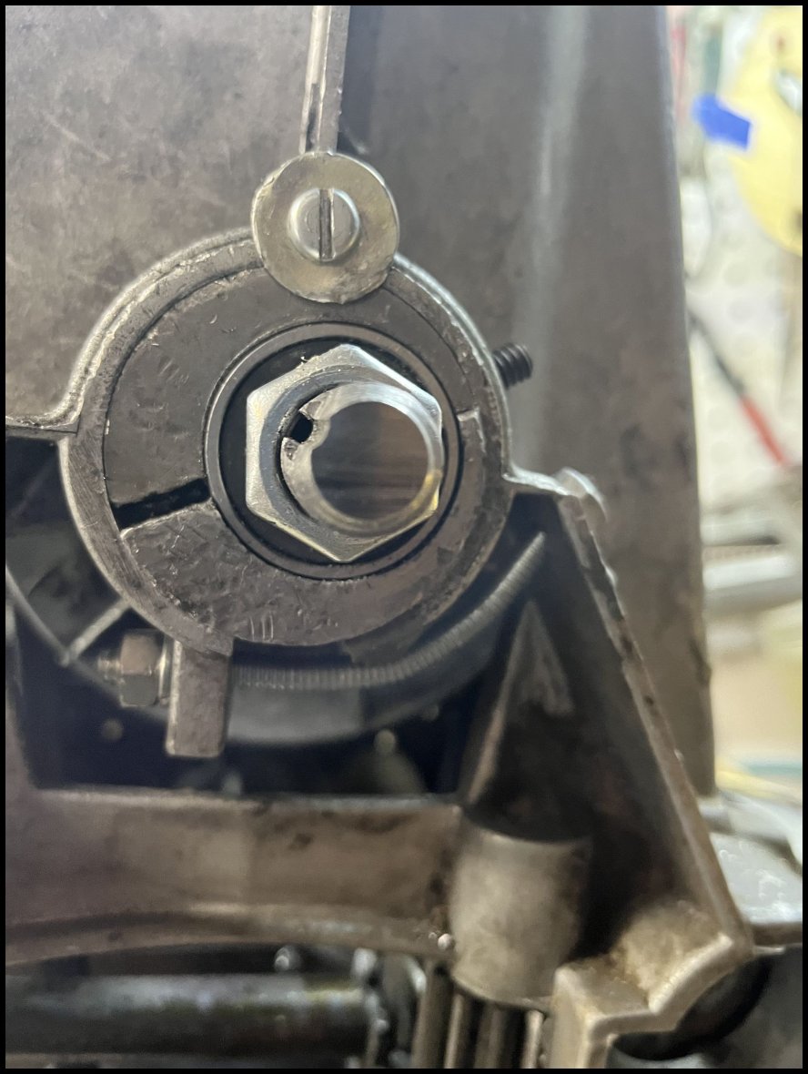

I thought I took a picture of the shaft after turning and threading but can't find it. I cut the shaft off an old motor armature that already had a keyway. I think it was from an old Mark VII motor. I had to turn it down slightly and thread it. I'm still working on the headstock.
It was trashed when I got it so no loss but my time. Going to the bearing shop to see if they have a bearing retaining ring for the upper shaft and tabbed locking washer for the idler shaft.

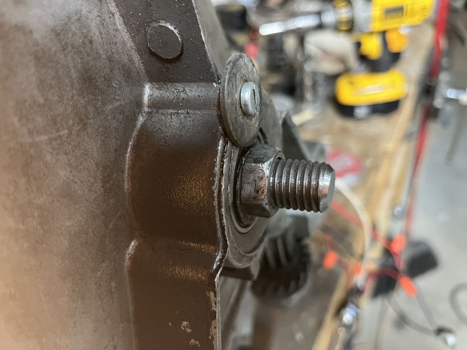

Edit 3/5/2022: Here is another shaft from some round stock that I threaded 11 threads per inch so I could get another nut locally. The original was 12 threads per inch I believe. I added a wraparound bolt to hold the idler shaft.

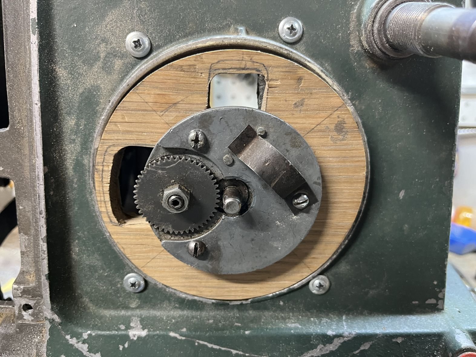

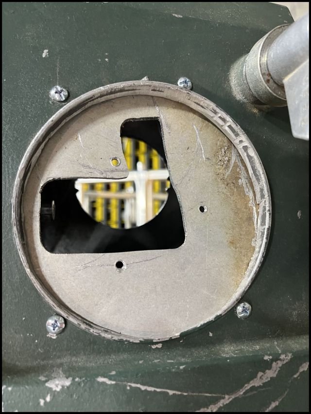

This will be a Mark VII (sort of headstock) with a reversible GE motor from a Mark V and a Mark V speed control.

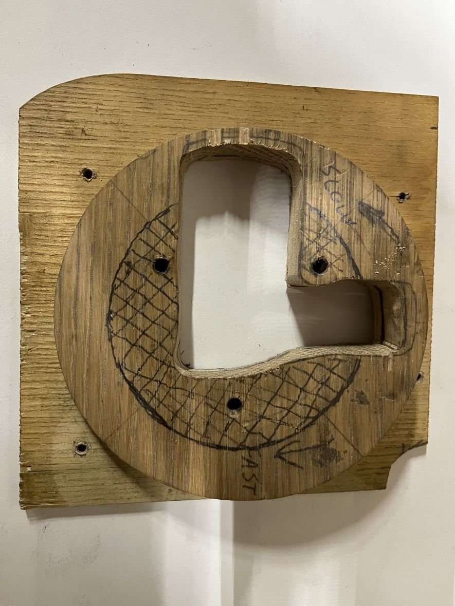

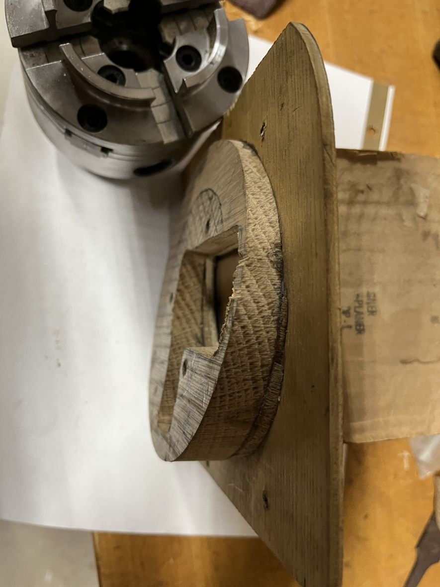

Edit 3/5/2022: Currently a wooden prototype insert with an aluminum 1/8" thick plate.
Tried pouring an aluminum insert but my green sand was to moist and it didn't turn out.
I left out 1/3 of the hole that would be in the Mark V headstock. The speed control fits fine through the other two. Is this going to be an issue that I'm not seeing?
