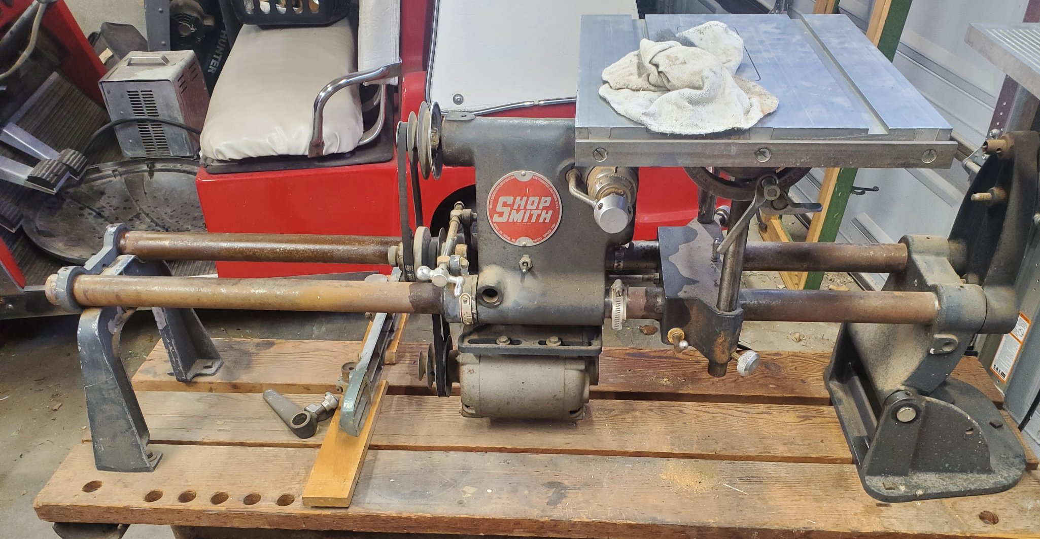

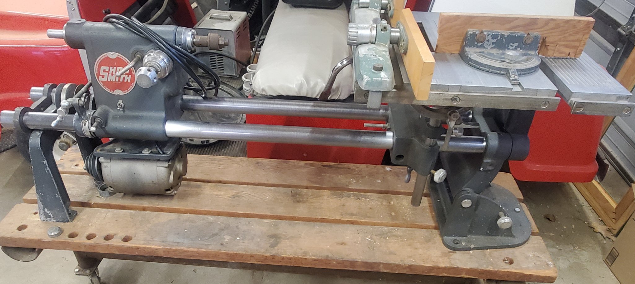

Well, I'm pretty much ready to fire it up. I have headstock and quill bearings, lathe centers and a wedge lock that should be here Wednesday. I still need a rip fence and a tool rest
Here's what I did:
Disassemble everything.
Clean, polish and wax way tubes.
Clean, polish and wax everything that slides on the way tubes.
Disassemble and clean motor.
Disassemble, clean and lubricate speed changer
Rewire and ground motor
Clean polish and wax table bars and the holes they slide in.
Disassemble headstock and remove all bearings
Clean quill and quill lever assembly
Reassemble everything except the Headstock.
FWIW, I think I should be able to claim rebuilding 3 of these. That's how many times I've taken it completely apart over the weekend.
Before and after pics below.

Re: 10ER questions. New to the group
lookin better!!!
- Posts: 4536
It is looking much better.
Good job, it’s looking almost usable. And you have the key missing pieces coming. You should be using it this weekend, depending on whether you had the time to install the final hardware. Enjoy.

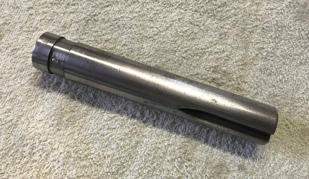

I look forward to seeing it when it is finished. Are you still looking for a Rip Fence and a Lathe Tool Rest? Do remember you can use any of the four versions of the Rip Fence although I do not recommend the original (first) one that did not have a rear lock. As for the Lathe Tool Rest assembly any Model 10 be it from a 10E or 10ER will work and unless you get the original 8" two-piece rest, the single casting 8" tool rests are pretty much the same. Even the 8" tool rest made today is pretty much the same. Only a bit of a difference between the early and later arms and posts. For use I do like the posts that have the machined indent for the arm's set screw as shown below.
