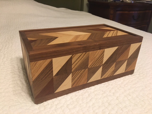

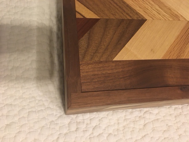

This might be a bit off topic and the easy way out, but several years ago when I was struggling with table saw miters I stumbled on a post by sehast where he mentioned that he had moved to "lapped miters" (viewtopic.php?p=248758&hilit=infinityto ... ed#p248758). I ordered up the same bits he recommended and have never looked back. What I like about this approach is that if you mill your lumber properly -- square, uniform thickness, width and length -- the joint is foolproof. I'm pretty good at milling lumber so it works for me. I also like it because I can reliably make a long joint (say along the length of a box).
I've used this approach on both cabinets and boxes. I've attached a couple of pictures from a box that my daughter and I built a couple years ago where we even used it to make the sliding lid of the box. Worked great!

Re: Miters or cross bevels on long stock
That's a gorgeous box, Erik!
