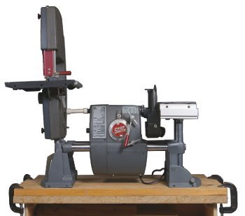

I am ready to put together my sanding station shop deputy. Occasionally I may replace the belt sander with my band saw. I'll be cutting down 34 inch tubes. Since I am not cutting a tube in half, do I cut them to the 26 inch or should I go a little bit longer? Would having a bit more room make set-up easier?

Below are pictures of the Shop Deputy from the Shopsmith online catalog to give you an idea of how it looks with the 26" Shop Deputy Way Tubes.
