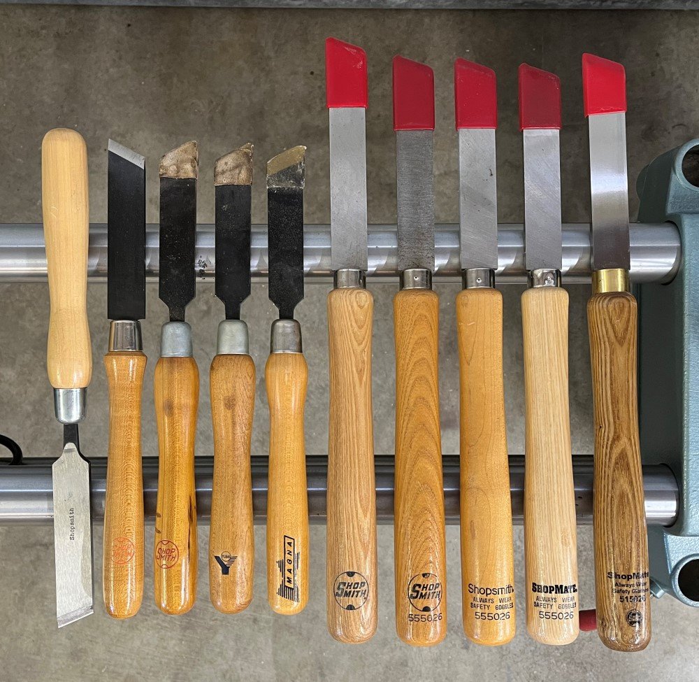

Time for a little Lathe Chisel History.
The set you show in your last post is the standard set of 5 and versions of them have been sold since the beginning with the introduction of the Model 10E in 1947. There were five early versions (1947 through the 1960's) which included a 1” skew, ¾” gouge, ¼” gouge, ½” round nose & ½” parting tool and only came in sets. These were the same chisels with 4 different labels and 2 different handle styles. With the reintroduction of the Mark 5 by Shopsmith Inc. in 1973 there was a different set of the 5 standard Chisels. These include a 1” skew, 1” gouge, 3/8” gouge, ½” round nose & ½” parting tool and are longer than the earlier versions. Individually they were part numbers 555026, 555027, 555028, 555029 & 555030 which later changed to 515026, 515027, 515028, 515029 & 515030. These Chisels were the same except how they were labeled and a small handle difference on the last version. They included the Shopsmith Logo, name or the ShopMate name like yours. They continued until 2017 when Shopsmith replaced their Chisel set with an 8-piece set from Savannah Woodworking Tools & Accessories.
Now for the ones numbered 555031, 555032, 555033, 555034, 555035, 555036 & 555037. The 7-piece completer set included a ½” Skew (555031); ¼” Skew (555032); 5/8” gouge (555033); ¼” round nose (555034); ½” spear point (555035); ¼” square point (555036) and ½” square point (555037). These were sold for a time and had the same labeling as three of the standard 5-piece sets.
The above sets were not the only ones that have been sold for the Shopsmith tool. There was a Carbide Tipped Lathe Chisel set of 4 that originally came out during the Model 10 production. It included two round nose chisels (1/8” & ¼”) and two square nose chisels (1/8” & ¼”). There have been other sets like the mini chisels and the pen turning sets.
Below is a picture of the 10 different Lathe Chisels.

So there you have Shopsmith Lathe Chisels 101.
EDITED to add the picture and correct numbers

Dang... that is good information indeed... I know the 5 I just ordered looked wider than the 7 set I got with it. More tools to figure out how they work.
101 much appreciated indeed.

chapmanruss wrote: Thu Jul 14, 2022 1:07 pm Time for a little Lathe Chisel History.
Nice collection that is obviously cared for well. I know I have a collection and depending on the choices I will likely find I am missing things and get preferences over time.
