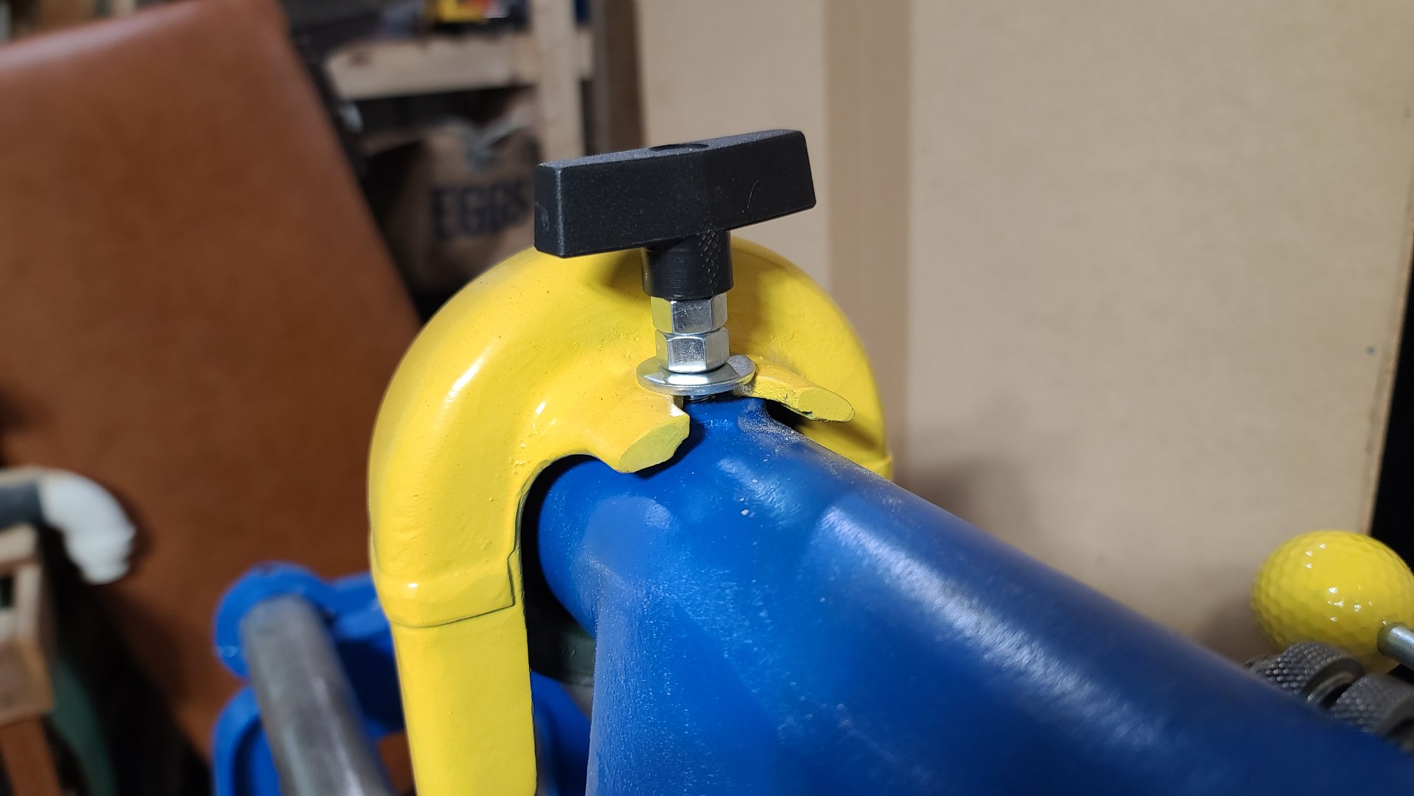

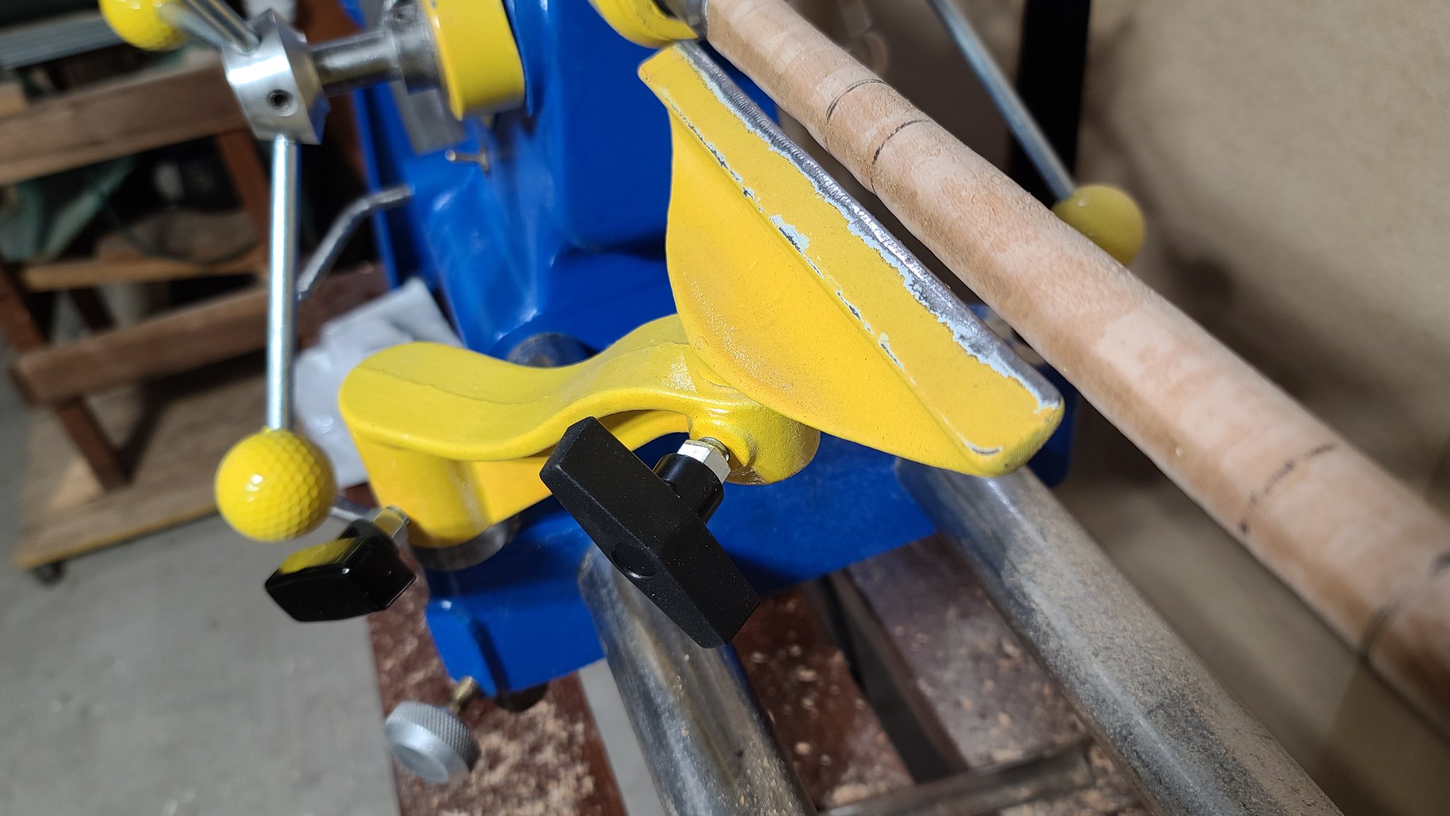

More minor upgrades today

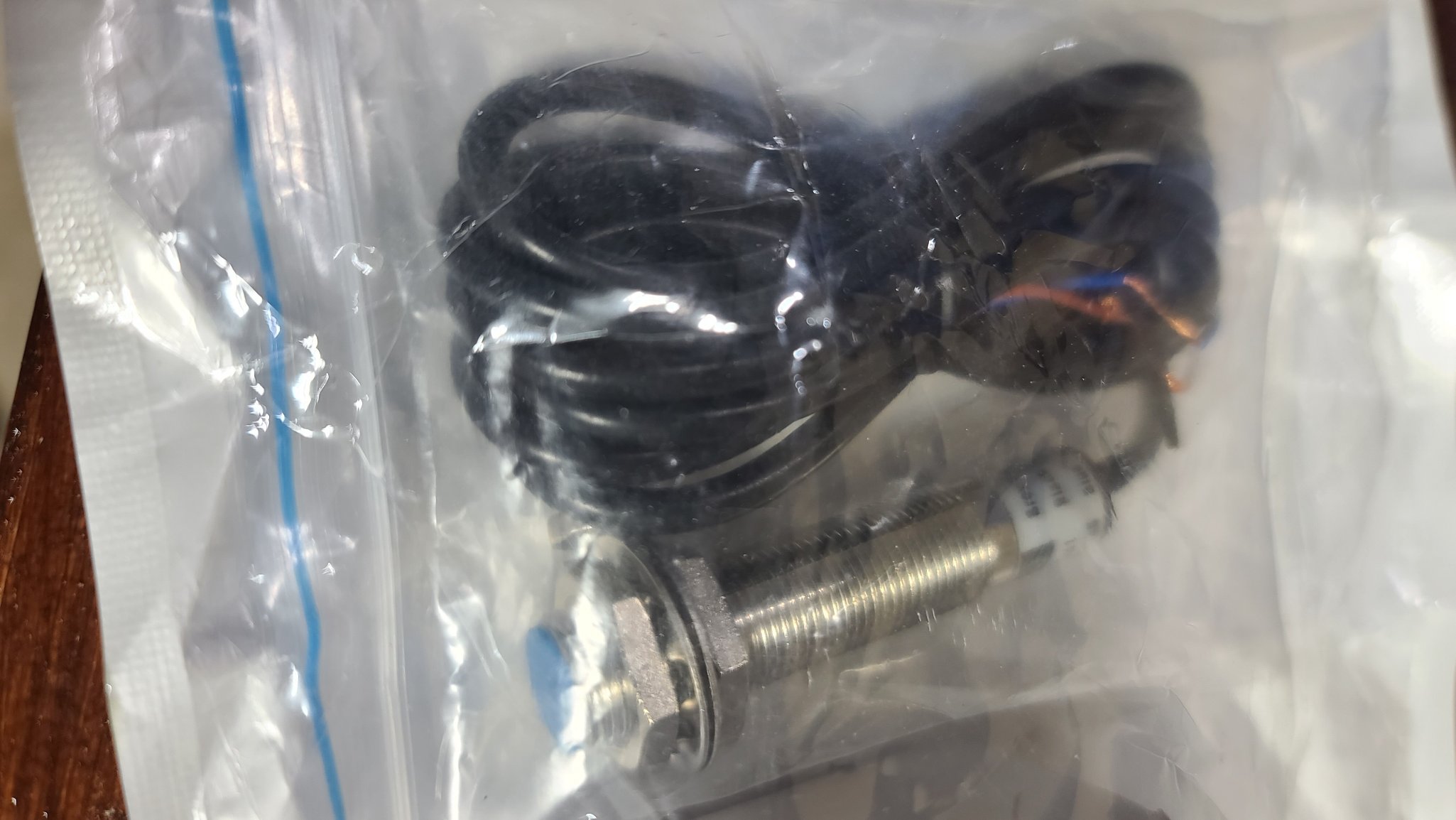

Quick release handles for the tool rest make adjustments much easier. Another one for the belt cover for changing gears. And finally an rpm display that i will install at the back of the motor. I am.still looking for an autotransformer to fine tune the speed as needed.

Re: I Just Purchased 10E Number 143
Hi Joel,
Looks like things are coming along nicely. Can you tell me where you got the RPM display and how exactly it works/hooks up?
Hi Darren, and thanks.
I got the rpm sensor from Amazon. This one is barebones and a little tricky to hook up, but basically there is a small magnet i am going to glue to the gear on the back of the SS headstock. Then drill a hole in the headstock to mount the sensor right where that magnet will spin past it.
Then the display will need some kind of little mounting box where i can see it, and everytime the magnet passes the sensor it will display how many times per minute it is going by on the gear (rpm)
It will also need a small power adapter.
EEEkit 4 Digital Red/Blue LED Tachometer RPM Speed Meter + Hall Proximity Switch Sensor NPN Led Panels Digital Led Module https://a.co/d/3eCN4Eq
