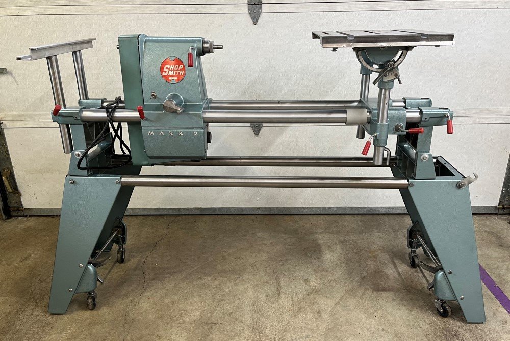

Hi everyone, I just got a Mark 2 from my Uncle last weekend. I think almost everything is there except the motor, mount, and pulley (and the belts). He said they were stollen several years ago and he never bothered replacing them. From what I’ve read, I know this isn’t really a good model but I don’t do much woodworking and this used to belong to my Great-Grandfather, so it would be nice to get it up and running. Does anyone have or know where I could get the parts I’m missing?? Thanks in advance!

Welcome to the Shopsmith Forum. I can help with any information about the Mark 2. That was my last Shopsmith restoration which is shown below. The picture does not show all the items that were included when new.
_ .
Since they were not very popular, parts for them are not as commonly found as those for the Mark 5/V or Model 10E and 10ER. The motor was a 1/2 or 3/4 HP motor which does not have to be a specific brand. There is currently the Apron the motor mount attaches to with the motor mount for sale on ebay at the link below. Since parts don't come up very often, I included the link in case you are interested.

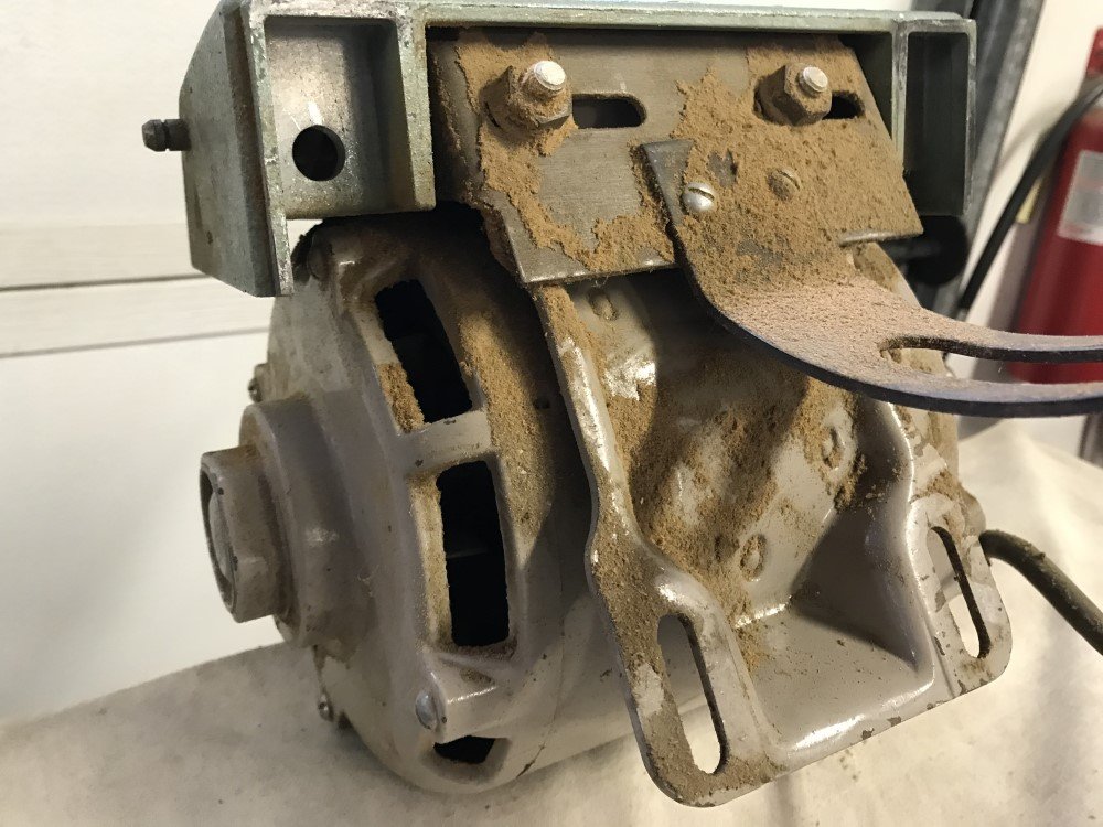

The other listing for a motor mount is not a Mark 2 part but is the mounting bracket for a specific motor. The picture below is a motor mounted on the Mark 2 bracket. The bracket is attached to the Apron and note the motor mounts only by one side with two bolts. The curved part goes up into the Headstock to the motor height adjustment to raise and lower the motor for belt changes. Sorry it is so dusty, but this was taken as it was being disassembled for a previous post.
_ .
Not just any motor can fit the Mark 2 as the mounting attached to the motor and how much the shaft protrudes is important. The motor shaft needs to lineup in the correct place for the motor pulley and the Headstock pulley to align. A motor that is too large in diameter will not fit. It needs to be a 1725 RPM motor. The motor in the picture above is a Powr-Kraft from Montgomery Ward and I have a Magna motor made by GE that is on the restored Mark 2 in my previous post. I do have a second Mark 2 yet to be restored.
