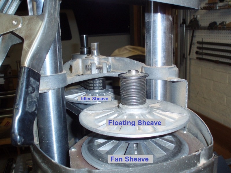

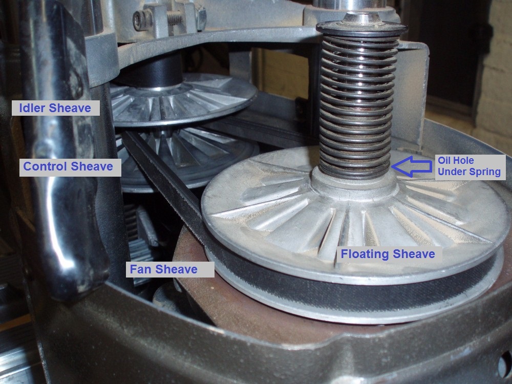

I have one and dropping the belt cover in vertical isn't hard.
You can even run the table in from the opposite side after you get it vertical and work from that perspective if you need.
Lubrication holes if missing can be added or new control and idler sheaves etc.
The fact that with newer machines Shopsmith dropped the extra mounting screws allows you to back off on installing as many. Just run in the extra screws and bottom them out against the headstock, then the belt cover will slide over them somewhat like a locating button.
Removing two screws and going vertical ever so often isn't a big deal, and if you have big hands, the inspection port may leave you with less working room than you would like anyway.
In that position you can easily pop off the belt to make sure it is near ½" wide and not worn, plus manually moving the floating sheave and control sheave through their ranges, after popping off the retaining clip.
As noted above, you can take out the speed control, so you can inspect the teeth on the dial and ring, as well as the worm gear and quadrant.
It's my preferred method of inspecting and lubricating on the later headstocks as well.
I have attached two photos from Dusty that I labeled and included in the Buying a Used Shopsmith Revisited document last year that illustrates the access I prefer. The number is the post number of the thread they came from.
If something needs attention, you are right there to do it, or inspect further, clean out the headstock cavity etc.
Everett
