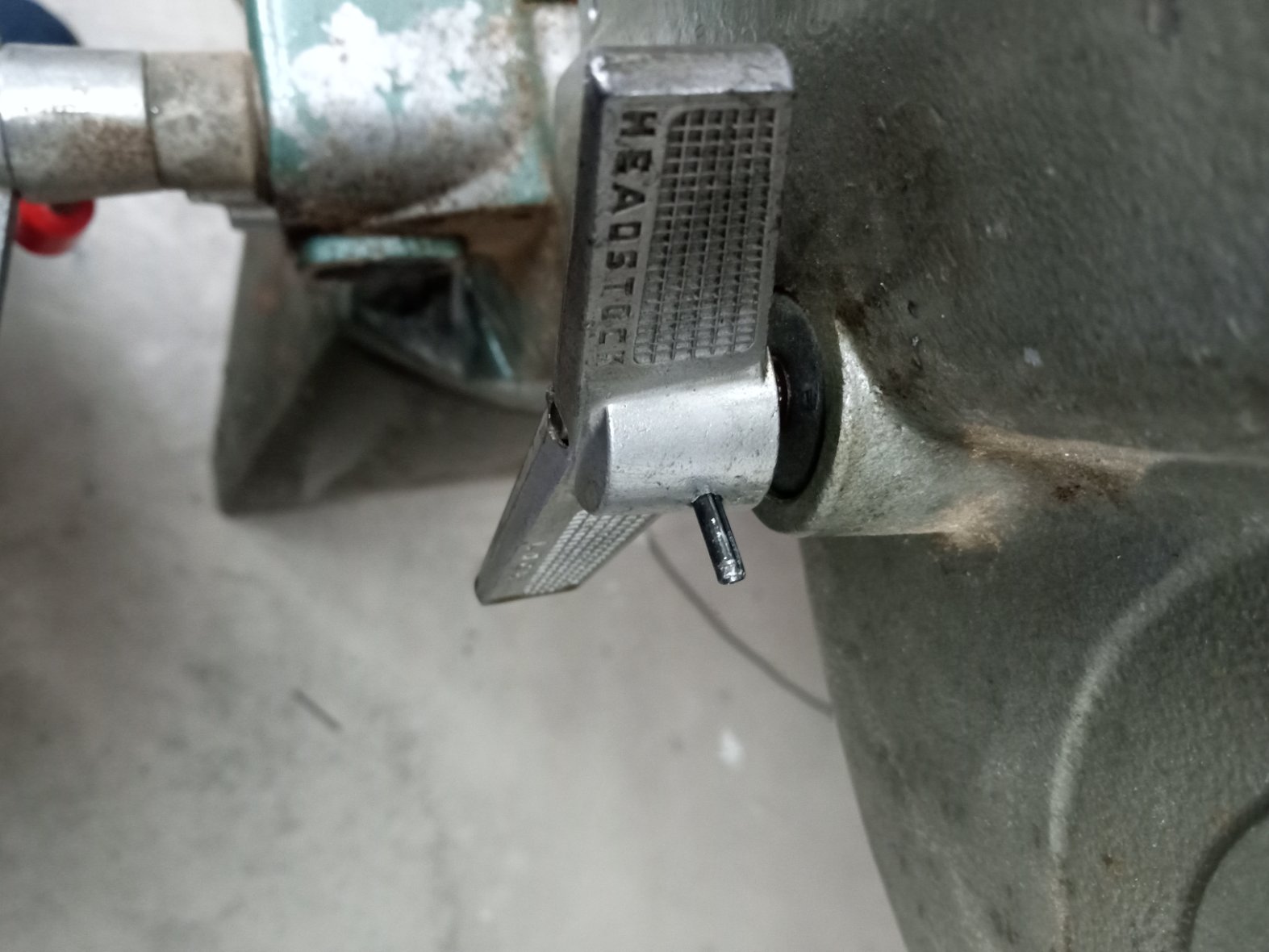

A method to remove the blind pin is to drill a very small hole through the tension pin (hollow center) all the way through the handle. Then drill back from the newly drilled hole to the internal end of the tension pin(sized to match the original hole od).

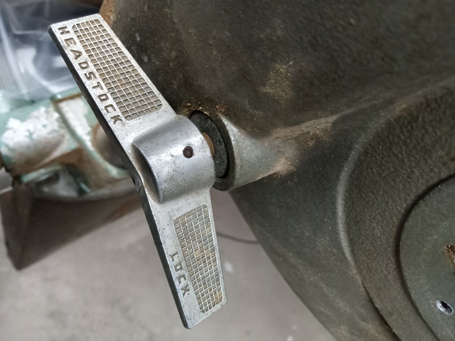

Head Stock Locking Mech could be a struggle to remove

My B 2702 case did NOT come with the head stock lock, I might be able to buy it from the seller that parted it our

I assume splitting the shaft and welding in a coupler to re-assemble is what you are referring to DLB? I have a mig welder and fully capable of managing that operation if its the best solution. I will have to sort of the Pin that is being mentioned to understand its process.

The entire headstock lock assembly doesn't cost much. Cutting the shaft and removing the wedge locks harder to get done right than it looks. You need a removable lock handle and removable wedge locks to service the machine. Might as well start with fresh parts. To get the old ones out you can cut, drill, or whatever. The wedge locks may be good and worth saving because new ones cost almost as much as the rest.DaOldGuy wrote: ↑Wed Aug 17, 2022 5:37 pm I assume splitting the shaft and welding in a coupler to re-assemble is what you are referring to DLB? I have a mig welder and fully capable of managing that operation if its the best solution. I will have to sort of the Pin that is being mentioned to understand its process.
Welding the rod back together after cutting it is an option to replacing the parts. I like JPG's recommendation better and would try that first IIWM, because end state is a 'normal' lock handle with the hole drilled all the way through. It makes it removable later if needed. It is also possible that a PO has already been through this and you have access to both ends of the pin and can drive it out. (Note - on my '57, this hole goes all the way through and is almost certainly original. So the change we are talking about here was early in production.)

I haven't restored any "A" Headstock Mark 5's so I do not know if these parts are different. The Greenies and Goldie I have done all had the Headstock's Way Tube Lock removed during restoration. The pin for the lock handle went all the way through on those "B" Headstocks. The only challenge reassembling them was getting the hole lined up in the handle and threaded rod to reinsert the pin.

The information is per the full length PowerPro DIY Video, Jim McCann, starts around 19:20. He refers to "very early" headstocks, doesn't mention a specific version. https://youtu.be/xCLkH6T1uQE And of course, some of those early headstocks will already have been reworked for repair or refurb of the locks themselves.chapmanruss wrote: ↑Thu Aug 18, 2022 2:38 pm I haven't restored any "A" Headstock Mark 5's so I do not know if these parts are different. The Greenies and Goldie I have done all had the Headstock's Way Tube Lock removed during restoration. The pin for the lock handle went all the way through on those "B" Headstocks. The only challenge reassembling them was getting the hole lined up in the handle and threaded rod to reinsert the pin.

Thanks everyone for the good replies. I was a bit concerned about the "pin" until I seen what it was.
Roll pins can be a PITA bit of hardened steel, but fear not. Soak a bit of the PB nut blaster. Find a harden punch that will fit the hole in the handle but not fall inside the Roll Pin. Once something goes inside the pin and wedges, it just widens the pin and forces it to lock into the soft aluminum or steel.
The threads on the rod are all happy, not a lot of rust, so I am happy to say no parts needed. From the prices listed and shipping that saved 50 bucks
