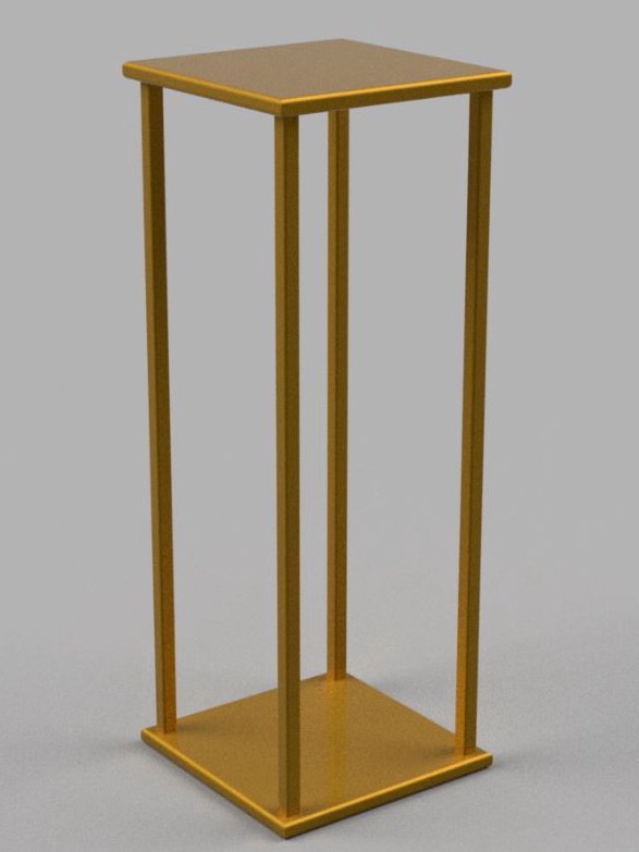

The two tall stands were to have 48” long legs, and the 10 shorter ones (shown in the rendering above) were to have 32” legs. A Shopsmith in horizontal-boring mode was the obvious choice of machinery here, so I ordered up a 5/8” CMT plug/tenon cutter bit for about $30.

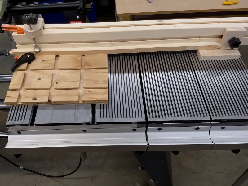

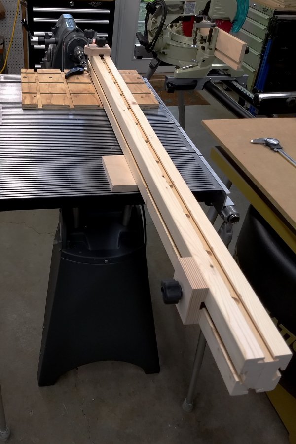

To locate a positive stop for those 48” legs, the new end-working fixture was obviously going to need some serious length. The key component is a fixturing beam that I made by doubling up a couple of salvaged 2x4’s and milling WoodAnchor fixturing slots in the faces. Then I made three different adjustable attachments for the beam: a length stop, a vertical workpiece hold-down, and a simple foot that doubles as an outboard support for the workpiece. Here's a shot of the assembled fixture.
This application uses only three of the four fixturing slots that I milled in the beam. But I wanted the beam itself to be a general-purpose component, and who knows what I might use it for in the future. One likely application is to mount it horizontally above an assembly table, and use multiple vertical hold-downs for applications such as face-frame assemblies.

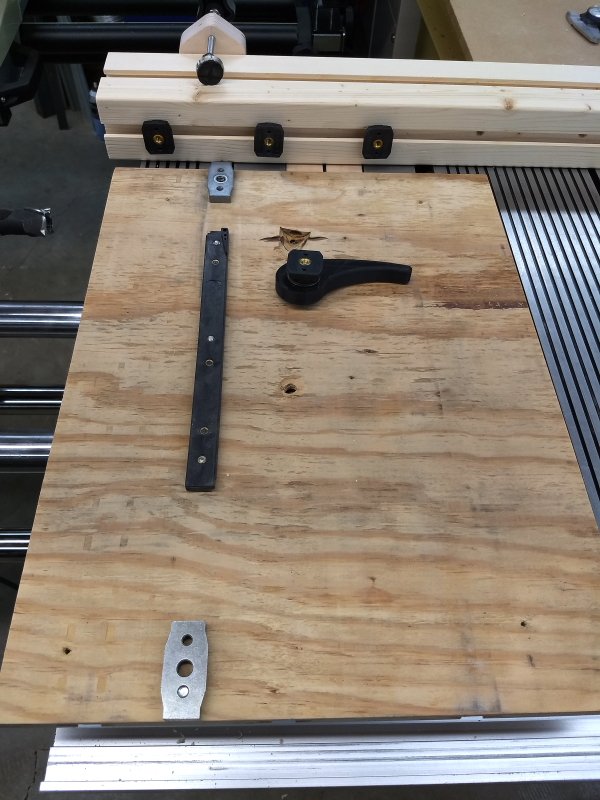

But back to the application at hand, I used my existing quick-and-dirty small-parts sled to mount the fixturing beam to my Shopsmith's main table. The sled has a MicroJig ZeroPlay miter bar installed on the underside, which captures the sled in the miter slot. For this application, I added a couple of Shopsmith T-nuts to the sled, in line with the miter bar, so that I could also lock it down longitudinally in the miter slot. Three countersunk through-bolts in the front of the fixturing beam thread into WoodAnchor nuts, which fasten the beam securely to the fixturing slots in the top of the sled. Here’s a shot of the sled’s underside, as well as the 3D-printed cam clamp that I used to secure the workpiece horizontally.
This arrangement worked out well, except that a Shopsmith T-nut really should be in the center of the sled, with miter bars on either side of it, instead of the other way around. As it is, to the prevent the vertical hold-down from rolling the beam a bit and lifting the center of the sled, I needed to F-clamp the front of fixturing beam to the underside of the SS table. But it worked just fine that way, and I can pretty it up when I get around to building a nicer sled.

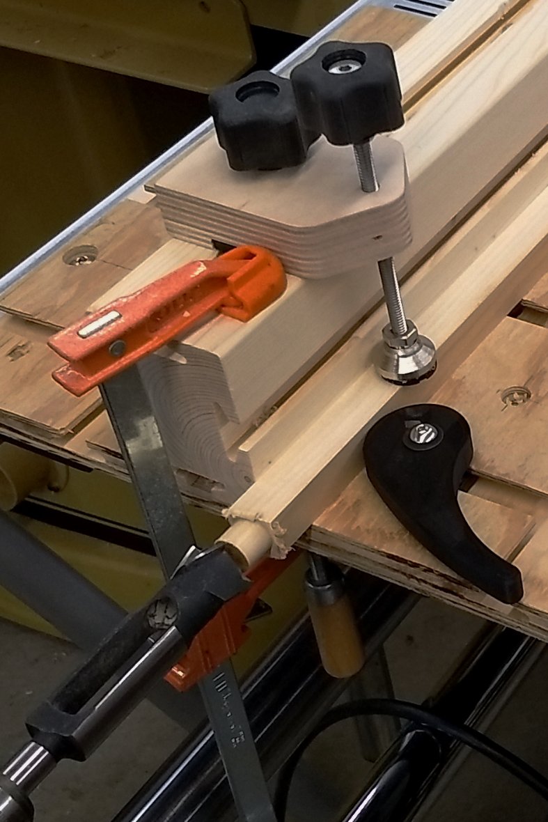

Here’s a side view showing the fixture fully assembled, with a workpiece clamped in place. The cam clamp conveniently mounts to an existing fixturing slot on the sled.
And finally, here’s a close-up shot showing workpiece clamping details and a freshly milled tenon. Check out the nice polished finish on that tenon!

No through-bores in the tops and bottoms, but Bill and I did decide to let the Forstner bit pilot poke tiny holes all the way through both the tops and the bottoms, to prevent hydraulic locking from the wood glue. Those tenons fit the bores like pistons, except a bit tighter. And these stands are basically just painted props, not fine furniture.
Regarding stand stability, we did considerable tippiness testing, and got good results with no added weights or bracing. Credit for that goes to the tight joints, and ultimately back to that CMT tenoning bit. Now I'm looking forward to using it for some real furniture projects.
The fixturing beam does look a lot like an 80/20 extrusion. Milling and gluing up the 2x4's was 90% of the work required to make it, as it takes only a few minutes to mill the fixturing slots. I didn't know it at the time, but my local Big Orange store sells 4x4x8' untreated Douglas fir lumber for $10, which would have reduced the beam-construction time to maybe ten minutes. In comparison, 3" square 80/20 extrusions cost about $2 per inch, so a similar-sized 54" long aluminum beam would have cost around a hundred buck, plus shipping. The other advantage of doing it in wood is that you can put slots exactly where you need them for a given application, instead of being limited to standard extrusion profiles. The downside, as you point out, is the possibility of warpage, although that could be mitigated by using an LVL beam. And of course, a wooden beam may not be strong enough for some structural applications.

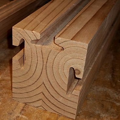

If I am reading the grain pattern correctly, I would have rotated one of the 2x4 180°.(both concave out(sorta))
- BuckeyeDennis
- Posts: 3812
- Location: Central Ohio
Re: Wedding-flower stands
I would have preferred that as well. I like really how rjent did the glue-up for his router fence. If you're lucky (or plan really well), the WoodAnchor router bit can neatly excise pith near the surface of a board, similar to Dick's board on the left in the pic below.JPG wrote: Mon Sep 12, 2022 11:29 pm If I am reading the grain pattern correctly, I would have rotated one of the 2x4 180°.(both concave out(sorta))
It's been a few months now since I made my fixturing beam, but IIRC one of the 2x4's had a surface defect that would have compromised the fixturing slot if I had turned the defective face to the outside. So I reversed it, and buried the defect in the center of the beam. But these particular boards had already been in my shop for about 10 years, as part of a shelf unit that I recently disassembled, so I wasn't worried about them suddenly developing new warps.

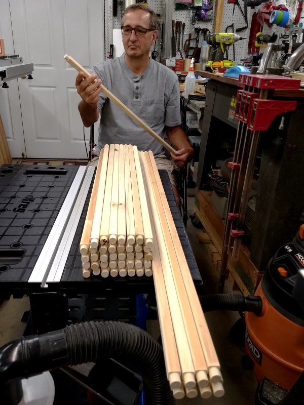

It took some time to make that end-working fixture, but it really paid off when Bill and I switched into production mode. A dozen stands means 48 “legs”, and 96 tenons. With the fixture, we were able to knock all those out in about an hour, with zero scrap.
Then it was time to clean up the edges. I used the SS drum sander and the shaper/sander fence to get rid of the curled wood fibers left by the tenon cutter. With the infeed fence set tangent to the sanding drum, all I had to do was feed each face of the workpiece just slightly onto the sanding drum. At eight end-edges per leg, that’s 384 clean-up passes! But the drum sander setup made pretty short work of that, also coming in at about an hour total.
The last machining operation on the legs was to put a 1/8” roundover on the long edges – all 192 of them. Which took another hour or two, using my SS overarm pin router in under-table mode. When finished, we had a sizeable stack of legs! In the pic below, Bill is finishing up the final QC inspection.
