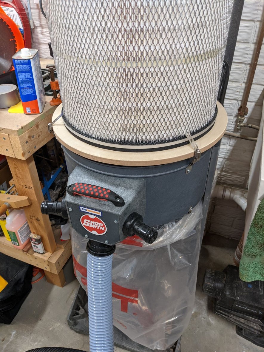

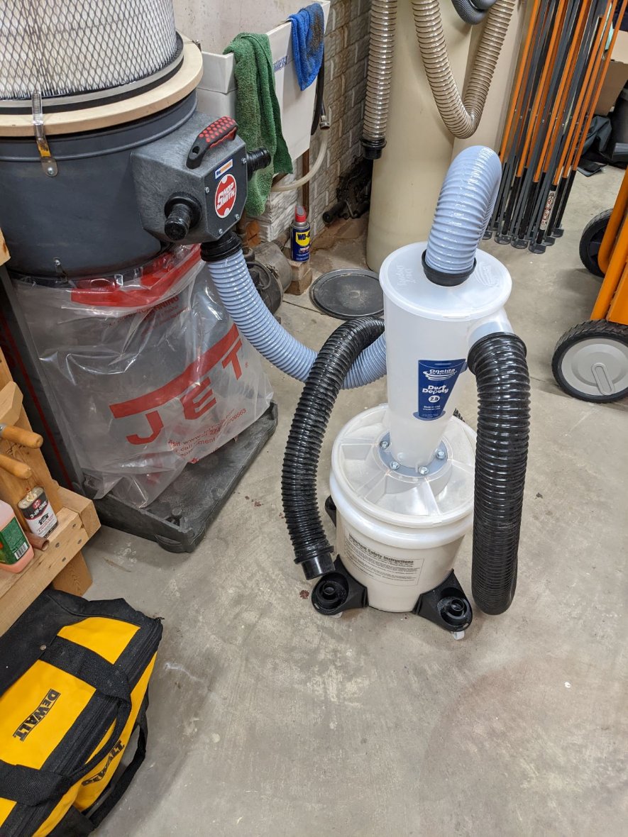

This thread helped me modify my DC6000 so I wanted to share pictures of what I did in hopes it will help others.
I did not do any pre or post measurements but qualitatively much better-Jim

nicely done.

Deicer wrote: Sun Sep 18, 2022 7:48 pm This thread helped me modify my DC6000 so I wanted to share pictures of what I did in hopes it will help others.
This is great. I major step toward "good" dust collection. Also - the dust collection bag. JET part number please. What is the diameter pf the bag?

Thanks hfmann and Dusty.
The Jet Bag was purchased from Amazon. Number 709563 20-inch diameter 5 pack. Seems to fit well.
Other parts are the previously referenced Wynn filter and clamps.
The wood circle adapter is 20-inch diameter 3/4 inch thick with 1 and 3/5 inch lip.
The weather strip I used to seal the top of the DC6000 with the ring was also from Amazon 1/2in x 3/8 in one side adhesive foam tape.(Trisiki)
And the cyclone Separator was the Oneida Dust Deputy 2.5
Jim

I did the same thing for my DC3300 (I think that's that the right model #) without the cyclone separator.
However, I had to put a sheet metal collar between my motor housing and the wooden flange.
