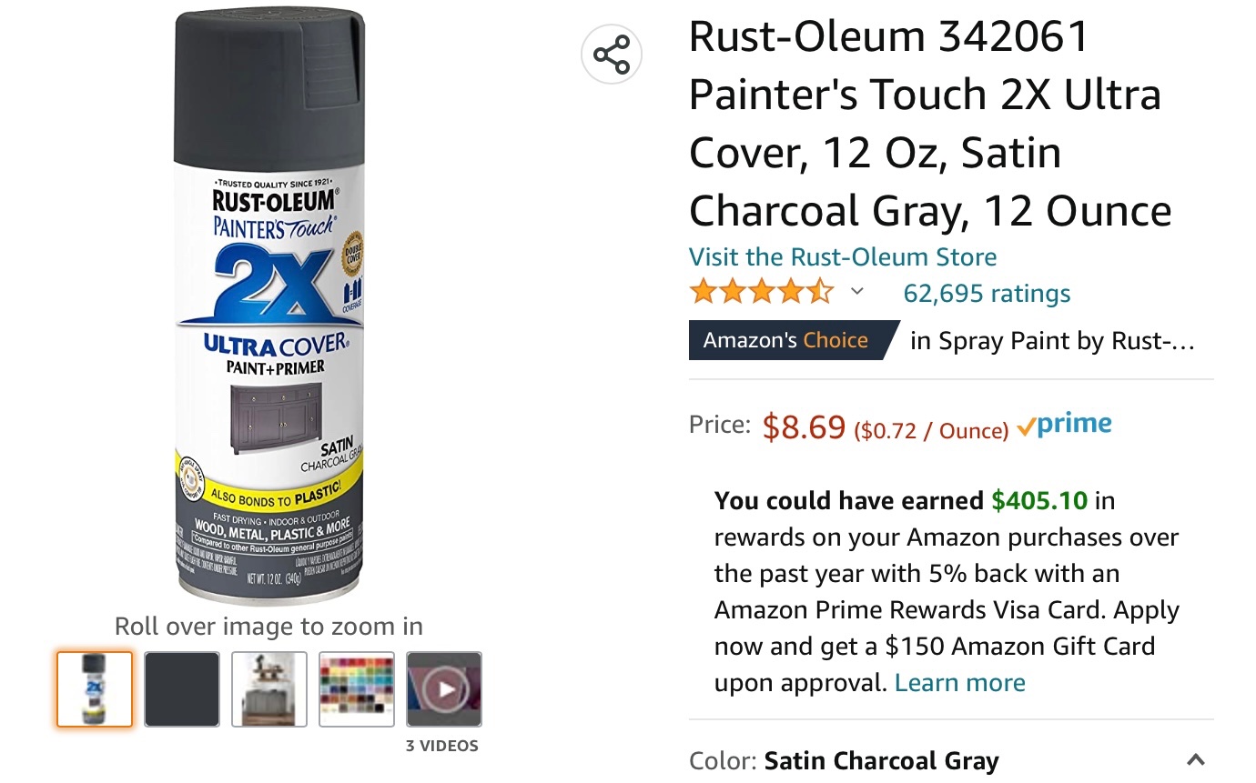

Re: update on Match for current SS gray paint?
I found a very, very close match to Shopsmith gray spray paint, and it has a satin finish. Shopsmith brand gray spray paint is so expensive especially with shipping costs. It’s Rustoleum Painters Touch 2X Ultra Cover Paint+Primer Satin Charcoal Gray. Not 100% exactly the same, but so close that unless the 2 are put side by side you or can’t tell the difference. And it’s only $8.69 including shipping on Amazon.
