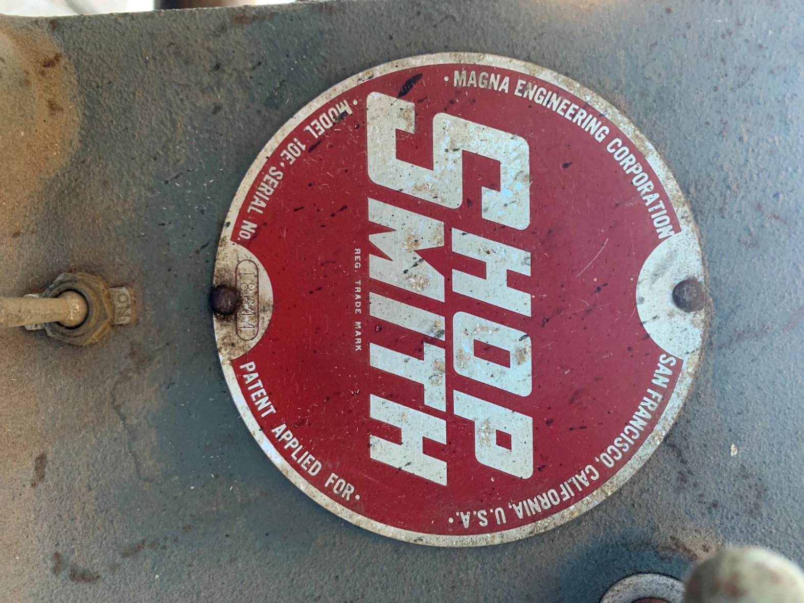

Just picked up a 10E - probably paid too much for it after reading up on it, but I got excited thinking it was a great deal.
Anyways - it has a lot of stuff with it, I'm not sure if it has all the parts, and I don't even know if the motor runs since the plug is damaged and I have to rewire it. The motor and power head turn freely with no noise.
Serial number 18644 - I know that probably won't put a date on anything, but if it does I would love to know.
I'll try to post pictures of the actual unit without all the 'goodies' that were included when I get a chance to take the pictures, but here's what I have.
Posts: 3495
Re: Just got a 10E
sossman76,
Welcome to the Shopsmith Forum and congratulations on your new to you Shopsmith Model 10E. Serial Number 18644 would have been made in 1948. I can't tell from the pictures if it has everything that originally came with it but there are some extras. The most notable extra is the Magna 4" Jointer Model 620 on the Special Jointer Mounting Headrest. That is definitely a plus and increases the value of what you purchased. A previous owner made a rear fence lock for the Rip Fence. I don't see the Upper Saw Blade Guard but the Splitter for it is there. The Wood Extension Table and Bracket it should have are not visible in the pictures. Some of the Saw Blades shown look a little big in the pictures. The Model 10E and 10ER used 8" Diameter Saw Blades. The condition of the power cord is not surprising. I replace the original power cords and switches on all my Model 10 restorations. The motor probably works but may need a little cleaning out inside. I have yet to have one of these old A. O. Smith motors fail. With less cluttered pictures we can help you identify items you may be unsure of. There are items that are not Shopsmith parts in your pictures.

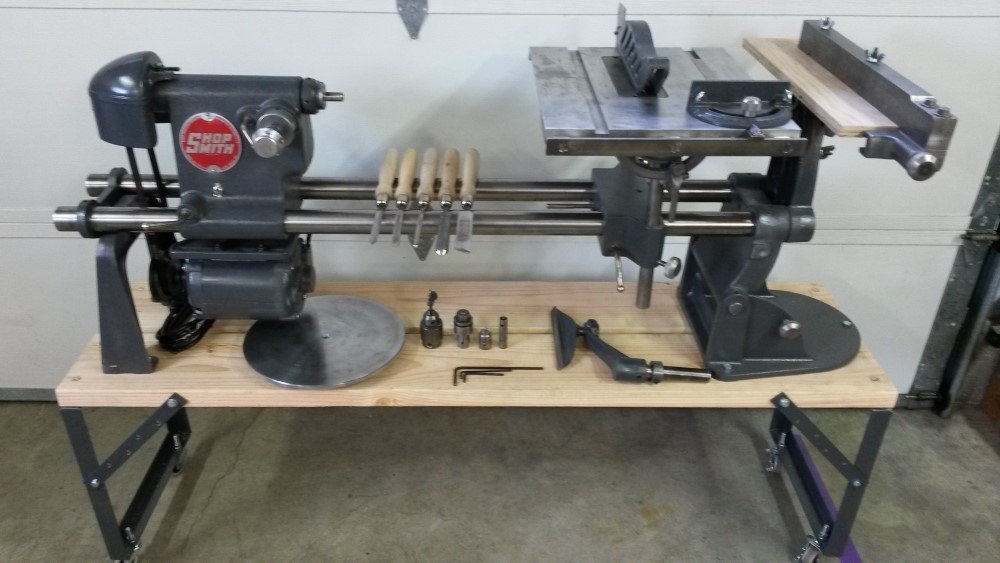

A Model 10E (S/N 19541) I restored that is near to your 10E is shown in the picture below. It is complete with everything It would have come with from the factory plus Lathe Chisels and on a bench.
