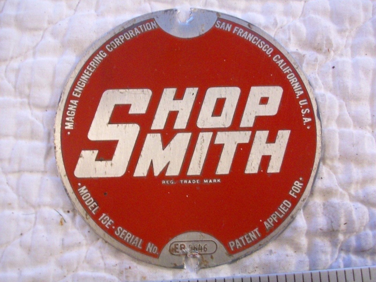

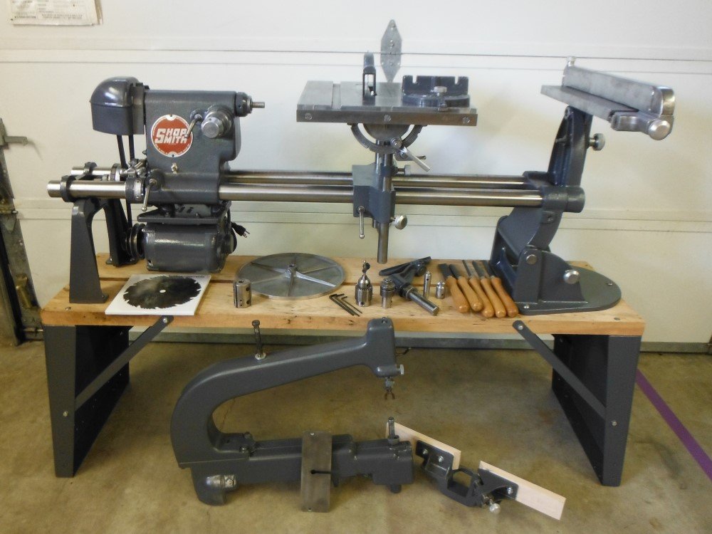

Re: ER7313-serial number
cstrasbaugh,
From the serial number ER7313 I am guessing the plate the serial number is on looks like the one in the picture below.
_ .
That is a Shopsmith Model 10E made in the late 1940's. It should look like this one I restored but may not have all the extra accessories shown.
_ .
If the above looks correct, we have identified your Shopsmith.
Now since your Shopsmith was made over 70 years ago it and has been stored for quite some time it could use some TLC to get it back to working condition. My first suggestion would be to evaluate the motor and bearings. First take the belt off and then try the motor running without any load. If it runs okay, it is likely the bearings in the Drive Sleeve Assembly and/or the Quill Assembly that need replacing. If it still trips the breaker JPG's suggestion may be a possibility. The motor may need a good cleaning out of saw dust. With the belt off turn the Drive Sleeve Pulley by hand. It should turn freely. With the Quill still in the Headstock you are turning all 4 bearings, 2 in the Drive Sleeve and 2 in the Quill. You can remove the Quill from the Headstock to check the bearings in both the Drive Sleeve and Quill separately. Unless the bearings are turning freely and smoothly, they should be replaced.
There are a number of threads here on the Shopsmith Forum that can help you with the process and you can ask questions here on your thread anytime. As already suggested picture do help in describing what you are referring to.
_ .
_ .
Do keep in mind the one in my picture is a restoration and I try to get them looking as close to new as possible. That is not necessary to have a good functioning Shopsmith tool.
Since it still has the original power cords and switch, I would highly recommend replacing them. This is a good time to add a ground to the power cords. In referring to power cords I mean the plug to the switch cord and the switch to the motor cord. Some motors have terminals inside to connect the power cord to while others have to be spliced to the wires inside.
Here is the good news and bad news about parts. First the bad news, since it is over 70 years old new OEM replacement parts for the basic tool are not available from Shopsmith with 2 exceptions, they are the Quill Spring and the Quill Bumper Ring which are still used in Mark series tools today. Now for some good news. Most parts are easily found used online for sale by people that buy old Shopsmith tools and part them out. Your Model 10E has the same size spindle end of the Quill and same Quill diameter as the current Shopsmith Mark series tools. If you need, for example, to replace a Lathe Drive you can buy a new one from Shopsmith through the online catalog here on this website. The only difference between the Lathe Drive that came with your Model 10E originally and the current one is the set screw size changed in 1954 and a black protective coating has been added starting in 1964.
If you don't have an Owner's Guide for your Model 10E check under the Maintenance and Repair section for Shopsmith Large Format Drawings, Illustrations and More by Everett Davis. This will be one of the first four topics. In it you will find a wealth of information on the Shopsmith tools. Some are directly linked there and others are on “My Google Drive” with documents too large to be directly linked. Everett has become the Shopsmith historian by saving and restoring manuals and other documents. On the Google Drive look under 10E and 10ER and there is a PDF of the 10ER Owner's Guide that would more closely represent your Model 10E. During their production there were many changes made to the Model 10E and 10ER which is why I recommend the Model 10ER Owner's Guide unless your Model 10E has the wood Extension Table instead of the metal one. The Owner's Guide will help you and your son-in-law understand how to use the Shopsmith Model 10E and the names of the various parts. The attached PDF below is an addendum to the Owner's Guide.
