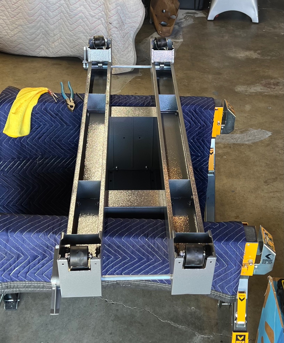

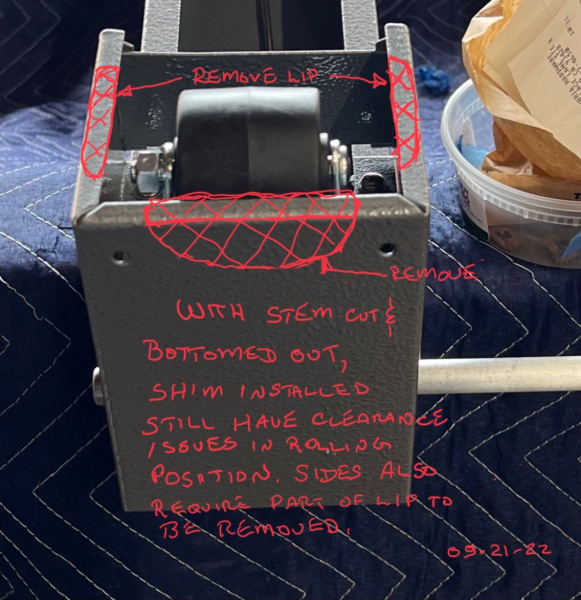

Casters, final answer. Comments good, bad or indifferent always welcomed and appreciated.

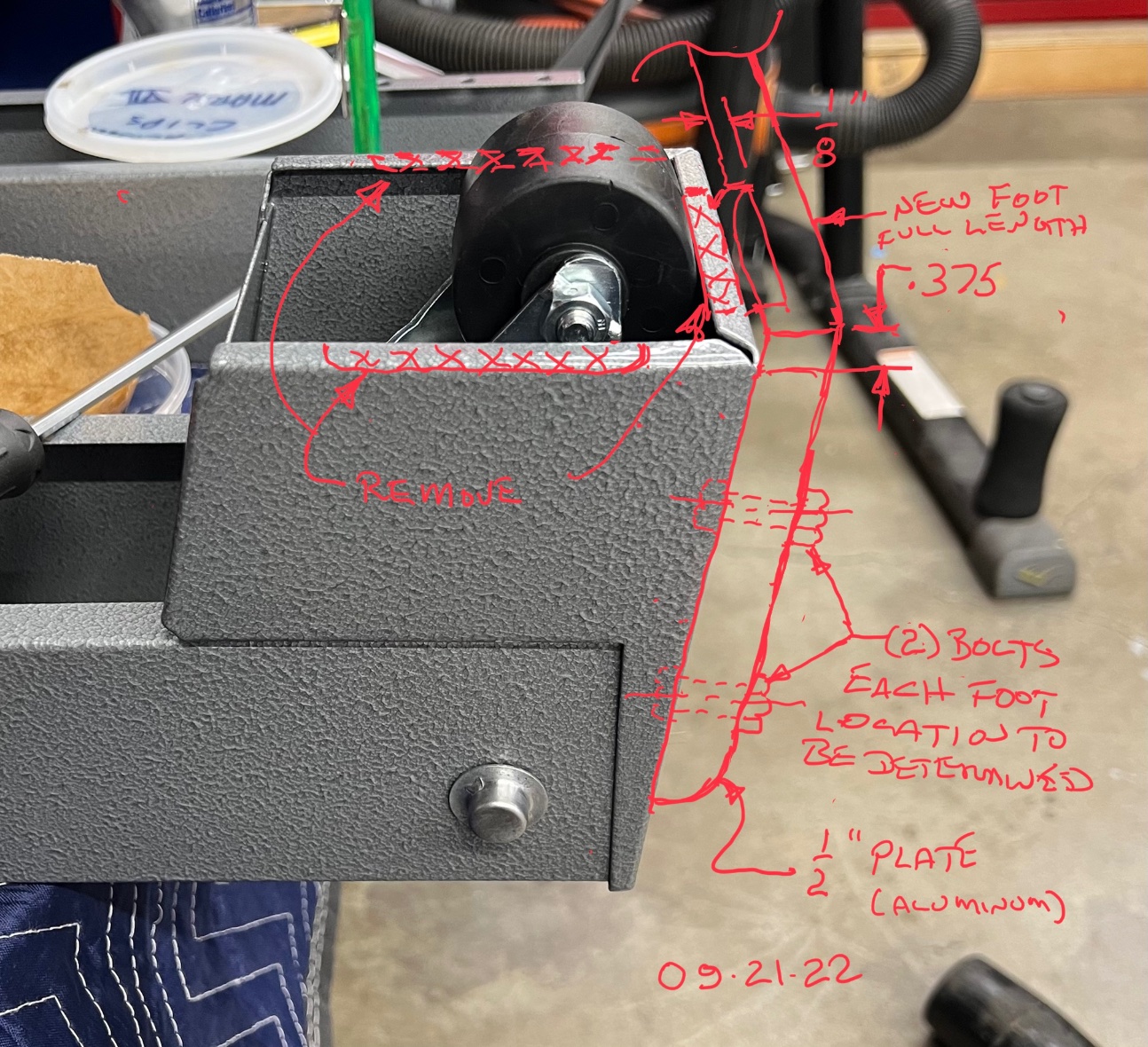

Hi Mike, you already know my position, I would try to make the wheels fit rather than modify the frame, but with that said, I think your approach will work. Just be sure that when the wheel is in its lowest position it can completely spin around 360 degrees without hitting the inside of the shoe or else cutting will be for nothing. You never know what position/direction the wheel will be in when you lower the machine and you dont want it to bind or get jammed up and not lower completely.

I appreciate all your input Mike and it has made me think this through more than a few times. I’m still not 100% and of course I have measured twice many times. The only issues are the lips on each side and the front of shoe. I want to make the shoe fit the casters not the casters fit the shoe. This way in the future it’s an easy fix to just replace the casters. Still thinking about it so cleaning parts for now, have plenty to do.:-) thanks again

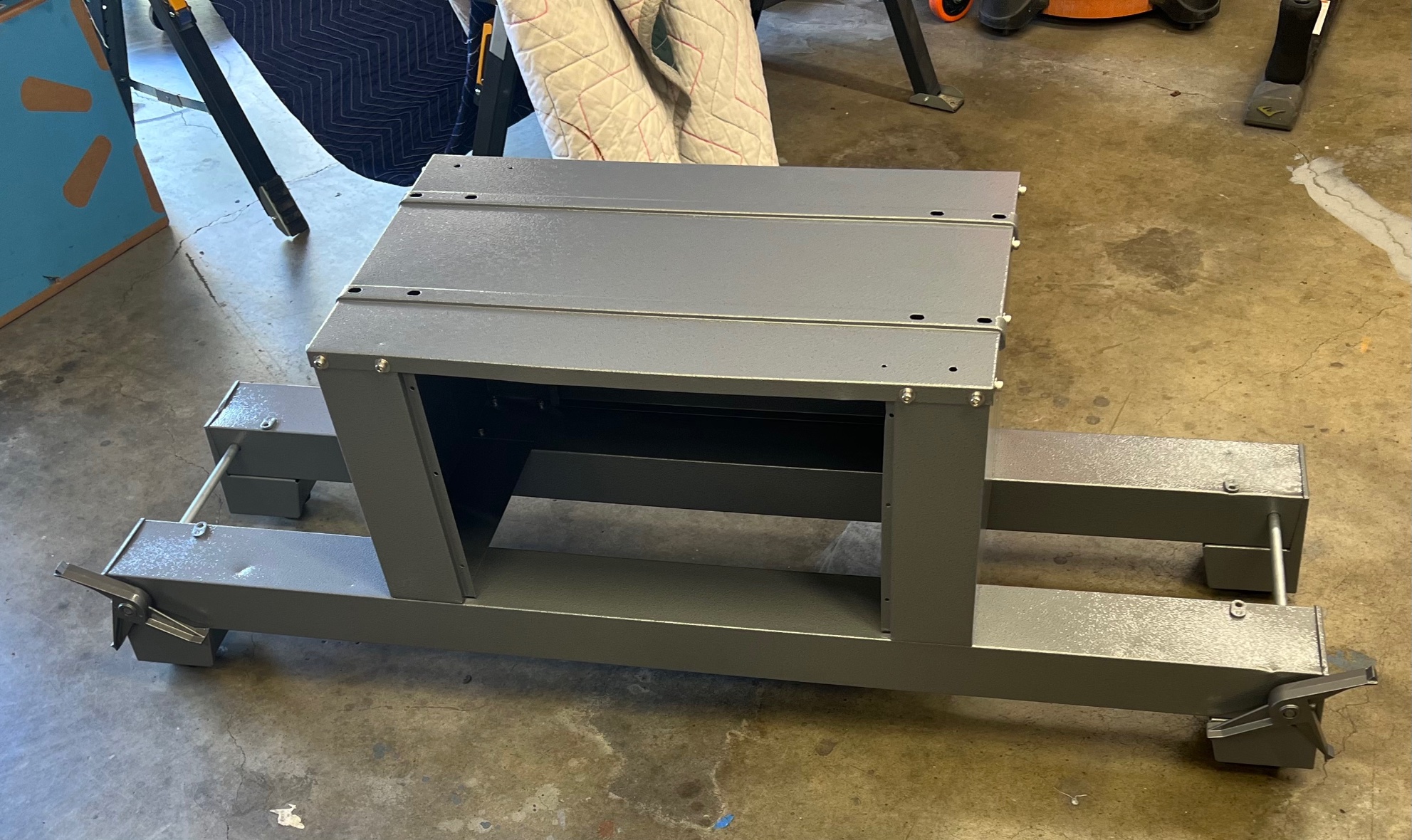

Just an update with some pics- shoe modification complete, it goes up and down (still need to install final resting feet) She goes up and down and rolls all around very smoothly and better than the other (4) SS I have.

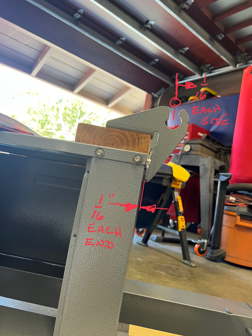

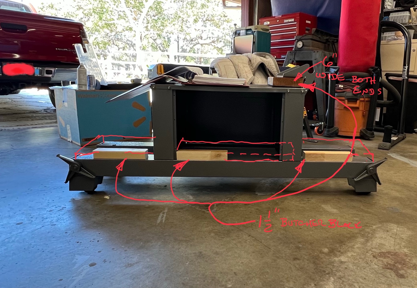

Have some mock-ups for butcher block inside vacuum box and at each end. Will also have pieces under brackets that rod trunnion. This will help my back down the road. I end up pushing the centerline of the seat for the rod trunnion over towards outside about 1/16” each end. I’m not sure if there is enough play to accomplish what I want to do but thought I would put it out there for comment.
Thanks
Thanks
- Wheel mods completed
- F68908EB-5756-4BAF-B6A1-D804754502DE.jpeg (489.91 KiB) Viewed 2650 times
- Rolls like a dream
- A8B240E5-6CF2-4342-AAB6-08DBC912771A.jpeg (757.84 KiB) Viewed 2650 times
- New butcher block mods
- B8C82828-A175-4E6E-B3D1-844FC1737485.jpeg (650.59 KiB) Viewed 2650 times

Nice work Mike, steady progress. FYI, if you just slightly bevel the top of the board under the brackets to have slight inward slope it will rotate the bracket and pull the center of the bracket holes in the 1/16" you're looking for. You actually may be able to achieve this by adjusting how tight the bolt is and slightly deforming/compressing the wood under the bracket.

To say nothing about the sheet metal flexing.
Re: Mark VII a start and a long ways to go..
Thanks Mike and JPG, I’ll do a 2 sided mock-up 2 verify how much play if any. Nothing set in stone but I like the concept. The Mark VII has so much storage potential and the overall design, other than the vacuum, is spectacular. Starting to really like this machine.
