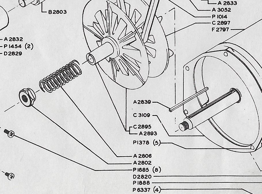

Looks like you found a good solution for the missing nut. The original nut (part A2802) was a special one and did not use a washer. In the parts diagram section shown below is the nut with the hex part only on the outside end of the nut while the inside end is round for the spring to go over. This was the same for both 1954 manuals.
_ .
Your $15 nut plus a washer was probably a lot cheaper than getting an original nut if you could find one.

The picture is really helpful. I could never find an owner's manual going back to when the motor shaft spring was held in with a nut versus a retaining ring and washer. I am pretty sure they went to the retaining ring by 57 or 58 at the latest. I did not realize the original nut was big enough to hold on the spring without a washer. I ran across some pictures that made it look like the nut or retaining ring was on top of a metal shot glass that covered the spring. I have never seen that "cup" for sale on ebay or anywhere else. I suspect it was only done a short production run. My plan is to use a washer with a 1/2" interior diameter. Not ideal or original but it should work. Might put on a dab of locktite although it should not be necessary with the reverse thread.
