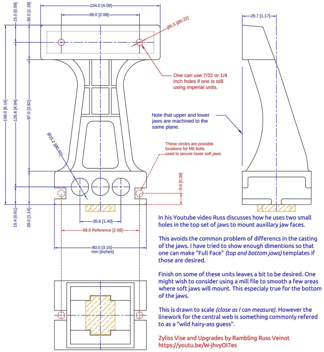

Greetings ... I do not have the funds or space for a Shopsmith. I have to make do with portable power tools and among those are a couple of Zyliss Vices. I saw a Youtube video by Rambling Russ Veinot in which he describes how he attaches auxiliary jaw faces to his Zyliss Vice via a couple holes in the top jaws. I decided to make a Drawing of the jaw section of the vice so that I could produce some jaw faces that cover both the top and bottom jaws. Perhaps this will prove useful to some of you folks. If you want the origonal DWG file then send me a PM. Cheers :)
Zyliss Aluminum Jaw (2D) Option (1280).jpg (183.33 KiB) Viewed 1878 times
