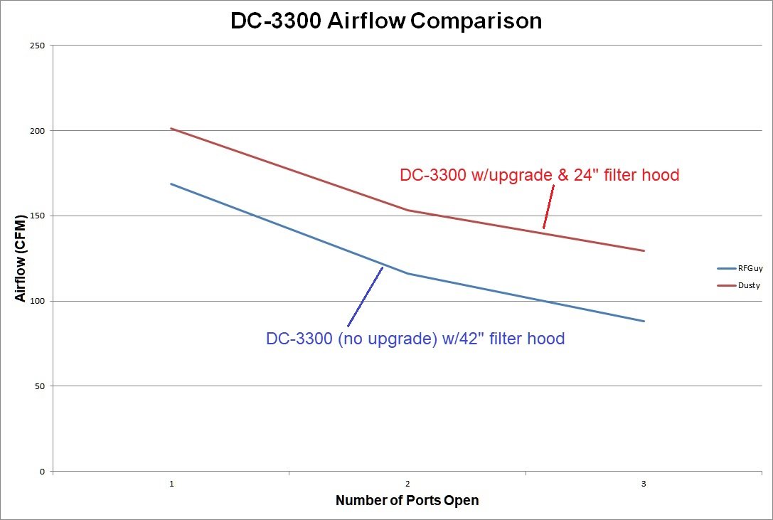

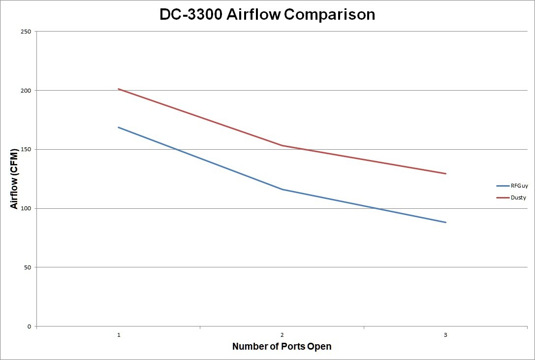

I still think this is an improvement over what I have been seeing with my original DC-3300. I have tabulated the numbers for comparison below. Also corrected the airflow numbers for what I reported before to now calculate it in the 2.5" aperture it was measured in (as the discussion converged to above). I know you didn't give me exact numbers for the 2 and 3 ports open case, but when you get better numbers here I can update what is below. Using this for now, what I see is that when I go from 1 port open to 2 ports open that I see a 31% drop in airflow. Going from 1 port open to 3 ports open, I see a 48% drop in airflow. However, for your upgraded DC-3300, going from 1 port open to 2 ports open results in a 24% drop in airflow. When you go from 1 port open to 3 ports open it drops 36%. That is still a significant improvement in performance over the original DC-3300. IF you can get a better seal again, your numbers may actually go up even more for the 2/3 ports open case. I was expecting a bit better performance out of the DC-3300 upgrade, based on the comments that Jim made about it. However, in your case you may be losing some airflow potentially due to using the 12" filter hood. In any event, I think we have confirmed that the DC-3300 upgrade/DC-6000 is an improvement on the original DC-3300 and that is a good thing. However, those who thought this upgrade performance would be night and day difference from the original are a bit off the mark IMHO. It is an incremental improvement. Intuitively, I think your results and my results make perfect sense. We should expect a drop in airflow/port when more than one port is opened on that 3 port manifold. I don't think we will ever see the same airflow out of the 1 port open case when compared to all 3 ports open on the 3 port manifold. Rather what is important is whether you can get sufficient airflow to not have dust settle out in either a vertical/horizontal duct/hose configuration. In the worst case with 3 ports open you still have almost 4000 fpm which means yours conceivably could provide dust collection to multiple woodworking tools through 2-1/2" hoses without any issues (3000 fpm minimum needed for horizontal runs and 4000 fpm minimum needed for vertical runs). I don't believe this has ever been the case for the original DC-3300 with multiple ports open though. Lastly, thanks for all of your efforts here and for purchasing an anemometer for measuring your DC-3300 upgrade. It is appreciated and very useful information IMHO.
P.S. Just wanted to point out again that the original DC-3300 was spec'ed as a 0.5HP dust collector with a motor that draws 8A and has a 4 blade fan impeller. The DC-3300 upgrade/DC-6000 is listed as a 1.5HP dust collector with a motor that draws 8A and has a new 6 blade fan impeller. I think we can agree that the DC-3300 upgrade motor likely spins no faster than the original DC-3300 motor because both only draw 8A. Likely the key difference with the upgrade is the new and improved fan impeller design, which is why the upgrade is an incremental improvement and not a revolutionary improvement, in my opinion.
AIRSPEED - <measured>
1 port open at a time: (units=ft/min)
RFGuy: 4944 Dusty: 5905*
2 ports open at a time: (units=ft/min)
RFGuy: 3411 Dusty: 4500*
3 ports open at a time: (units=ft/min)
RFGuy: 2584 Dusty: 3800*
AIRFLOW - <calculated>
1 port open at a time: (units=CFM)
RFGuy: 168.5 Dusty: 201.3*
2 ports open at a time: (units=CFM)
RFGuy: 116.3 Dusty: 153.4*
3 ports open at a time: (units=CFM)
RFGuy: 88.1 Dusty: 129.5*
NOTE: * indicates measurement could very well be higher than shown, but this is the best, max reading taken so far

Only one minor and probably inconsequential correction. I don't have a 12" filter. I have the intermediate size (I believe it was marketed as 24") filter

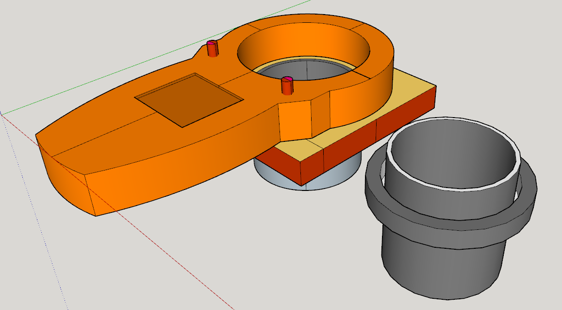

The problem with my kludge connection of the anemometer to the DC was that I could not repeatably achieve a leak free connection; thus unable to get reliable results.
Attached is a pictorial of "the new concept".
Utilize the two holes in the meter to align to the kludge. With the leaks eliminated this is expected to provide repeatability as a result of aligning the aperture the same each and every time.
The face of the kludge will be soft foam pad so that when the meter is pressed against it the leaks will be sealed.
In the pictorial the yellow surface represents the soft foam seal.
anemometer coupler.png (109 KiB) Viewed 5182 times
Attachment is achieved by using a hose coupler between DC and the Anemometer. The kludge doers nothing more than encourage proper alignment and seal.

What you propose looks good, but know that certain types of foam are more porous and can actually let air through in certain directions. Also the fit has to be very tight or glued - otherwise you will still have leaks between the anemometer and the foam and the DC-3300 I believe. I guess my question is what is good enough? I thought what you had already was sufficient for this testing. To truly get an air tight seal, I don't think what you show in the pic above will be sufficient. You would have to actually tape the interface between anemometer and DC-3300. I did this previously using my anemometer testing, but I could get within a few % by just holding my anemometer in the exact right spot and pressing it firmly against the DC-3300 and just logging the max reading I could observe. The anemometer fan housing is a little different on your device so I don't know if it would work better/worse than mine in this regard. IF taping doesn't bother you then you could just use your existing design and tape it really well to the DC-3300 manifold. Then do all measurements through that one port and repeat the 1 port open, 2 ports open, 3 ports open measurements again. Might be an easier option for you before trying to get the foam to fully seal.

Before I get started on the kludge I'll give taping a try.. I have some two sided carpet tape that just might work. I think I may have some flexseal to try.
