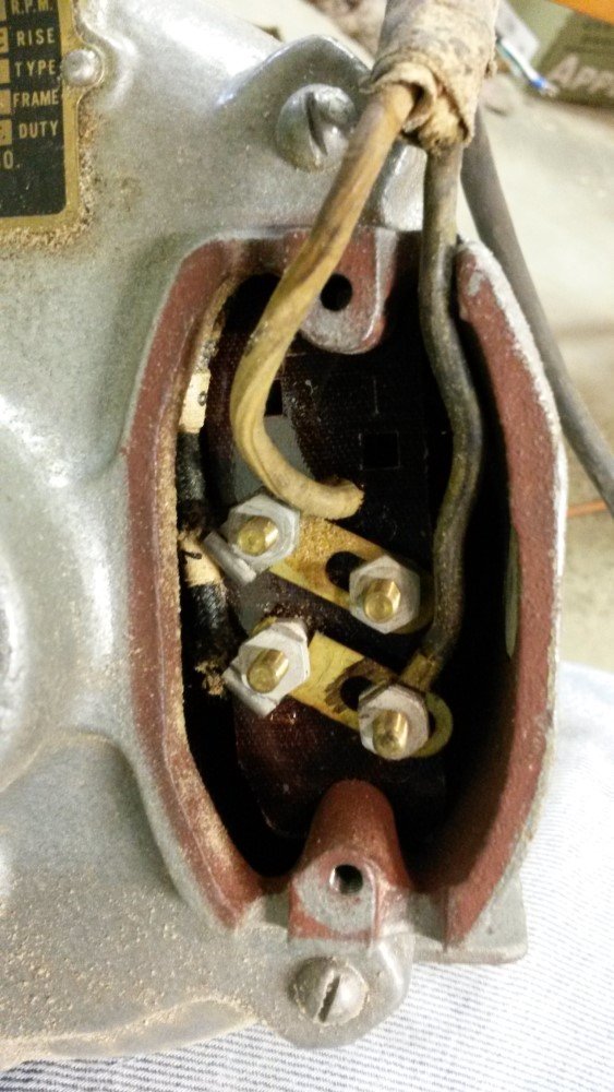

I replace the old wiring and even the switch when restoring Model 10's and add the ground. Depending on the motor some are easier to replace while others are a bit more difficult. Some motors have terminals behind the cover plate so attaching a new power cord is simple. Other motors have the power cord spliced to the wires inside the motor housing. These have to be cut and the new power cord spliced in. As for the ground I usually put a ring terminal on the end and connect it under one of the screws holding the cover plate on. The picture below shows a motor that has the terminals for connecting the power cord to.
