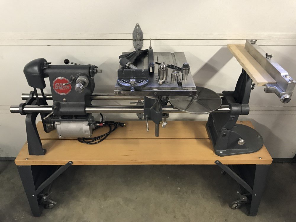

The picture tells me a lot about your new-to-you Model 10E. It was likely made in 1948 but not 1952. It should say Model 10E on the Logo Plate as well as having the serial number.
The motor is the common 1/2 HP motor found on them. I have had a lot of these motors on Model 10E and 10ER Shopsmiths I have restored. None of them were bad although I have replaced bearings in a couple of them. These motors seem to run forever. Clean the dust out and you will want to replace the cord if original.
It appears that this Model 10E was put on that bench at a later time than when purchased as it looks like the 2" x 8' Boards are 57" long instead of 60" long the correct length for earlier Model 10's with the larger Base and 4 bolt Headrest. They probably followed the instructions for mounting a Model 10ER that has the shorter Base and 2 Bolt Headrest. That is the reason the Way Tubes extend so long out the Headrest end. Not having the Retractable Casters, a previous owner has built a wheeled wood base for it to sit on. This can make the Shopsmith sit too high for some operations to be done comfortably. If it works for you great if not you could remove it from the wood base and add the original Retractable Casters or newer options for casters.
I am glad to see you have an Owner's Guide for it although it is a later one for the Model 10ER. Some things will be different in that manual when compared to the parts on your Model 10E. There is an earlier Owner's Guide available as a PDF through this website. Look under the Maintenance and Repair section for Shopsmith Large Format Drawings, Illustrations and More by Everett Davis. This will be one of the first four topics and is linked below. In it you will find a wealth of information on the Shopsmith tools. Some are directly linked there and others are on “My Google Drive” with documents too large to be directly linked. Everett has become the Shopsmith historian by saving and restoring manuals and other documents. On his Google Drive you will find 10E & 10ER which in that file group has a restored copy of a Model 10E Owner's Guide on the top row right side.
viewtopic.php?t=16113
One of the changes that was made to the Model 10's was going from the Wood Extension Table, which you should have based on the Tailstock, to the Metal Extension Table. This will also be one of the differences in a Model 10ER Owner's Guide compared to a Model 10E Owner's Guide for both operations and parts.
The picture below is a Model 10E I restored to give you a reference as to how it looks and the parts they originally came with. These were sold without a bench and the option of with or without a motor.
_
10E 4708.jpg (108.41 KiB) Viewed 6353 times
Like the one above yours has the second version of the Headstock and the later Gauge Collar on the Quill unlike the one above. Already a plus for you. Something to keep in mind if you need parts, some can be replaced individually while others have to be replaced as an assembly. Many of the parts were the same throughout the production of the Model 10's from 1947 through 1953 while others had more than 1 version, like the Headstock which had 7 versions.

The picture in my post above shows a Model 10E I restored likely made in the beginning of 1948. Even at serial number 4708 it already had changes from the first Model 10E's made. Both the Headstock and Tailstock are the second version.
