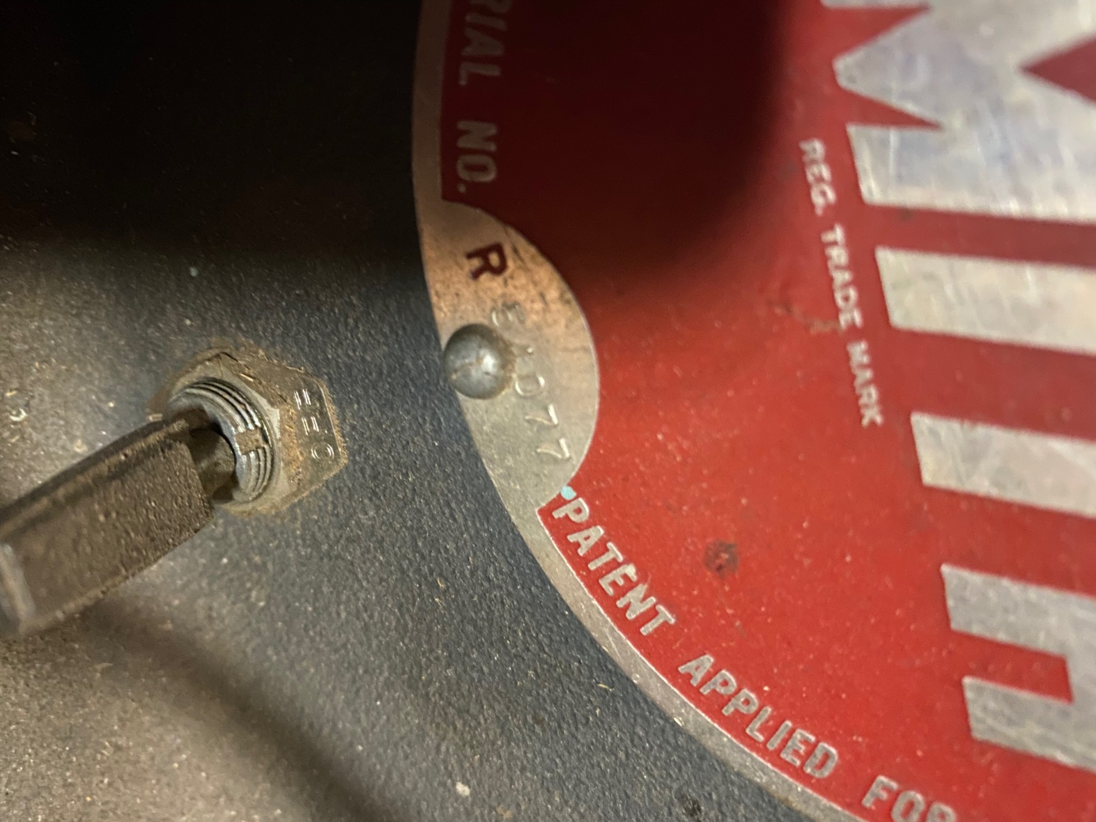

I’m trying to figure out what model I have to get a manual for it and I’m having a hard time reading this.

54077
- Posts: 4189
Re: Identifying
That is a Shopsmith Model 10ER although it says only ER. As improvements/changes were made to the original Shopsmith Model 10E it became the 10ER. Yours with serial number R54077 was made in the Western Plant shortly after the changes made to the Model 10ER in April 1951.

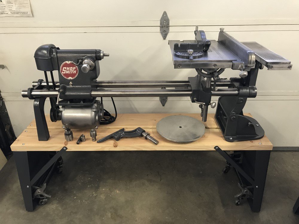

Below is a picture of serial number R55037 that I restored that is close to yours. It is shown with everything that would have come with it when new from the factory plus it is on a bench with Shopsmith Metal Bench Ends and Retractable Casters.
