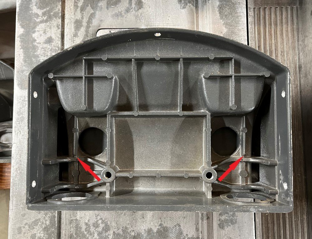

Posts: 4233
Re: Squareness of Way and Bench Tubes
Dusty described in a little bit of detail how he aligns the Bench Tubes to the Base and Headrest. It is the Base end that has the stops for the Bench Tubes. The stops for the Bench Tubes on the Base end can be seen, as indicated by the arrows, in the picture below. The Headrest end must be adjusted for the length and should be set so the Way Tubes with the Way Tie Bar rest correctly.
_
Base and Arm stops.jpg (225.64 KiB) Viewed 3143 times
Setting the Bench Tubes too short in the Headrest and the Way Tubes and Way Tie Bar will not rest correctly on the Headrest and lock in place. Setting the Bench Tubes too long in the Headrest and the Way Tubes and Way Tie Bar will be too long to sit down onto the Headrest and also interfere with mounting Tubes going into the Headrest for the Extension Table or SPT's.
As Dusty said,
If these castings are not square to the tubes it becomes almost impossible to later square the extension tables to one another.
The Headrest must be parallel to the Base and Arm. If they are not parallel the Extension Table will be out of alignment when moved between the Base/Arm end and the Headrest end.
Until recently when Shopsmith changed to only providing the Double Tilt Ends, all Models of the Mark V used the same Base/Arm and Headrest ends. There have been some slight changes to the Base/Arm and Headrest castings over the years including the change around 1960 of the original Bench Tubes being 1-7/8" in diameter as opposed to the current 1-3/4" Diameter Benck Tubes. All Mark V Models be it a 500, 505, 510 or 520 use the same Bench and Headstock. It is the Table/Fence System including the Carriage that makes the difference between the Models. The current Mark V 520s has the Double Tilt Ends as shown on the website.
