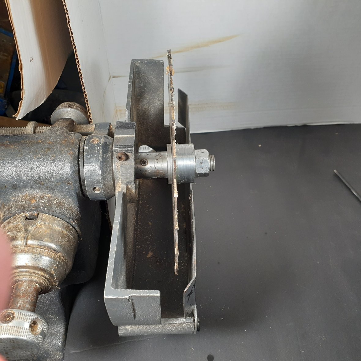

I have the lower saw guard with the 2 1/4" round dust port. The clamp on the dust port that is supposed to mount on the quill stop but ti does not reach when the blade is held in the middle of the guard (photo 1).
Is it possible that I have a different shorter arbor that I'm supposed to use for the table saw blade?
It seems that the guard clamp should be a couple of inches to the left.
saw guard does not reach to quil stop.

Yes thee needs the much shorter saw blade arbor.

Your blade may have a 5/8" hole. Requires a different arbor.

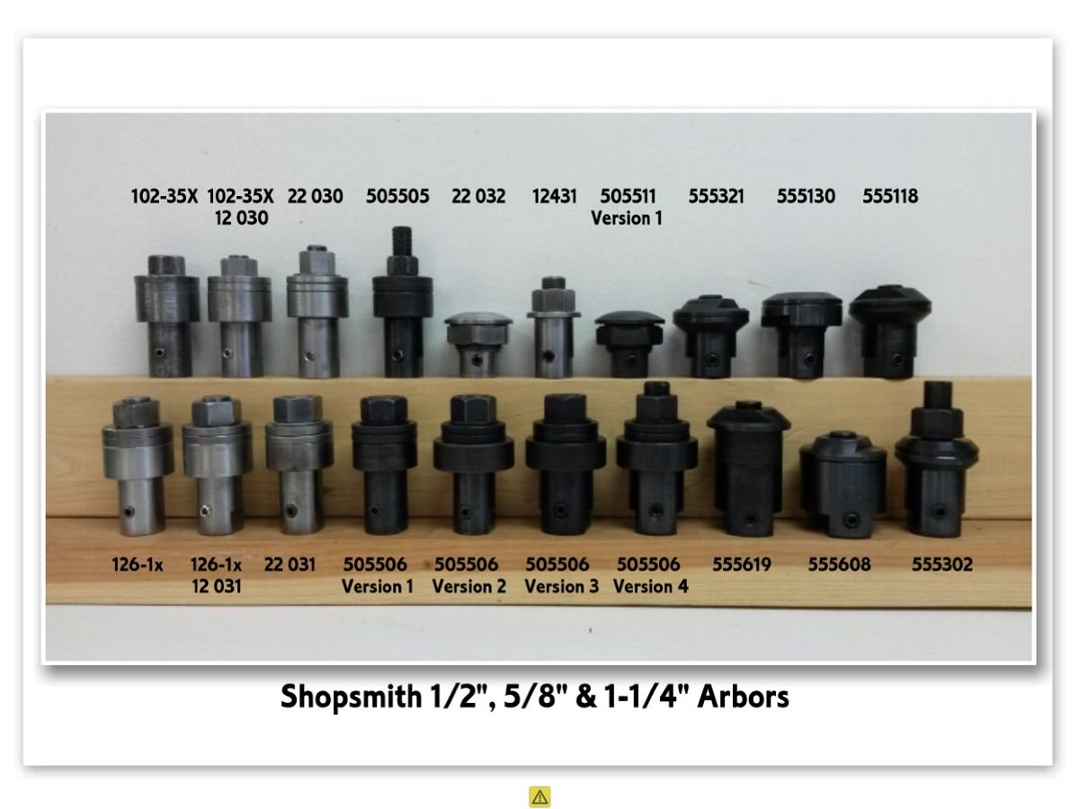

The lower Saw Blade Guard you have (part number 505705) is one that came out in the 1960 and I believe originally with the Mark VII. It will fit on the Mark 5 and is a much better lower guard than was available when your Mark 5 was made. It uses the Upper Saw Blade Guard part number 505627 and that upper guard also pairs with part number 505628 Lower Saw Blade Guard. A picture of that Saw Blade Guard set is below and the bracket is the same to hold the upper guard to your lower guard. Notice the difference in how the lower guard below clamps to the quill compared to yours.

The Arbor you are using, as you already realize, is not the correct one to use for Saw Blades with the Saw Blade Guards in place. Since the Saw Blade you are using has a 5/8" arbor hole you need the 5/8" Arbor part number 555321 and if using a Shopsmith Saw Blade with the 1-1/4" arbor hole you would need 505511 (or 22 032 the same arbor pre-1964). There are similar arbors to these (555130, 555118 & 555608) but are longer and for the 510/505, 520, Mark 7 & 4 Table systems not the original or 500 table system yours should have. The two arbors you need to use can be seen in the picture below which shows most of the Arbors made for the Shopsmith tools over the years. I chose this picture so you could compare the different arbors.
_
Arbors Labeled - inc.jpg (101.71 KiB) Viewed 8820 times
The arbor you have can be seen in the picture above and is part number 22 031. That arbor simply cannot work with that lower guard.

You are using the 5/8" universal arbor. Change the order of the washers and blade on the arbor to move the blade closer to the headstock. :)
ie, from left to right. arbor, thin washer, blade, thick washer, tongue washer nut.
You likely don't need the second thin washer for this application. The universal arbors came with one thick and two thin washers, but usually only two were used depending on what was being mounted. so 1 thick and 1 thin, or 2 thin for wider things like dado stacks, grinding wheels,etc.
