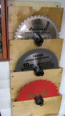

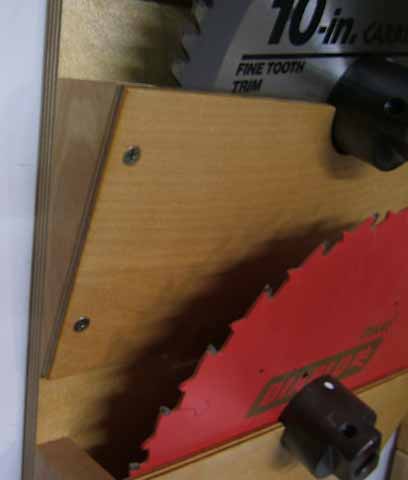

Blade Holder and Dial Indicator
Attached are pictures of my saw blade holder with some blades mounted on their arbors that have been set to maximize their sweet spot.
The saw blade holder is made from Baltic birch plywood and maple, the back is 1/2" thick, the inside of the slots are 10&1/8" wide, there is 1&1/4" above each wedge. The wedges on the sides are 5" high 1&5/8" wide at top and 1/8" wide at the bottom. The fronts are 1/4" Baltic Burch the circles were drilled with a Forstner bit before cutting them apart.
[ATTACH]143[/ATTACH] [ATTACH]142[/ATTACH]
