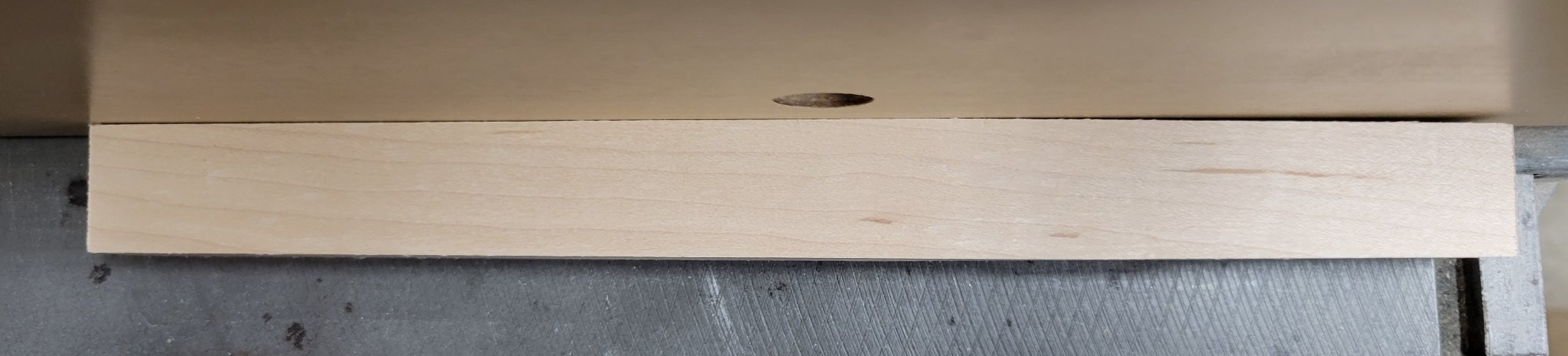

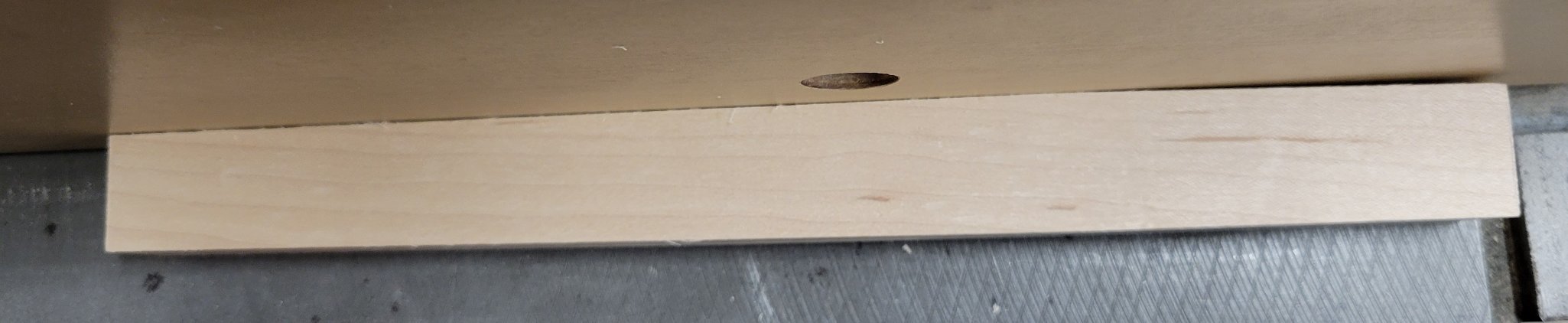

Geesh - I've had this problem ever since I can remember. The front of the board gets thinner and thinner with each pass but the end never seems to get jointed. So I end up with a wedgy looking board. I have to think it's my technique. Hopefully these 2 pix show the problem, Before jointing, I took the board and put it on its flat face down on the infeed table and the edge to be jointed against the fence. You can see the gap at athe back edge. The 2nd picture shows the widening gap at the trailing edge after a couple of passes.
From all I've read I think I'm doing it right. Start the board with downward pressure on the infeed side, but after it passes over the cutter, transfer downward pressure to the outfeed side.

- edge against the fence before jointing shows narrow gap at the trailing section

- after jointing a couple of passes, the edge placed against the fence as a straightedge shows widening gap on trailing section

If your outfeed table is not as high as the cut then when you transfer to downward pressure on the outfeed table you will be lifting up the board on the infeed side and it doesn't cut as deep. The joiner blades have to be set just slightly higher than the outfeed table to allow the wood to rebound a little. If they are set too high you'll get the effect you describe. Even when adjusted correctly you have to keep the wood parallel to the infeed table until you've cut enough out of it to hold down flat on the outfeed table.

Solved - Blade height was fine when I checked. Turns out I was just transferring pressure way too soon to the outfeed side.
