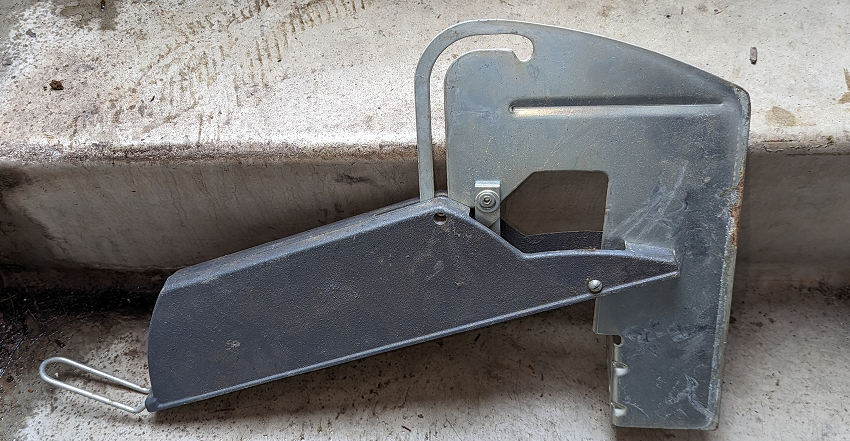

Not sure which guards you have but I think I have versions that should fit your machine. Below is a pic of the upper guard. I think I have the lower guard it came with and another one that will work. PM me if you want to do something. You can have the parts for the cost of shipping.
upper guard.png (753.4 KiB) Viewed 567 times
