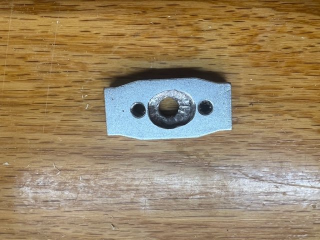

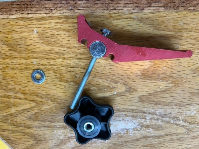

The T-Nuts that I had ordered last week arrived this evening, and I was eager to try them out. The first thing I wanted was use a set on main table miter slot to hold a pair of Incra clamps. I had replaced the 1/4-20 bolt that came with the clamp for a toilet bowl bolt with the same thread.
I was dismayed to learn that there wasn't enough clearance under the T-Nut to allow it to enter the miter slot (or the slots on the fence) with that bolt head sticking out.
Since I had ordered 8 of them, I figured I could sacrifice two of them to see if I could get it to work. I drilled out recesses in the bottom of two of them to allow the toilet bowl nut to sit recessed in the T-Nut.
This will allow me to use the clamps on the table to secure a workpiece while horizontal boring. This and a new set of brad point bits should increase my accuracy.
Has anyone out there done something like this, or is there a much easier way which I overlooked.

Possibly Loctite a piece of threaded rod into the T-nut?

I use a piece of threaded rod in the T-nut, with a jam nut on top of the T-nut to lock it in place. I use the Inca clamps as well, and the jam nut doesn’t interfere with them. But I use the smaller 1/4”-20 holes for this, so I’m not sure if a jam nut above the larger center hole would restrict the clamp position.

I tried this today with another T-Nut. Should work out. I had figured the 1/4-20 threaded rod (in my case the toilet bolt) needed to "float" but I guess I was wrong on that.
