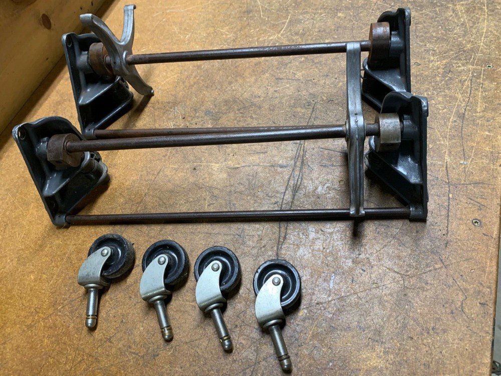

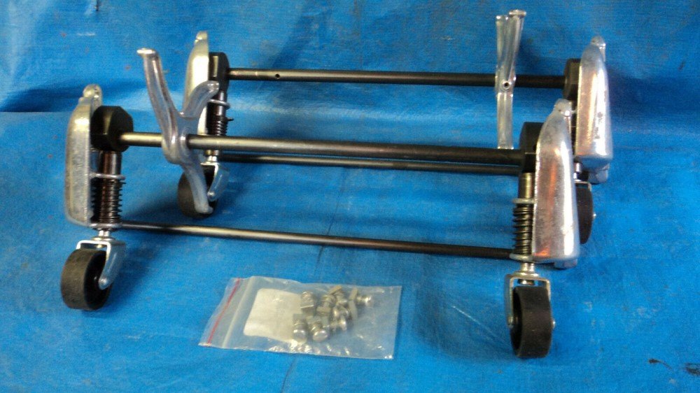

Re: Shopsmith caster wheel evolution
JPG has listed all but one Retractable Caster version that I know of. There was a shorter (front to back of the bench) by about an inch set made for the Mark 2. Other than being shorter it is the same as the Mark 5 Retractable Caster set. The more recent and important change, I feel, is the one JPG listed as quoted below.
Then the Mark 5/V version which has two versions differing in the position of the foot pedal. Initially it was closer to the end.
The earlier Retractable Caster sets (shown below) made from the beginning of the Mark 5 in 1954 had the Foot Pedal closer to the end which interferes with the 3" caster upgrade.
_
Retractable Casters - Mark 5.jpg (222.75 KiB) Viewed 740 times
Below is the later Retractable Caster set for the Mark 5/V's, Mark 7 and Mark 4. Notice the placement of the Foot Pedal.
_
Retractable Casters - Mark V.jpg (116.91 KiB) Viewed 740 times
