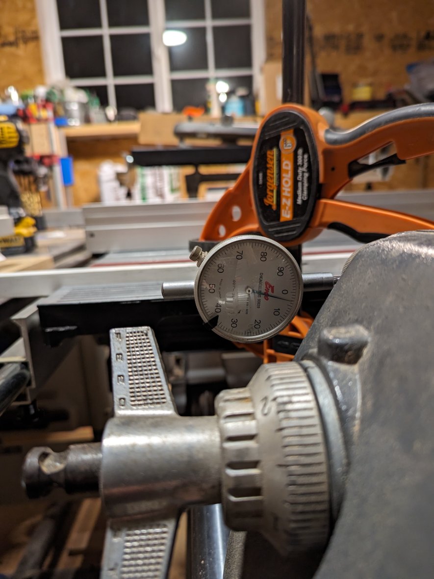

How much is considered excess runout? I measure 6 thousandths at the spindle tip, only 3 right up snug to the collar. But then there's an additional 2-3 thousandths left/right if I push the spindle tip with my finger. That translates to a fair bit when drilling.... wasn't too bad with forstner bits, but a longer typical bit went a little sideways when attempting to create a slot in a metal bracket.
Photo is the max runout I get by turning the lower aux shaft by hand when measured up snug to the stop collar. Again, I can push left/right and make it worse.
The reason I ask is because I was about to use a saw blade to align the main table against. (Blade warp is another issue I found).

In a YT video Tom at Woodshop Nerdery measured a bad 'near new' two bearing quill at about 0.003" runout and two good ones of different types at less than 0.001". (https://www.youtube.com/watch?v=HEFFYw29yV4&t=0s) My own single bearing quill experience is limited to the older Greenie/Gilmer type which is different enough to not be meaningful here. The SS repair guy that is selling rebuilt single bearing quills with new Drive and Ring assemblies as an improvement falls a little short in my mind by not stating runout. Personally, I like the precision of the two bearing quills.

I use two alignment jigs for the main table. At one time SS was providing longer jigs, if you have that kind only one is needed.
Edit: Sorry, I might have added some confusion here as I confused this with another recent thread on single Vs. two bearing quills. It is not clear to me which quill type the OP of THIS thread has. That's the first step in determining runout expectations. Which for me is <0.001" on a two bearing quill only.

I'm assuming the quill is the single bearing style. My SN falls in the '82 range. On the other hand, the belts look pretty new to me; the original owner could have done an upgrade. Is there an easy way to verify without removing the quill? How does one determine whether bearings vs the sleeve is causing runout? (I've never been able to tell if wheel bearings were bad by sound/feel until they got really BAD).

I don't know an easy way to verify quill type without removing the quill, but fortunately that's pretty easy to do and should be done occasionally to wax the outside of the barrel and inside of the headstock bore anyway. Free play of the spindle inside the quill would indicate a probable bearing issue, in/out, left/right, up/down. Rotational free play between the quill spindle and the upper accessory spindle would likely point to a worn Drive and Ring, the plastic part that couples the splines of the Drive Sleeve to those on the quill spindle, especially presuming a one-piece spindle. (Some two-bearing quills have a two piece spindle.)CreekWood wrote: Wed Jul 19, 2023 1:12 pm David,
IIWM I would replace both the bearing and Drive and Ring to minimize runout if it's a single bearing quill. I don't know how good these get, no experience with this version, but it's presumably better than a Gilmer version due to the existence of the replaceable Drive and Ring.(?) I don't know if your readings should be considered unacceptable for a single bearing quill.
IMO a worn Drive and Ring has little to no influence on runout (etc.) on a two bearing quill. It is not supporting/controlling one end of the spindle like it does on a single bearing quill.
A bent spindle is another possible cause of runout. It is more common on two bearing quills.
