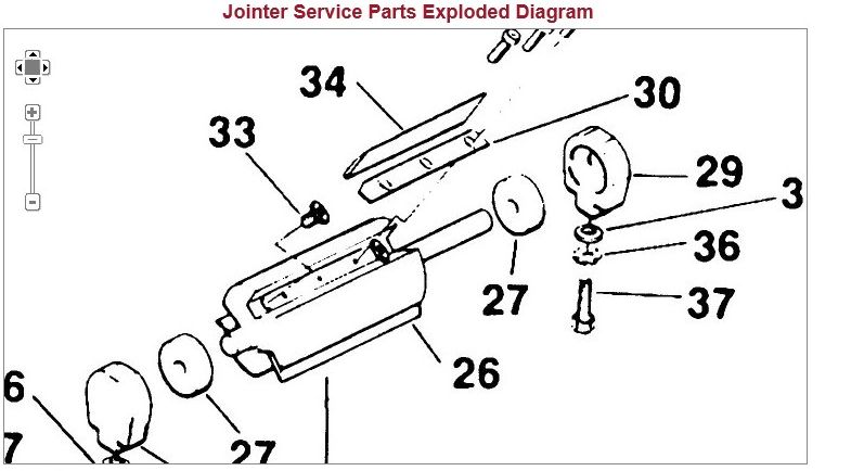

I cannot remove one of the jointer knives from my 505681-B. The 3 wedge locking screws came out fine, but both leveling screws are absolutely frozen. I've tried heat, penetrating oil, tapping, and in desperation drilled through one of them trying to use a screw extractor, but all to no avail. Called Shopsmith, the tech I spoke with couldn't even find the leveling screws on the exploded parts diagram. So I guess I'll try to remove the cutter head and work on it disassembled. Couldn't find any help on tearing it down and how to remove cutter head on the web. Any help on teardown and knife removal would be appreciated. Thanks.

Re: Jointer Knife Removal and Teardown
#33
You do not want to know the $$$
It is not a typical screw.
Thanks to all who replied. Once I got the cutter head out, I was able to pry the wedge loose with a small screwdriver and the knife came out without further hassle. The leveling screws then came right out, they must have been jammed tight against the bottom of the knife. I've already ordered replacement leveling screws from SS to replace the ones I drilled through. As you can imagine, they are bargain priced.
