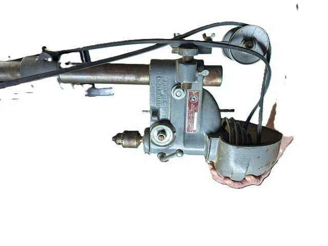

Coming soon, the drill press. I have to take new pictures, the ones I have are too dark to make out any detail and I'm busy drying out the basement today after a shocking morning deluge.
Some time later:
And here they are! And there's an interesting new feature in MS Paint too.

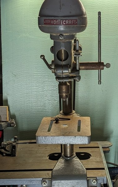

Here's the drill press in upright position. It's attached to a hinge that is bolted to the right side of the main table.
This pic shows it being tilted over with my son holding up the head. The long belts have to be detached from the main spindle first. The drill press head is held on to the top of the post using 2 bolts in slots allowing the head to move up and down to adjust belt tension in conjunction with the saw blade height control. You can see those bolts in the next picture where they at the bottom of the post in it's upside down storage position.
Here's the assembly in the down position. The drill press table has to be the right height on the post and swung to the left side so it doesn't hit the cabinet or the tilt control mechanism. There are stand-alone versions of this drill press that had the motor attached at the top like most drill presses do. Sometimes people think long belts are unreliable and inefficient but they are used in all sorts of machinery without high failure rates. They do cost more and create a hazard in this use where they are totally exposed.
