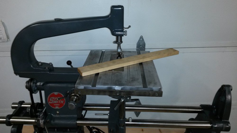

Hopefully you received Owner's Guides for both the Shopsmith Model 10ER and the Jig Saw. If not, Brenda gave information on how to get to Everett's restored Shopsmith documents he has made available to us. Under 10E & 10ER you will find a restored Owner's Guide for the 10ER. Do know that because of changes made to the Shopsmith Model 10E & 10ER during their production from 1947 trough 1953 there were many changes made to them. If you need the manual for the Jig Saw a PDF of it is below.
_ .
This Jig Saw Owner's Guide is for the early one that is pictured above. The only differences between the early version and later version of the Model A-34 Jig Saw Is the Lower Frame Assembly, Drive Housing Cover and the number of screws that hold the cover on the lower frame.
The Jig Saw and Scroll Saw are often considered the same or very similar. They both do similar work but have a number of differences. One is the Jig Saw can have its upper frame removed and be used as a saber saw. A unique feature the Scroll Saw cannot do.
I encourage you to read the Owner's Guides and become familiar with these tools and what they can do, how to properly & safely use them and how to service & maintain them. If you have any questions about them please feel free to ask. Adding pictures can help when asking questions. You may have to down-size (reduce pixels) to be able to post picture here. Even phone cameras take pictures with a higher resolution (pixel count) than can be posted.
They both have their uses in the shop. I have Magna/Shopsmith Bandsaws and Jig Saws which I use both. Since you got the Jig Saw with the Model 10ER I am guessing it is one of the Model A-34 Jig Saws meant to mount on top of the Headstock and use the Model 10ER Table. The early version of the A-34 Jointer is shown below on a Model 10ER.Between the two I would absolutely choose the band saw over the jig saw. However, the jig saw has uses and if I had both (I do) I would keep them both.
